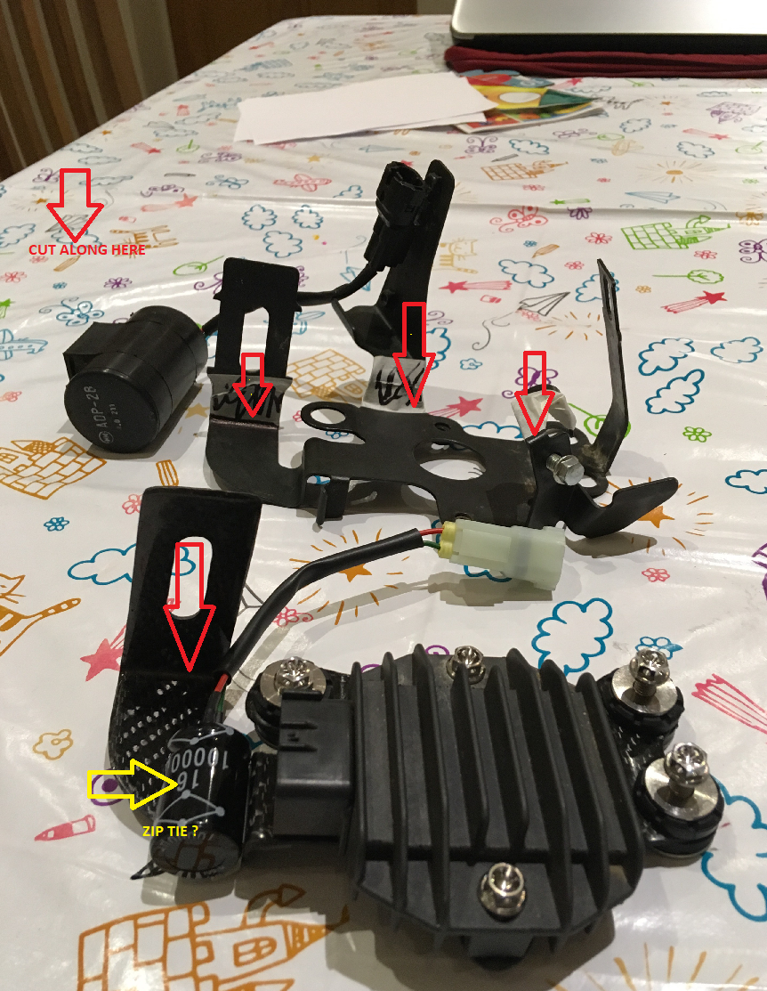

mat Posted January 29, 2018 Report Share Posted January 29, 2018 (edited) Hello, Has any one fitted a lightweight capacitor and / or a carbon rectifier base. Is the new smaller capacitor just zip tied on? Is it good practice to heat shrink or rubber mount the capacitor in some way or will it survive as is - current size is 22 mm x 31 mm ? Not convinced with the carbon bracket and am thinking of modding the existing metal bracket to suit so the fan regulator mount and rear brake reservoir remain and smaller capacitor fits in a similar way on the mock up ??. Any help or pics to show what others have done please ? Edited January 30, 2018 by mat Quote Link to comment Share on other sites More sharing options...

mat Posted January 30, 2018 Author Report Share Posted January 30, 2018 Hello Chatlie44, To my untrained eye on the carbon version I either need to reshape the existing capacitor tang to site the fan relay or cut it off as it is redundant with the new smaller capacitor ? Either way i still need to fabricate a bracket for the rear brake reservoir and maybe the fan relay unless I just tuck it away. I am know thinking that a lightened (drilled) and adapted powder coated factory bracket that cleans the are up is a smarter option ? Any thoughts ? Quote Link to comment Share on other sites More sharing options...
jimmyl Posted January 30, 2018 Report Share Posted January 30, 2018 Doesn't the fan relay fit behind head stock if you dump the plastic catch tank? Quote Link to comment Share on other sites More sharing options...
mat Posted January 30, 2018 Author Report Share Posted January 30, 2018 Hi Jimmyl, I did think that but read the below and think now think around the original position is the better option ? "Removing the fan relay mounting tang and Bank Angle sensor and mount leaves a lot more room for the main wiring connectors behind the cylinder. They tuck in much better under the throttle body in the large plastic sock. This leaves plenty of room for the fan relay to be sited between the main connector sock and the capacitor. Thus the relay moves inboard with much shorter wires. (There were two separate power wires running through the loom to the headstock and then back in the separate sleeve to the relay, but on unwrapping the loom the two wires were tee’d together nearer to the supply point.) I now have one much shorter wire running direct to the relay and tee’d just before the relay. The blue/black also now runs direct to the relay instead of up and back." Quote Link to comment Share on other sites More sharing options...

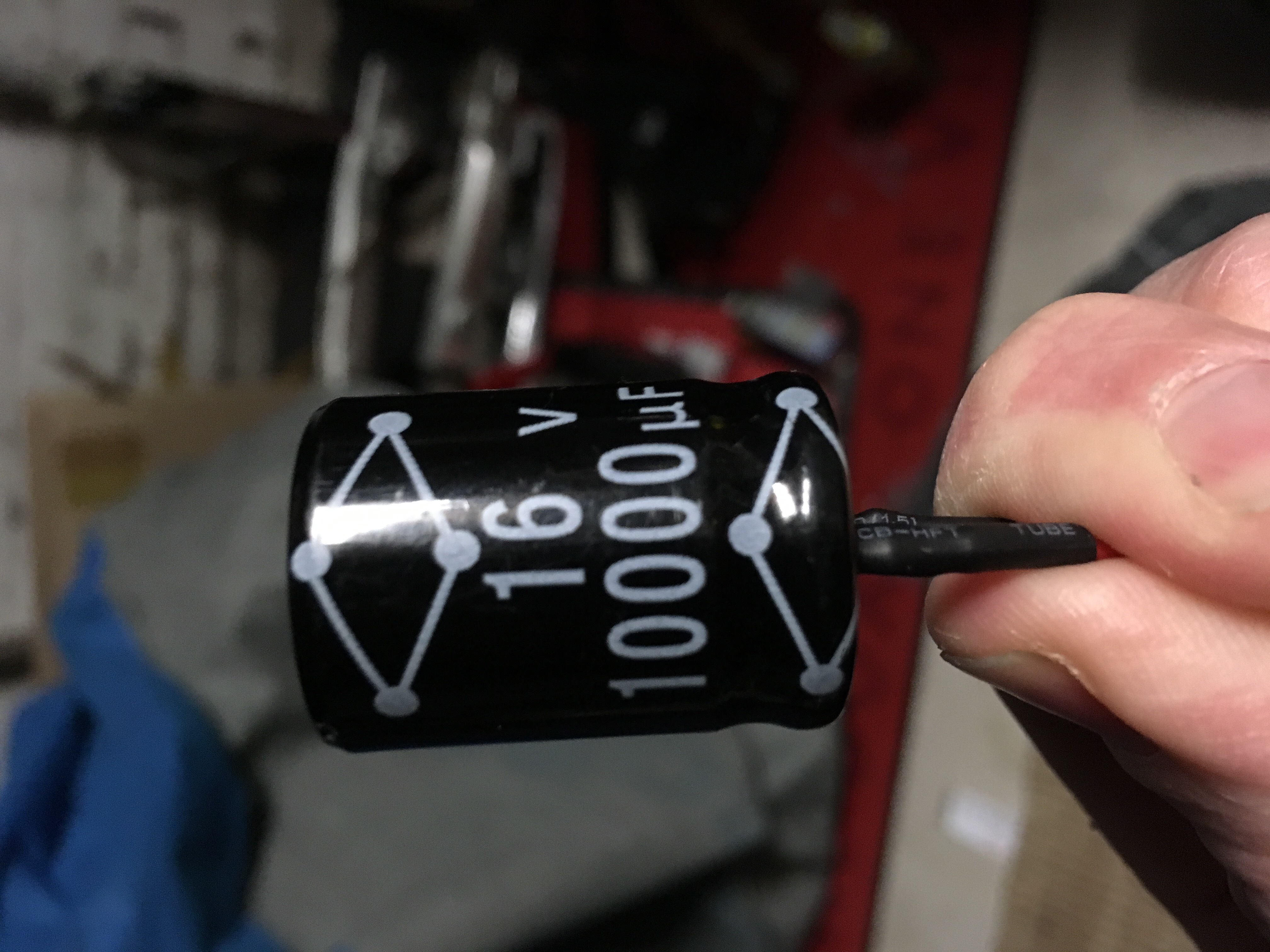

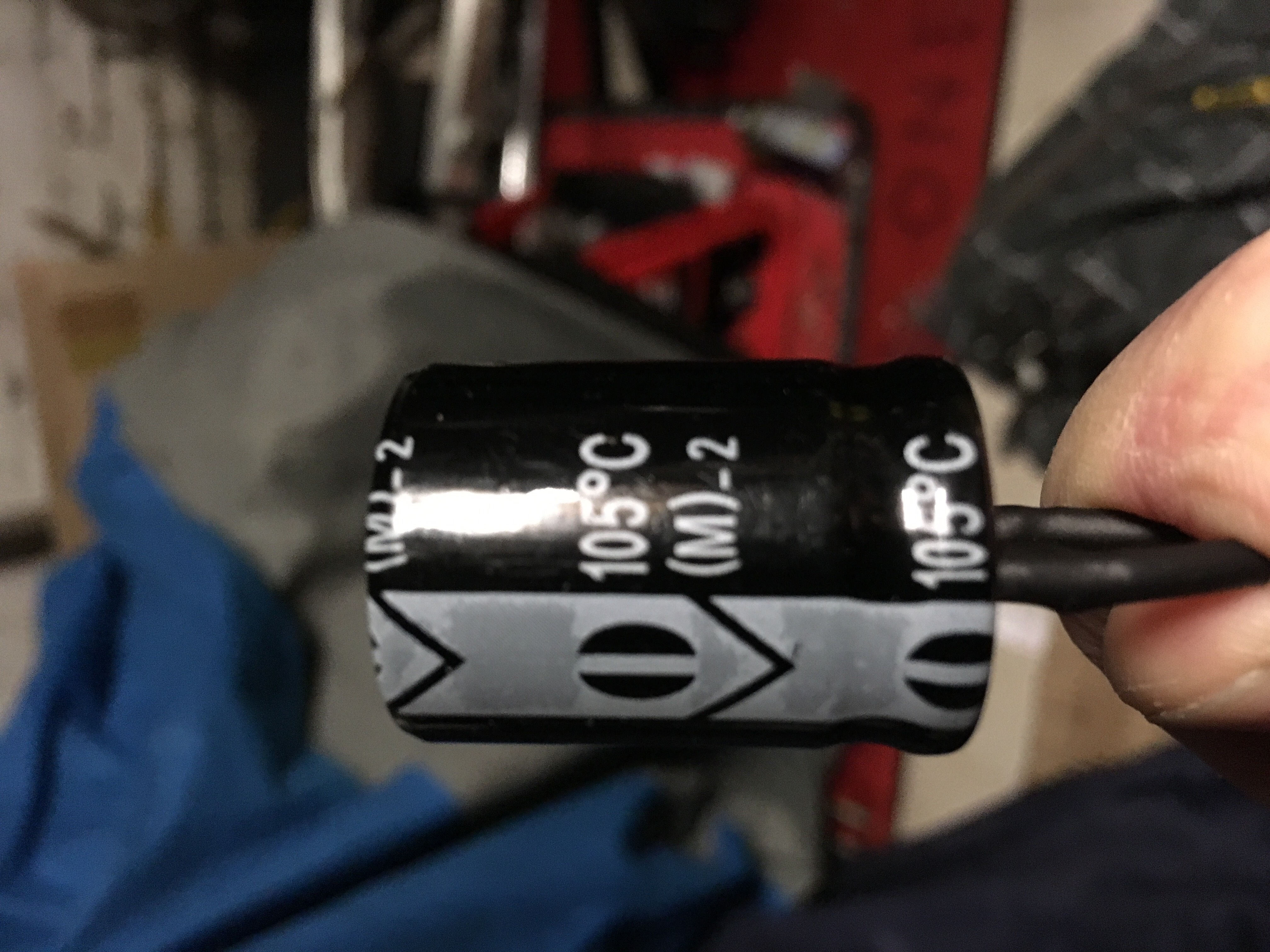

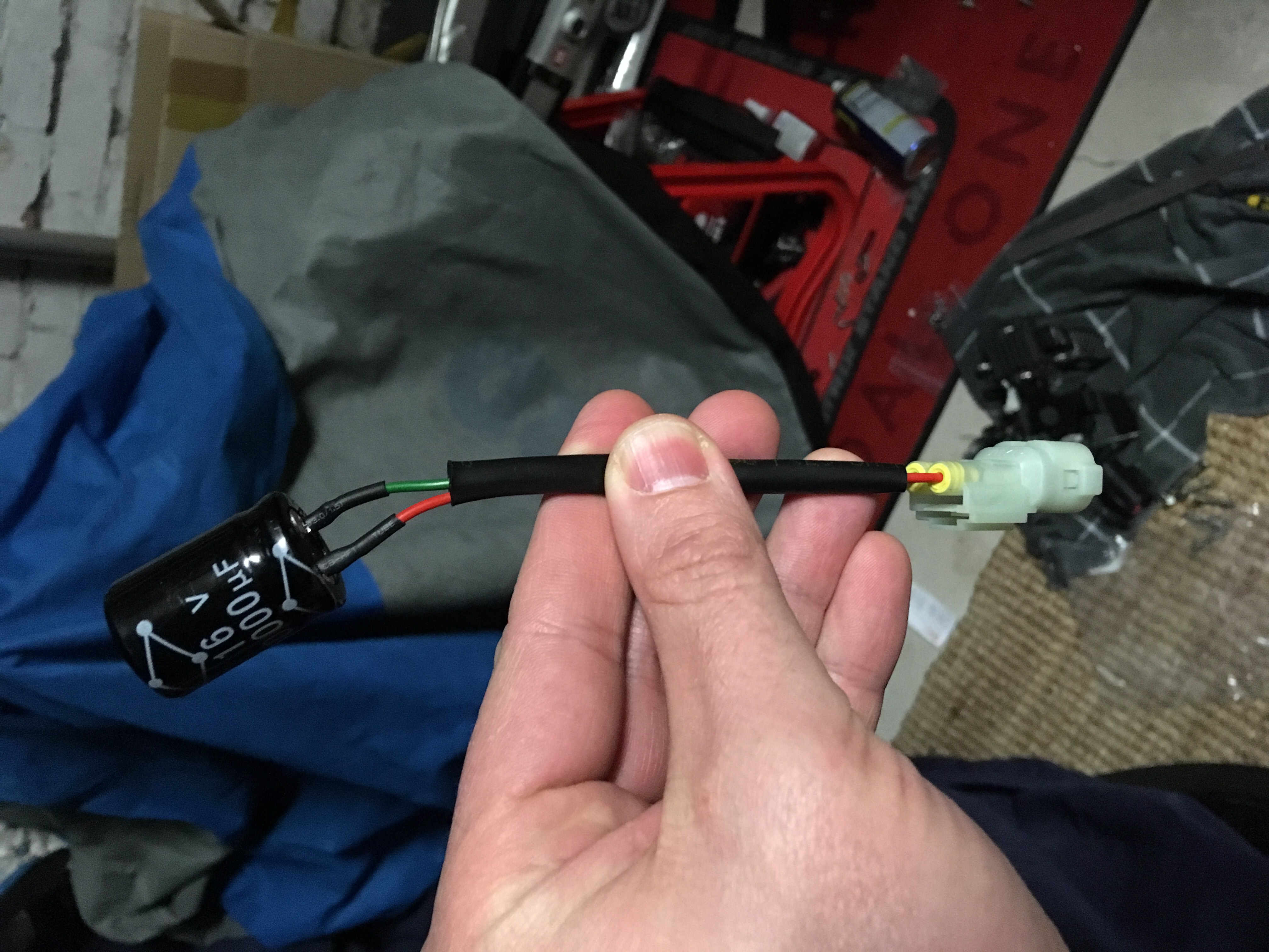

ymirtrials Posted February 1, 2018 Report Share Posted February 1, 2018 Who makes this aftermarket capacitor in the photo? Are you switching only for a weight reduction? Quote Link to comment Share on other sites More sharing options...
mat Posted February 1, 2018 Author Report Share Posted February 1, 2018 Hello Ymirtrails, The capacitor was from Future Trails - Based in Italy but it a sum of all its parts so will takes some pics of the capacitor for you and you could build one quite easily. Best, Mat Quote Link to comment Share on other sites More sharing options...

mat Posted July 1, 2019 Author Report Share Posted July 1, 2019 Hi Johnny, In the end I trimmed up the original bracket - drilled it a little and powder coated it black, mounted with for ever shiny ti bolts - currently using original capacitor - next time i service i will mount the smaller capacitor on the original bracket in the original position with zip ties and a rubber pad. Looks a little neater. I will take a photo if of interest. Thanks, Mat 1 Quote Link to comment Share on other sites More sharing options...

Johnny Reggie Posted July 1, 2019 Report Share Posted July 1, 2019 Thanks Mat, this morning I fitted the Future Trial bracket and light weight capacitor. I moved the chunky old relay up under the headstock, cable tied the small capacitor to the upright on the bracket and used a cable tie to keep the brake reservoir upright (in effect the reservoir is suspended from the frame cross member under the seat area. Whilst I didn't like the idea of cable ties actually it worked out fine. Once removed the bracket and capacitor are pretty heavy items! As Konrad says cheap capacitors can be unreliable - I have heard this said. I went for the Future trial capacitor - I figured the Italian guys have always been strong on auto electrics ? Let see how we go! Cheers, Reggie Quote Link to comment Share on other sites More sharing options...
