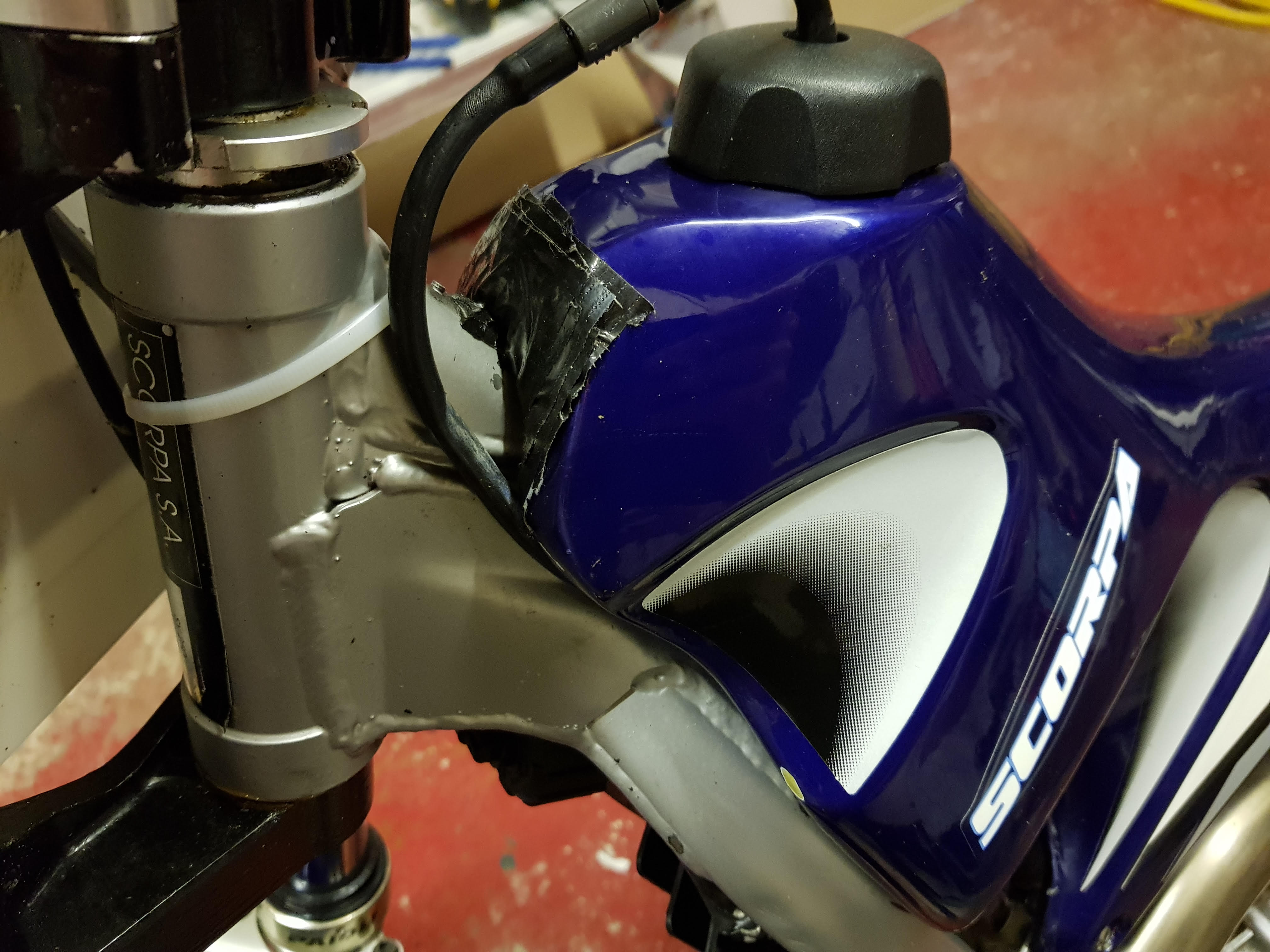

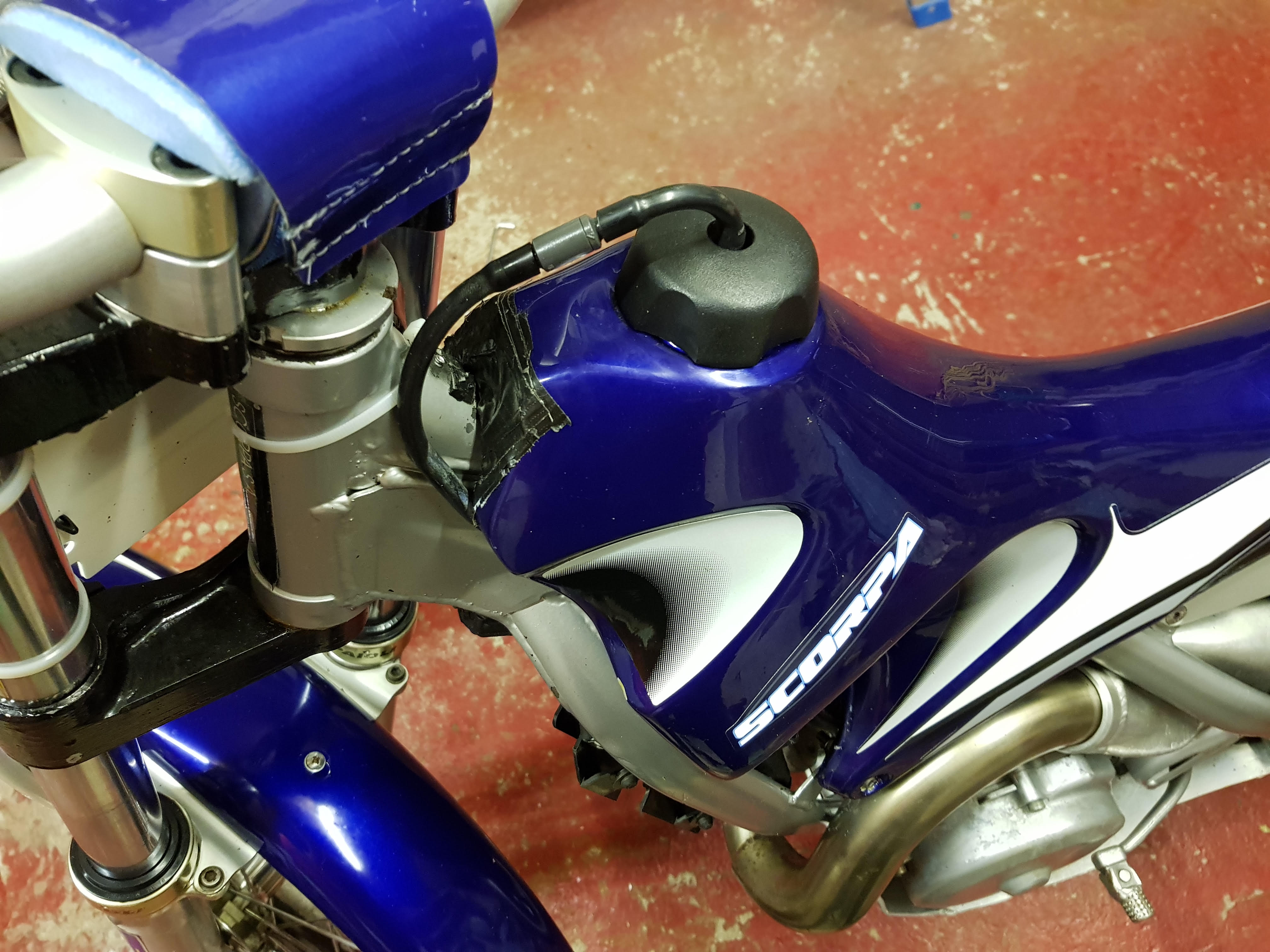

Sparta Posted January 29, 2018 Report Share Posted January 29, 2018 (edited) Hello, finally got my first bike scorpa sy250 long ride, but after filling full tank realized that it has a crack. It is at very top where tank overlaps the frame, about 2cm. was googling ways of fixing this and found that plastic melting / welding is weakening the tank and best way is to use proper repair kit.. So after research for repair kits I am lost:D almost every repair kit has some bad reviews- didn't work / came off after 15 min etc.. Wondering if someone here is familiar with these plastic tank repair kits and would recommend me a decent one? Also, because of location of that hole is where tank is lying against metal frame, thinking of making some padding of silicone or something, so it's softer.. Thanks Edited January 29, 2018 by Sparta Quote Link to comment Share on other sites More sharing options...
Sparta Posted January 29, 2018 Author Report Share Posted January 29, 2018 (edited) Added couple pictures, duck taped it at the moment. Crack starts on that bend where tank sits on frame.. Aluminum solution is too difficult for me I think:( Any other suggestions how to fix it easier?:) Edit: just found a guy who does plastic welding Edited January 29, 2018 by Sparta Quote Link to comment Share on other sites More sharing options...

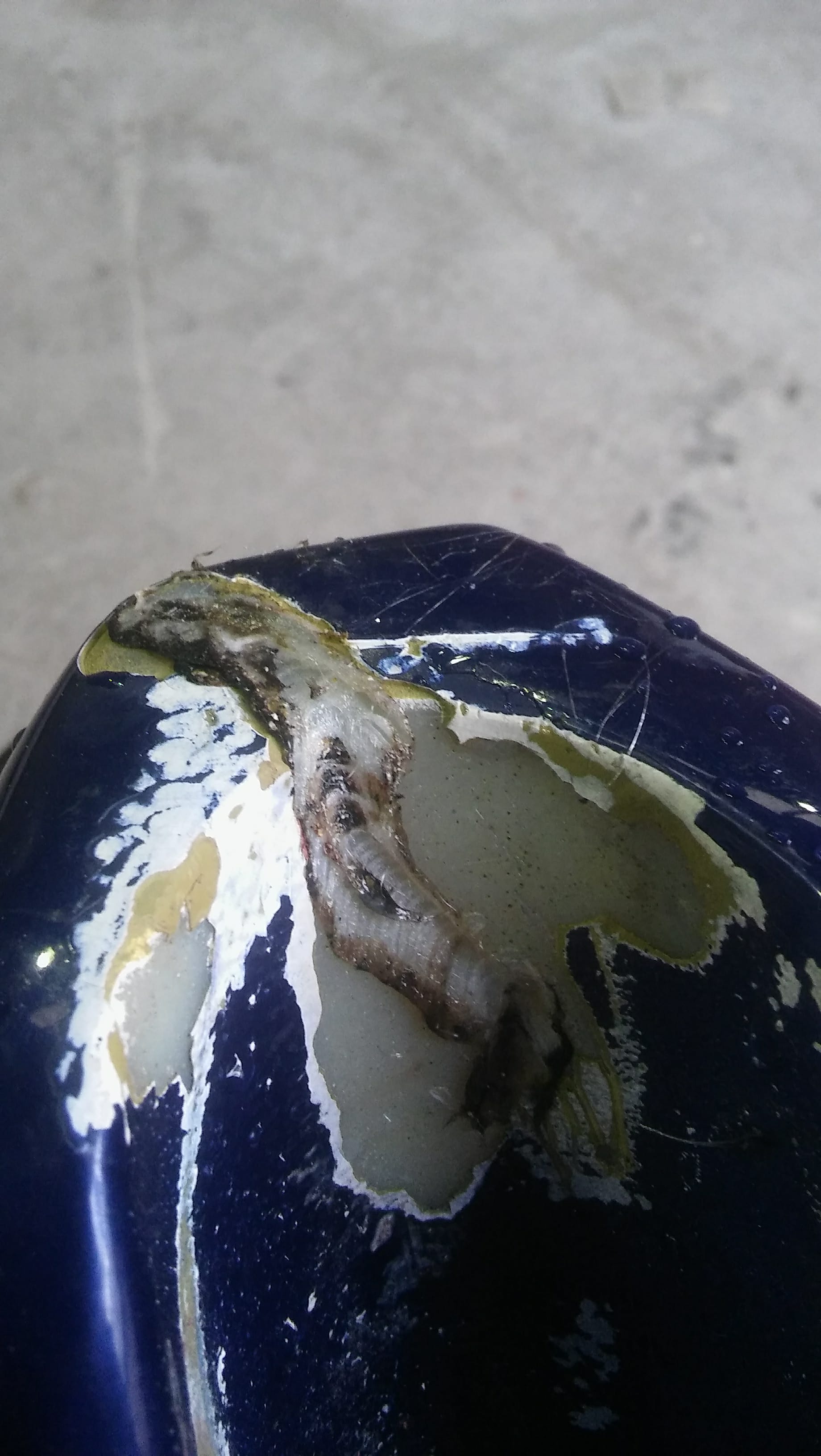

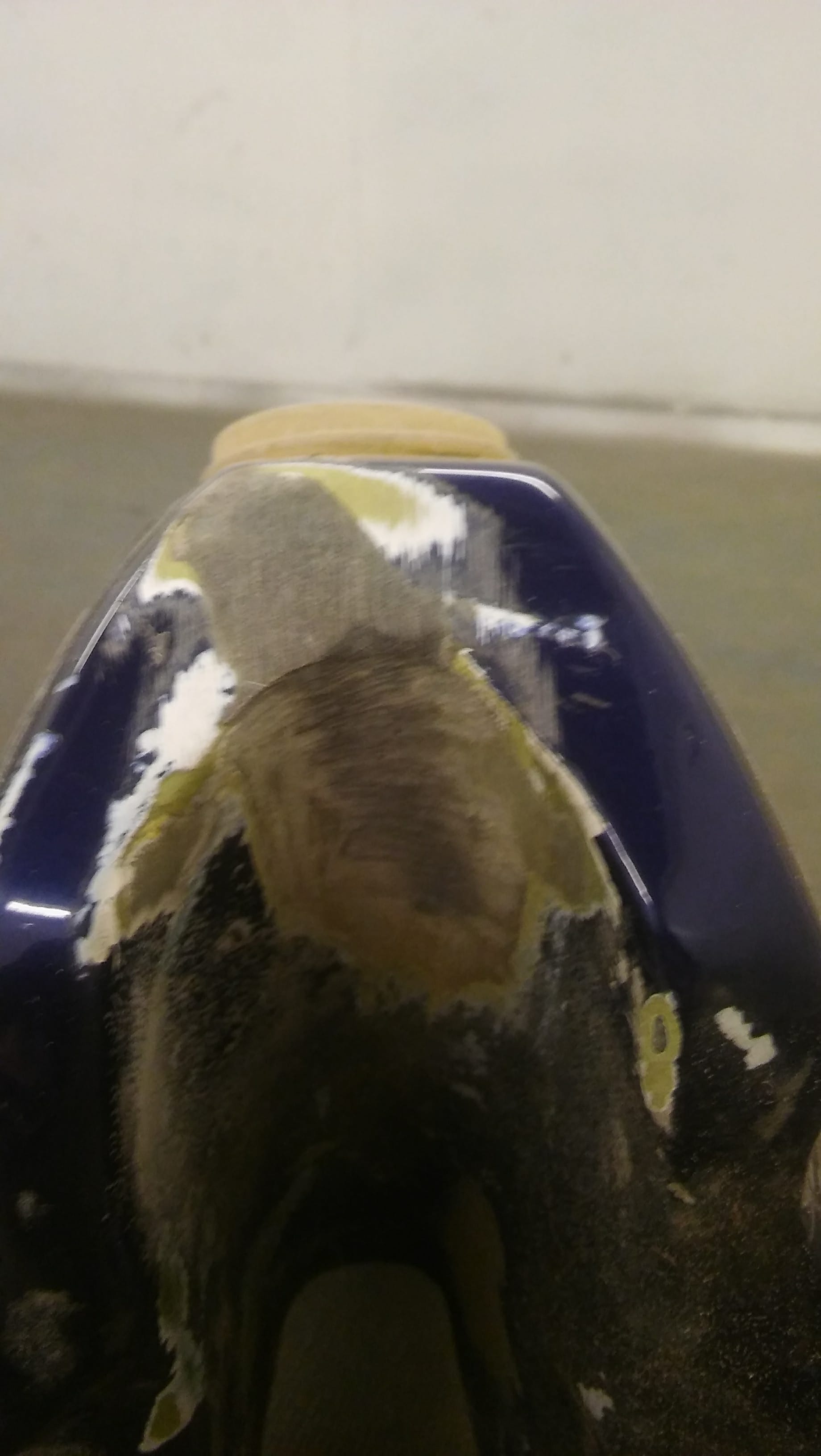

Sparta Posted January 31, 2018 Author Report Share Posted January 31, 2018 Thanks for replays My mate who has paint shop and does some crazy custom painting, does plastic welding too. He helped me out here? 1 Quote Link to comment Share on other sites More sharing options...
section swept Posted January 31, 2018 Report Share Posted January 31, 2018 Looks to be a very workman like repair, good work. Don’t be tempted to rub down the weld path too much. Quote Link to comment Share on other sites More sharing options...
