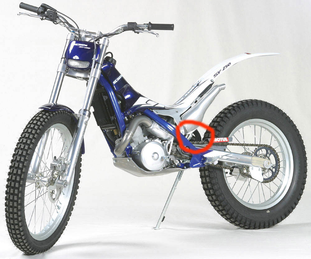

Yambo Posted February 8, 2018 Report Share Posted February 8, 2018 I bought a 2008 SY250 recently and I'm having trouble with dirt getting through my air filter. I cleaned out the airbox and put a new Jitsie filter in when I got the bike. After one ride I cleaned the filter and saw some dirt and water in the airbox. I read about sealing the gap between the plastics and airbox so I did this carefully with foam tape and it seems to be a good seal. Nevertheless, after one ride there was more dirt and water in the airbox. I should add that the PO made quite an effort to prevent water getting in, including a sheet of rubber pulled across between the swingarm and airbox to stop churned up water from the wheel getting in. It hasn't been running right so I took the carb out and there were chunks of mud at the entrance. I stripped it and the main jet holder was packed with mud! I'm having trouble believing that this is normal since I haven't been able to find any mention of it on here. Do Scorpa owners just deal with having to regularly clean out their carb? The only thing I can imagine might be causing it is that the DIY rear mudflap done by the PO might somehow not be doing the job and mud/water might be being thrown by the rear wheel and up to the top of the shock where the airbox draws air in. It looks pretty good though. This is what I mean by mudflap: Quote Link to comment Share on other sites More sharing options...

Yambo Posted February 12, 2018 Author Report Share Posted February 12, 2018 Thanks for all the replies. I'm coming to this from trail riding on a DR350 and I'm used to having a muddy airbox - the difference is that the DR350 filter is on the airbox exit rather than the entrance! I am pretty confident that water is not getting in by flowing over the top of the airbox so I thought it must be getting in through the same hole as the air and overwhelming the filter. It is a new Jitsie filter. On 2/9/2018 at 1:37 PM, pmk said: I want to ask, is the air filter assembly complete? When I say this, does your bike have the rectangular plastic frame, that supports the foam filter flanged edge, forcing a tight seal around the foam perimeter to the airbox? Expand Yes it is complete and clamps down very tightly and evenly. This fact plus the fact that the airbox is a complete plastic unit unlike some bikes (KTM) is what made me think the filter was being overwhelmed. On 2/9/2018 at 1:37 PM, pmk said: Other areas to inspect for dirt entry, the several holes that secure the mudflap as stock, must be plugged. They are open holes into the airbox. Also, there was an upper dust guard, under the fender, it too was secured with screws. Those too may be possible leaks. Expand Thank you for this - I didn't realise the screw holes went all the way through and after shining a torch in there I see that they do. I think they were sealed up but I'll double check when I reassemble. On 2/9/2018 at 1:42 PM, pmk said: One more item to inspect, the rubber airboot, between the carb and airbox. I suspect it is not torn. Look close at this detail. If the airboot aft clamp, that secures the airboot to the airbox is overtightened, or has been previously, the airbox spigot may crush and no longer be round. This will create a gap, unsealed. I had read where another owner had this issue, and utilized a slice of metal tubing to support the airbox spigot. This allowed full tightening of the clamp. Expand This could well be the issue. If stuff was getting in through the filter or through holes in the airbox in small quantities I would expect it to fall down into the lower 'horn' of the airbox rather than be sucked through the high exit to the carb. I'll have a good look out for this when I reassemble. On 2/12/2018 at 12:15 PM, pmk said: I see several of the recent posts recommend the Jitsie air filter. I recently installed the same in my Scorpa. Did anyone else notice, the filter has the coarse foam on the clean side of the airbox, while the fine foam is the first filter media. Seems Jitsie has it backwards. Expand Yes! I almost sent mine back but couldn't be bothered. It's really bizarre as it seem nicely made otherwise; I can only assume that the designer had never seen a Scorpa airbox and assumed it was like all other bikes which have the filter on the exit rather than the entrance. Unless the Scorpa arrangement is common on trials bikes? Quote Link to comment Share on other sites More sharing options...

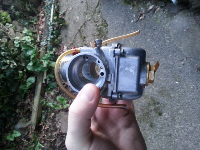

Yambo Posted February 12, 2018 Author Report Share Posted February 12, 2018 (edited) It occurred to me that the breather hoses could also be an issue. As shown in the picture the top two hoses are fairly short and the bottom one is only about an inch long. Perhaps water and dirt are getting to the carb through them when riding through streams etc.. Does anyone know what they are supposed to look like? Edited February 12, 2018 by Yambo Quote Link to comment Share on other sites More sharing options...
