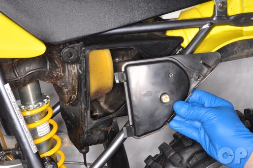

But, given that the filter is made specifically for the bike, no matter whether concave or convex, the dirty side should be the coarse face, its purpose being to stop the "sma' coals" before they reach the fine filter.
On all (non trials) bikes I've seen the air filter looks something like this with the filter at the exit to the airbox:
So you want the coarse mesh on the 'outside' of the filter.
Obviously this is not what you want on the Scorpa; you want the coarse mesh on the 'inside' of the filter. I was just saying that the only reason I could see for Jitsie doing it as they did was that they copied an OEM filter without knowing how it went into the Scorpa airbox. They might have assumed it was like the picture above. Granted it seems pretty weird that they would make a mistake like that but it was the best reason I could come up with.
I tend to agree, and not to steal your thunder, I suspected that, the moment I opened the new filter, but wrote it off as a production mistake when cutting the foam.
