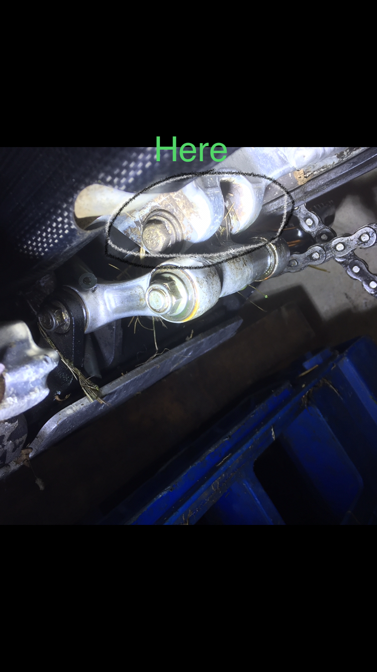

kristian Posted February 17, 2018 Report Share Posted February 17, 2018 (edited) Can anybody help me identify The part circled so I can order new bearings/bush? There seems to be a lot of play in this particular area! It’s where the knuckle connects to swinging arm. Thanks ? Edited February 17, 2018 by kristian Added info Quote Link to comment Share on other sites More sharing options...
pauls320 Posted February 17, 2018 Report Share Posted February 17, 2018 I would say that is the delta link to swing arm bearings in there.. 1 Quote Link to comment Share on other sites More sharing options...
welsh beta Posted February 17, 2018 Report Share Posted February 17, 2018 Bearing number is:Hk15142rs The seal number is:15×21×13 2rs. Hope this is of help. 1 Quote Link to comment Share on other sites More sharing options...
