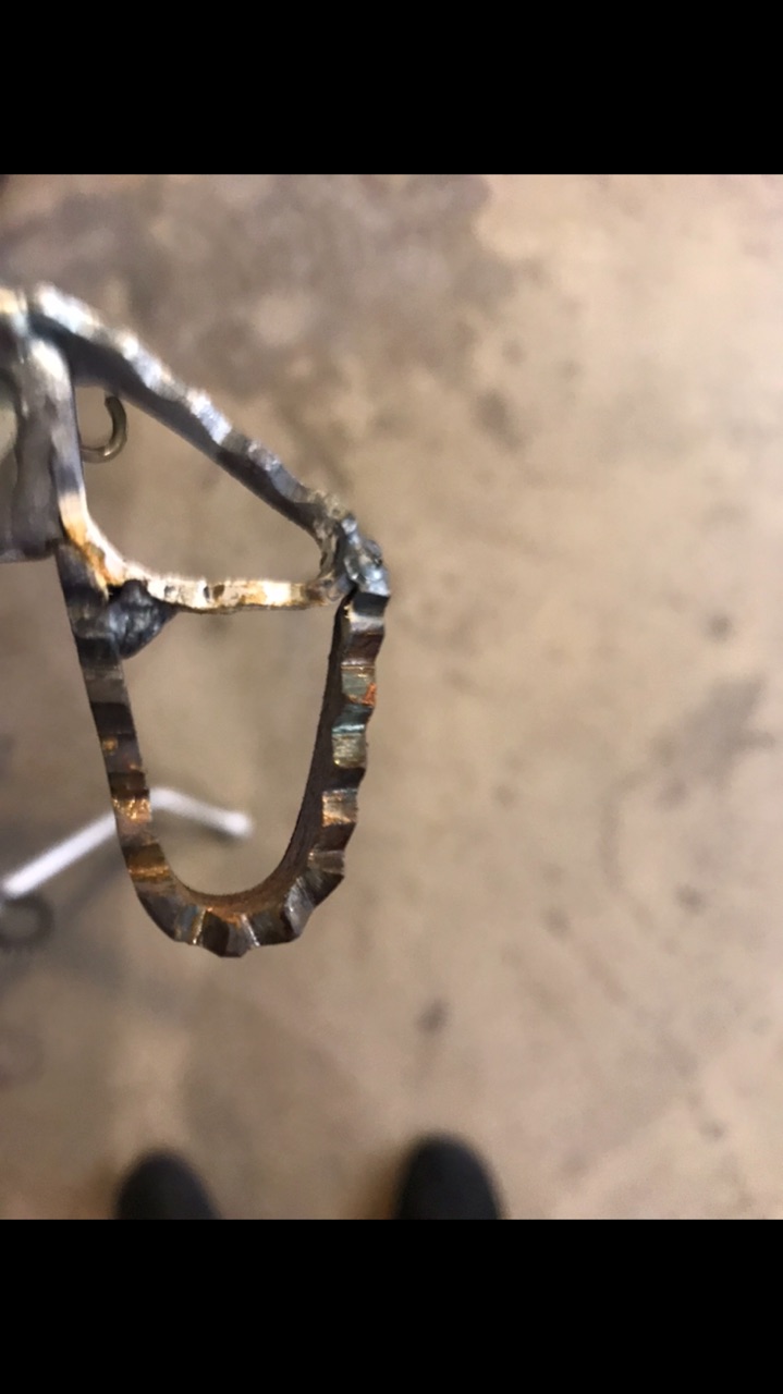

ClaySullivan Posted February 18, 2018 Report Share Posted February 18, 2018 Montesa 260 1 Quote Link to comment Share on other sites More sharing options...
jonnyc21 Posted February 19, 2018 Report Share Posted February 19, 2018 That is one way to solve that problem. I found that you can bend the tab at the top of the peddle to bring it back quite a bit without welding. This dose bring it in a bit as well so might not be preferable. If not there is always aftermarket peddles that are back a lot and tucked in even more as a secondary option. Quote Link to comment Share on other sites More sharing options...
pauls320 Posted February 19, 2018 Report Share Posted February 19, 2018 Not trying to be nitpicky here but...It could really get you hurt if the...welds on that extension let go in a nasty downhill section . One more point one might want to check that the little pivot pin is in good condition as its gonna have a little extra twisting force on it, and they do wear out over time Quote Link to comment Share on other sites More sharing options...
jonnyc21 Posted February 19, 2018 Report Share Posted February 19, 2018 (edited) Best option I can find if your willing to buy new. second item down. "4RT billet rear brake pedal" http://www.handdracing.co.uk/userimages/procart2.htm Edited February 19, 2018 by jonnyc21 Quote Link to comment Share on other sites More sharing options...
jimmyl Posted February 19, 2018 Report Share Posted February 19, 2018 The 300 rr pedal is shorter if you can get a part number can get from a Honda dealer - not sure on cost Quote Link to comment Share on other sites More sharing options...
collyolly Posted February 19, 2018 Report Share Posted February 19, 2018 I did that mod on my 05 4rt back in 2006, and I have size 11 feet, never could understand the reason for the pedal position especially since the bike is supposed to be perfect ! Quote Link to comment Share on other sites More sharing options...
