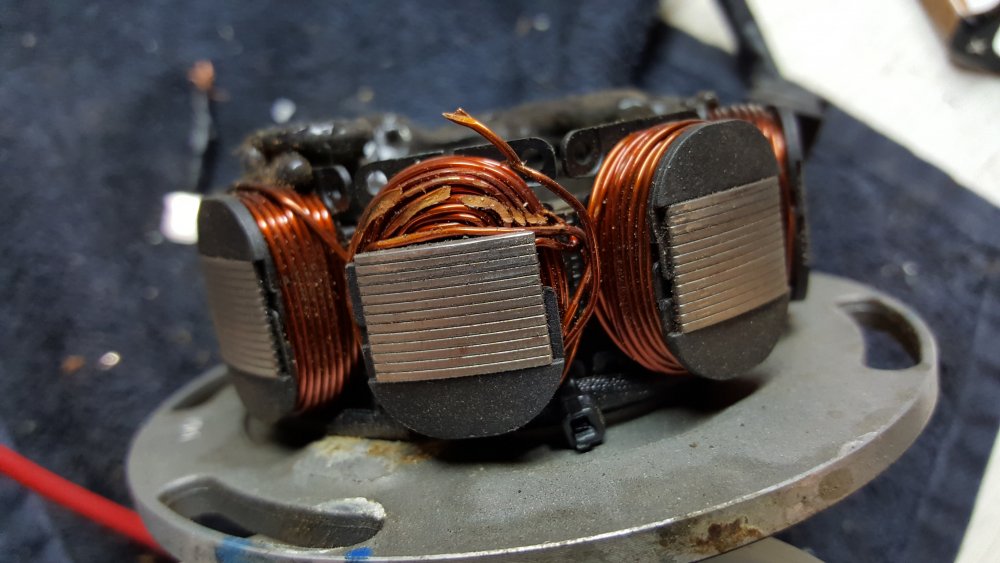

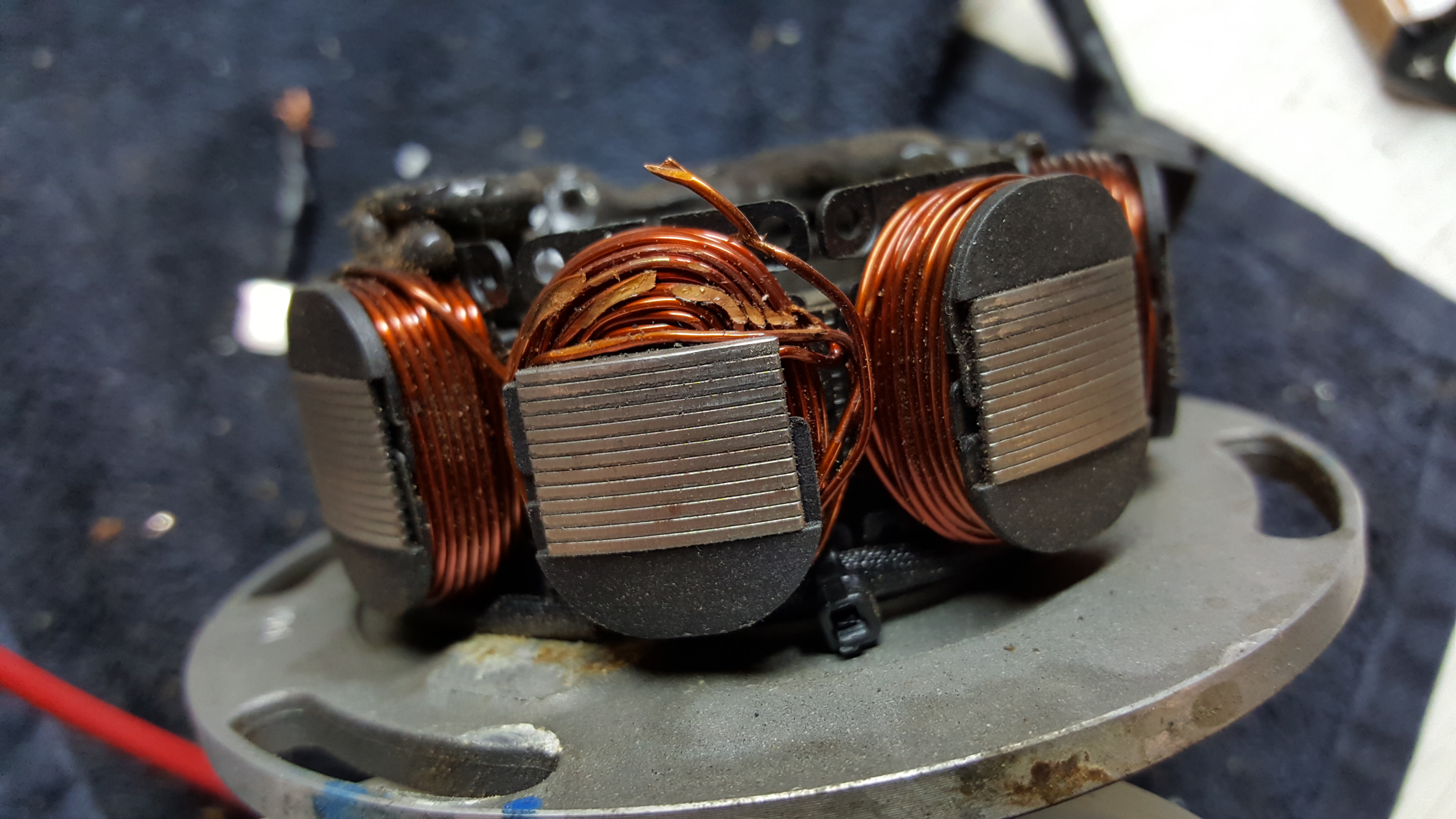

SquamishDroc Posted February 25, 2018 Author Report Share Posted February 25, 2018 Did some resistance tests and found the yellow wire open circuit. So I borrowed a flywheel puller from a friend and pulled it off today. Low and behold I found the problem. Looks like at some point part of the stator broke off. The broken part was not in the case so I assume the previous owner must have removed it. Then the coil wires must have slowly rubber through on the flywheel. I am going to try and repair it myself, but if that doesn't work then I guess a new stator will be needed. Quote Link to comment Share on other sites More sharing options...

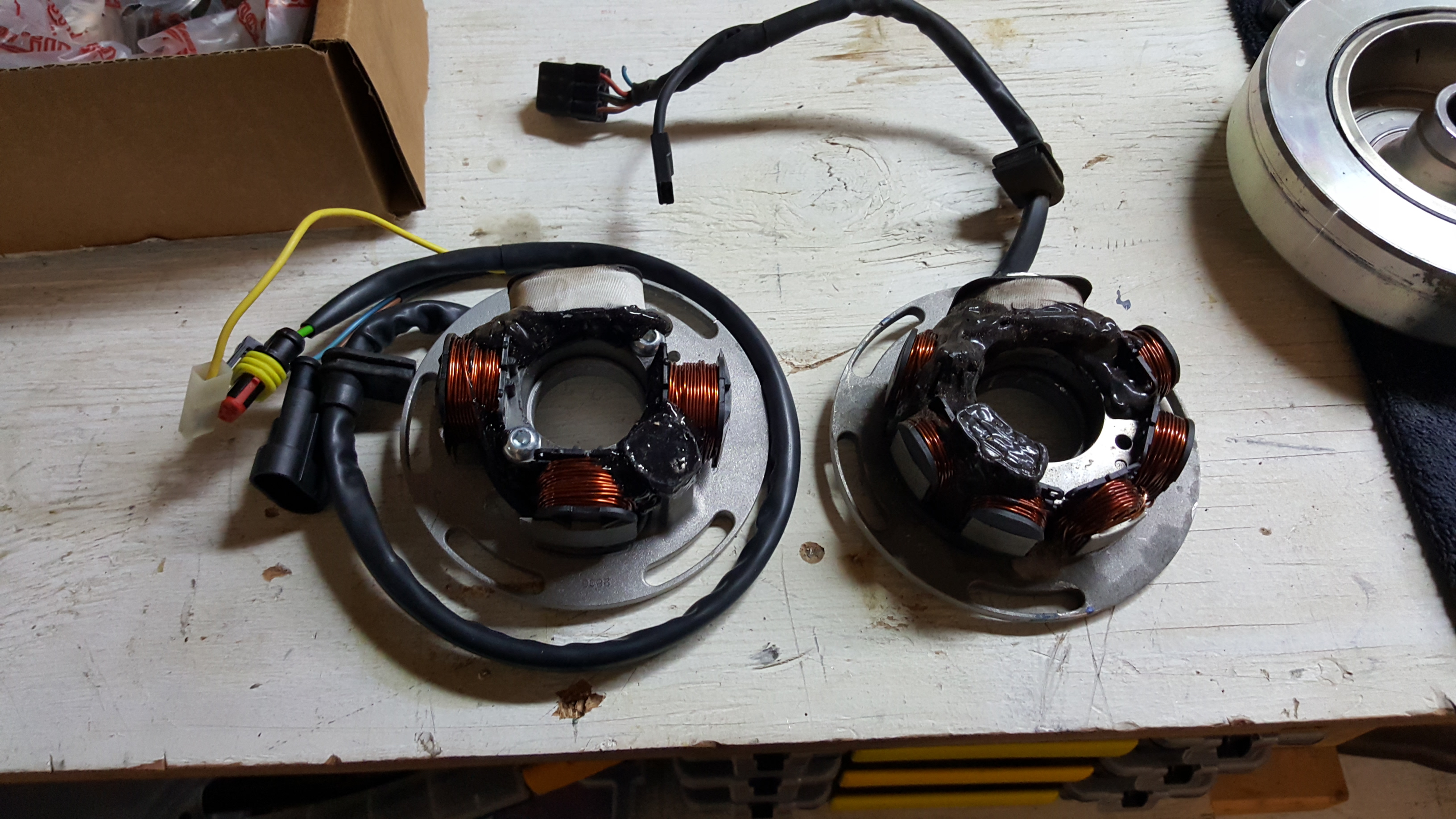

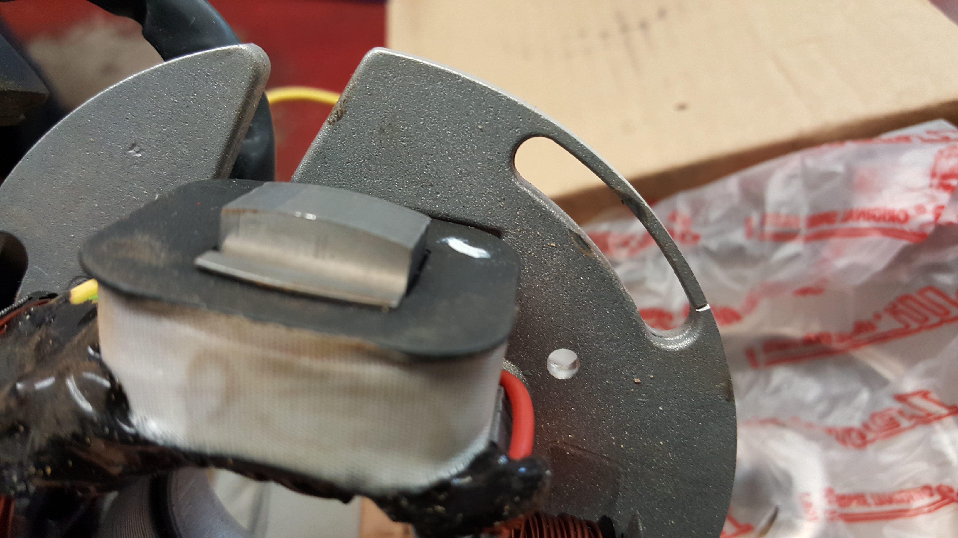

SquamishDroc Posted March 10, 2018 Author Report Share Posted March 10, 2018 On 2/25/2018 at 9:55 PM, copemech said: I think you found the problem then, great job! Just goes to show you never know! Got my parts yesterday - wrong part in the right box Wasn't impressed that's for sure. The worst part is that the stator I got had been installed. It had witness marks from it being bolted down and dirt on the grommet where it goes through the case. Contacted the vendor today and he is taking it back and refunding my $$ - problem is he doesn't have another one. So I either order from RYP and get hosed on duties or wait for my local dealer to get one from Italy or wherever they come from. Quote Link to comment Share on other sites More sharing options...
