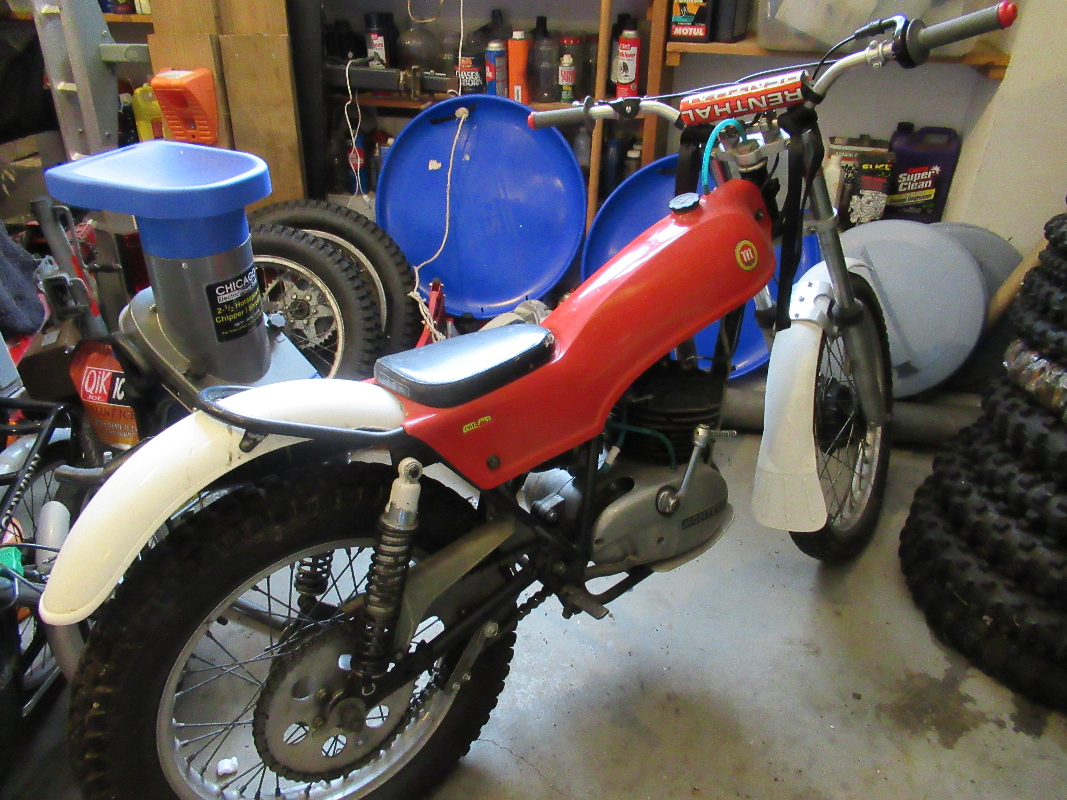

dirtrider6 Posted February 28, 2018 Report Share Posted February 28, 2018 I'm back after a long hiatus just couldn't keep away from the throttle, my last bike was a 2002 Sherco 2.9 I had an opportunity to purchase a Montesa Cota 247 COMPLETELY rebuilt New everything. New main bearings, rebored, new piston, new rings, chains, It has only been run for about 30 minutes after the rebuild. The owner is unsure of the year at this point it has been sitting a good number of years, my main question is about the break in period I have no idea on this bike Also any help of mixing ratio's , Crankcase oil, or other valuable information would be greatly appreciated I should have it in a couple weeks and I'll look for numbers on the frame Thanks Chuck Quote Link to comment Share on other sites More sharing options...

2stroke4stroke Posted February 28, 2018 Report Share Posted February 28, 2018 Nice bike indeed, and all the more so for still having the original tail silencer as opposed to one of those horrible sounding alloy jobs that they usually have by now. 1 Quote Link to comment Share on other sites More sharing options...
