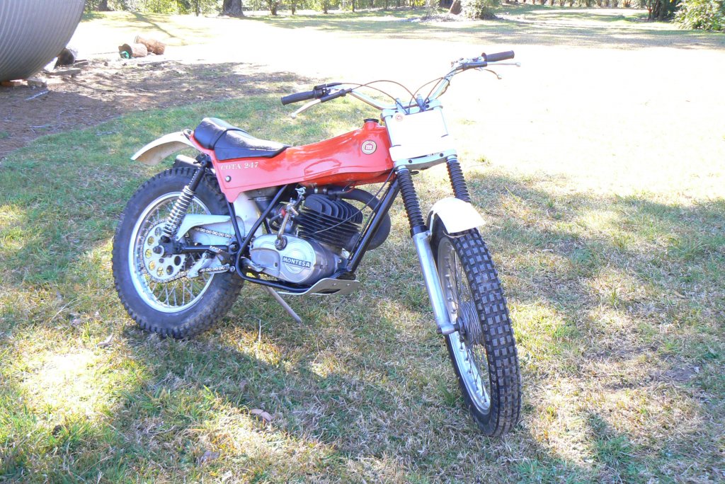

keychange Posted April 10, 2018 Report Share Posted April 10, 2018 There are three tank/seat options ( maybe more ). I have the standard trials body as per your photo - the 247T (trail) body with larger tank and longer padded seat and the later model large tank with very comfy seat. The latter requires rubber grommet spacers for he rear mounts but otherwise fits perfectly and is very comfortable. Quote Link to comment Share on other sites More sharing options...

dirtrider6 Posted April 11, 2018 Author Report Share Posted April 11, 2018 16 hours ago, keychange said: There are three tank/seat options ( maybe more ). I have the standard trials body as per your photo - the 247T (trail) body with larger tank and longer padded seat and the later model large tank with very comfy seat. The latter requires rubber grommet spacers for he rear mounts but otherwise fits perfectly and is very comfortable. This is very exciting in deed! Looks like your bike body extends over the rear fender where mine ends before the grab bar? What year and model is that seat from? That would be awesome for exploring Quote Link to comment Share on other sites More sharing options...

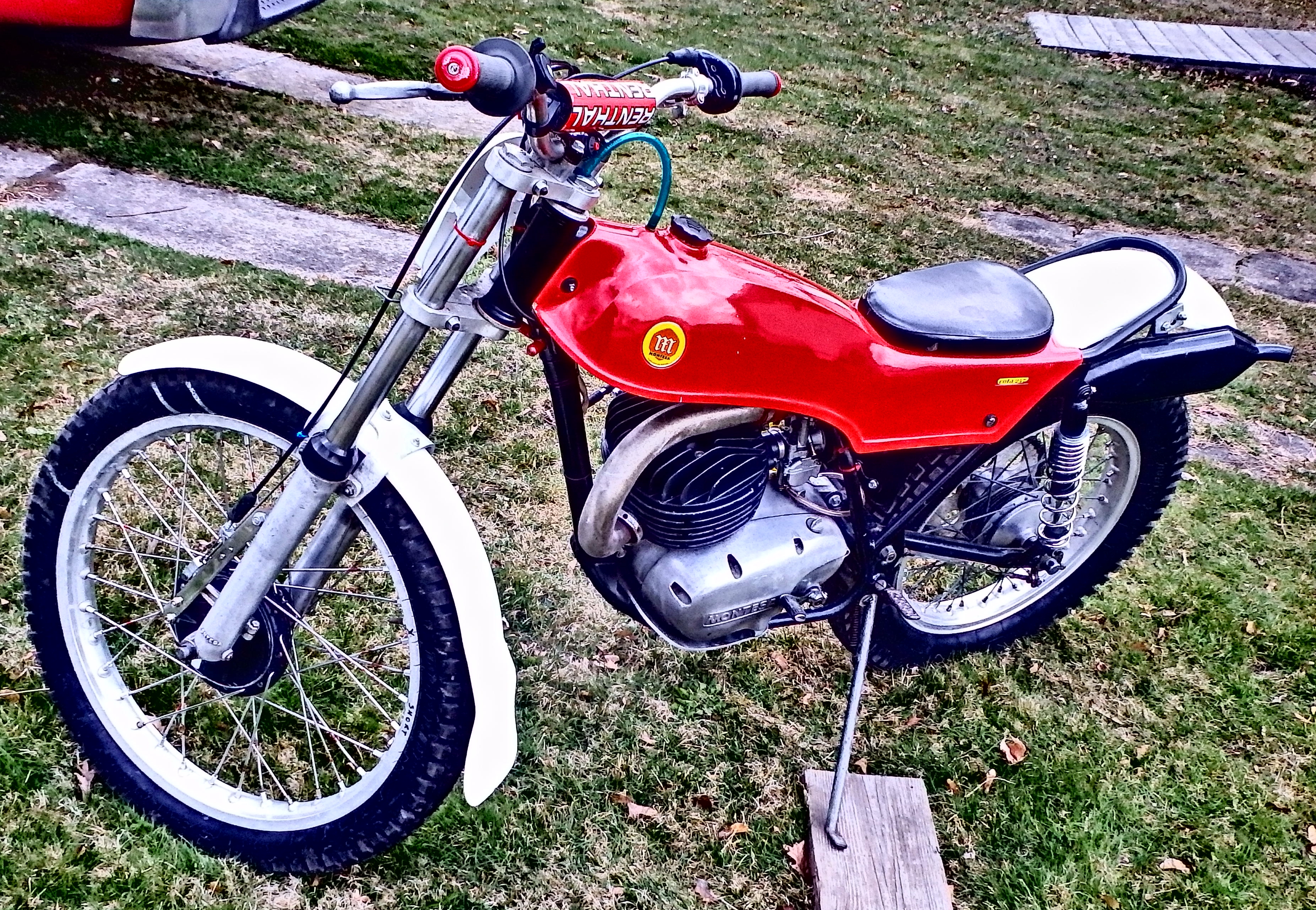

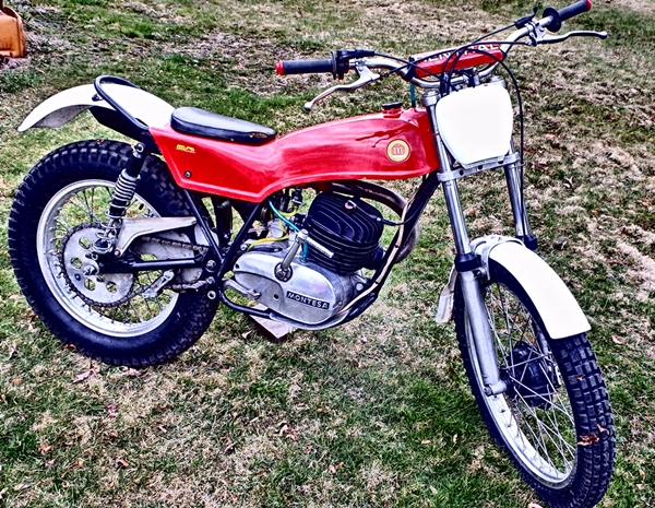

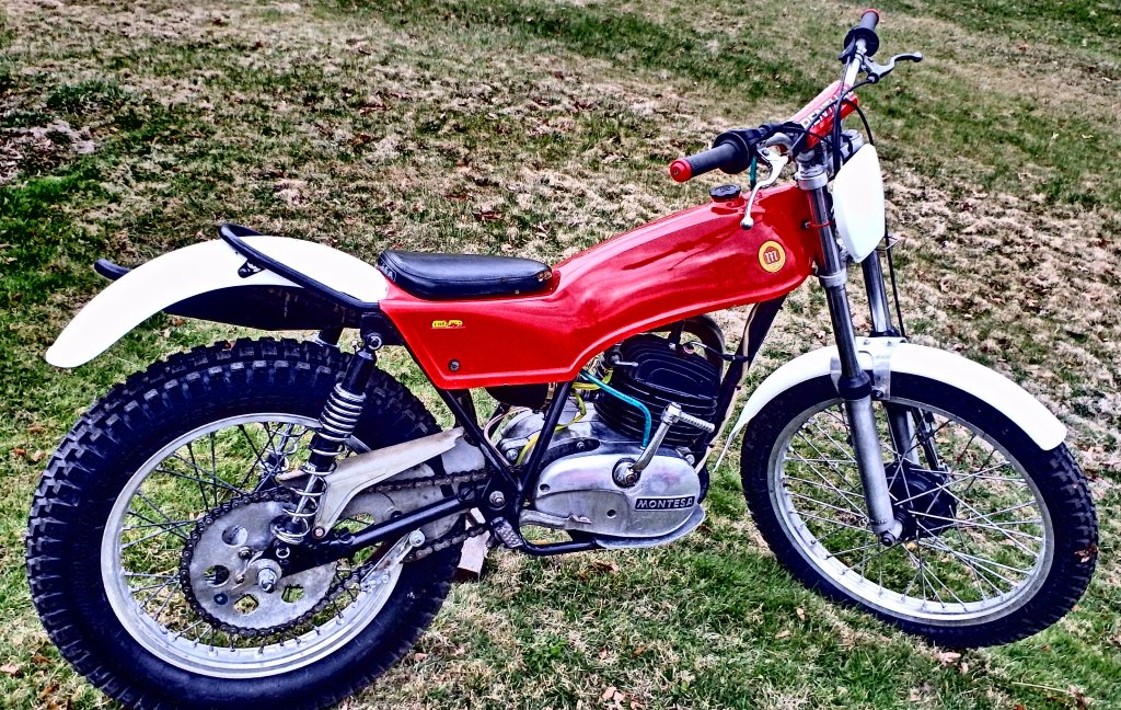

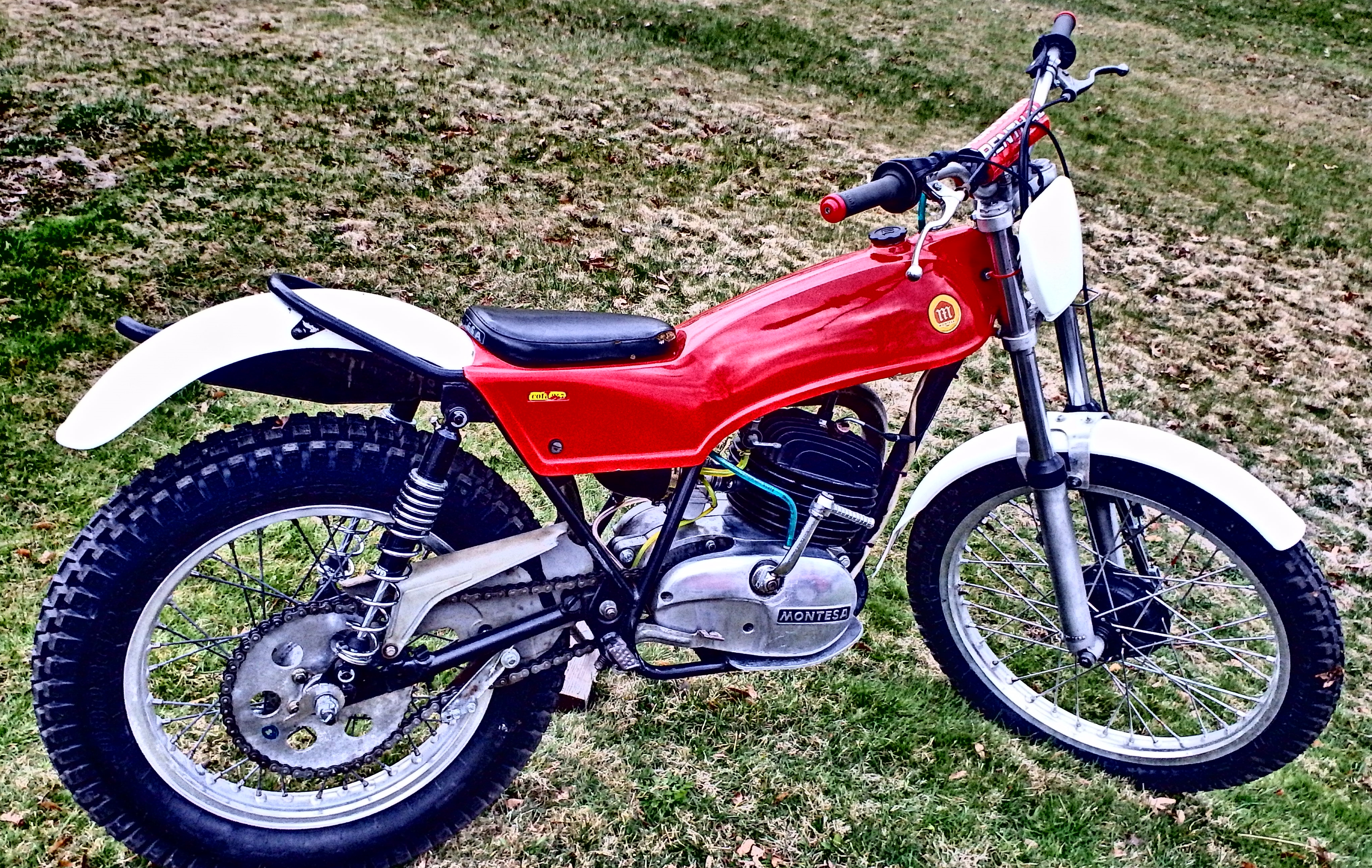

dirtrider6 Posted April 13, 2018 Author Report Share Posted April 13, 2018 Picked up the Montesa the other day finally had a chance to take some pictures last night 2 Quote Link to comment Share on other sites More sharing options...
oldaz Posted April 13, 2018 Report Share Posted April 13, 2018 Nice looking bike. You could drain the gearbox and try some 75w gear oil - needs to be a GL4 type oil as there's brass bits in there and GL5 will affect the brass over time. Quote Link to comment Share on other sites More sharing options...
yamanx Posted April 13, 2018 Report Share Posted April 13, 2018 Nice looking Monty 1 Quote Link to comment Share on other sites More sharing options...
