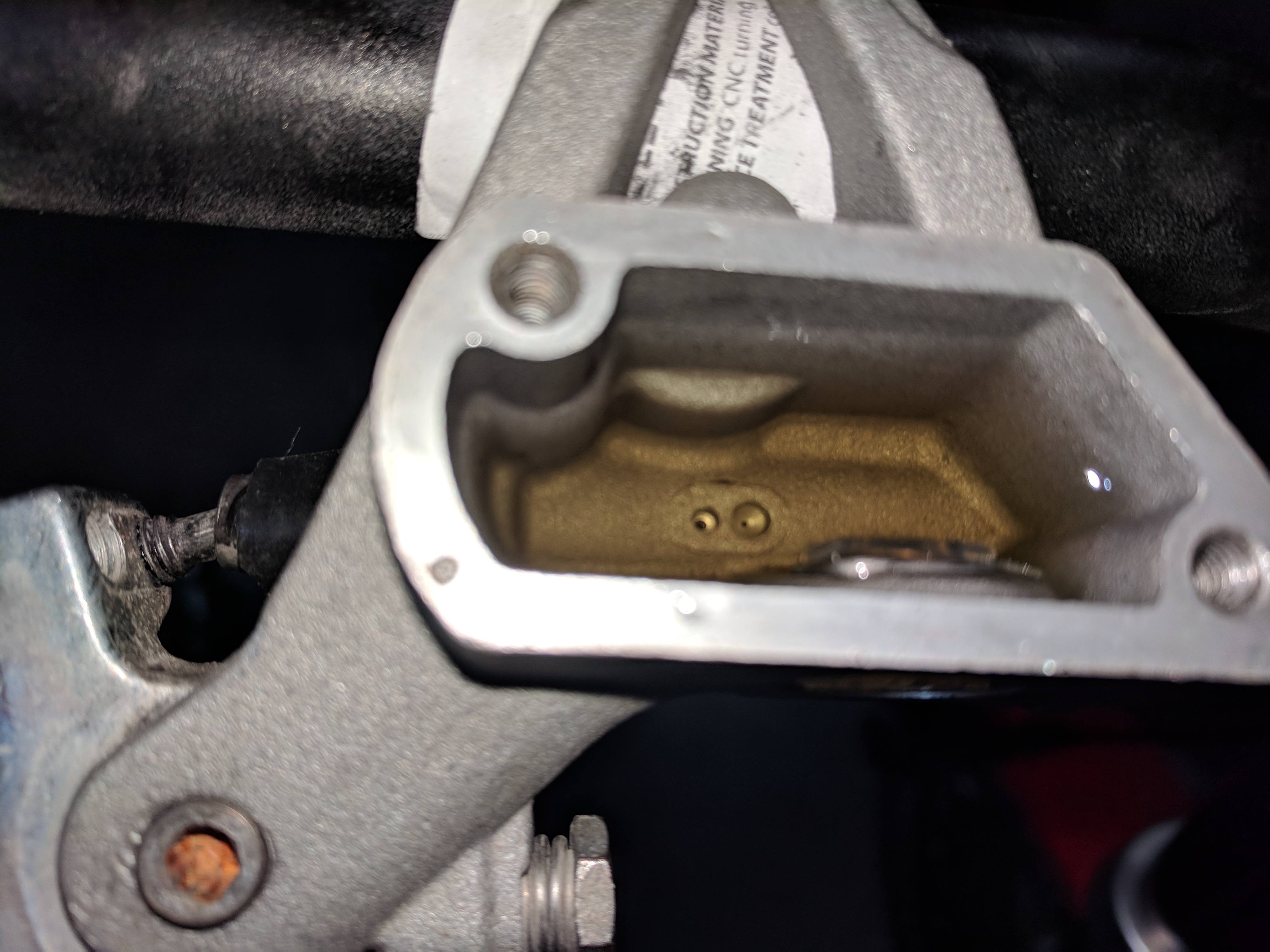

luckydim Posted March 5, 2018 Author Report Share Posted March 5, 2018 Thanks Zippy, I've checked the hose - didn't find any spots there. Hey Dan, I removed the master cylinder cover. Should I see the piston position through these small holes at the bottom of the cylinder (photo attached)? 1 Quote Link to comment Share on other sites More sharing options...
dan williams Posted March 6, 2018 Report Share Posted March 6, 2018 No sorry, that’s the resevior. I meant the little round rubber bit that covers the end of the master cylinder where the lever pushes against the piston. Quote Link to comment Share on other sites More sharing options...
dan williams Posted March 6, 2018 Report Share Posted March 6, 2018 Though it’s still worth a look into the resevior so no effort wasted. Nothing looks out of place. Quote Link to comment Share on other sites More sharing options...
