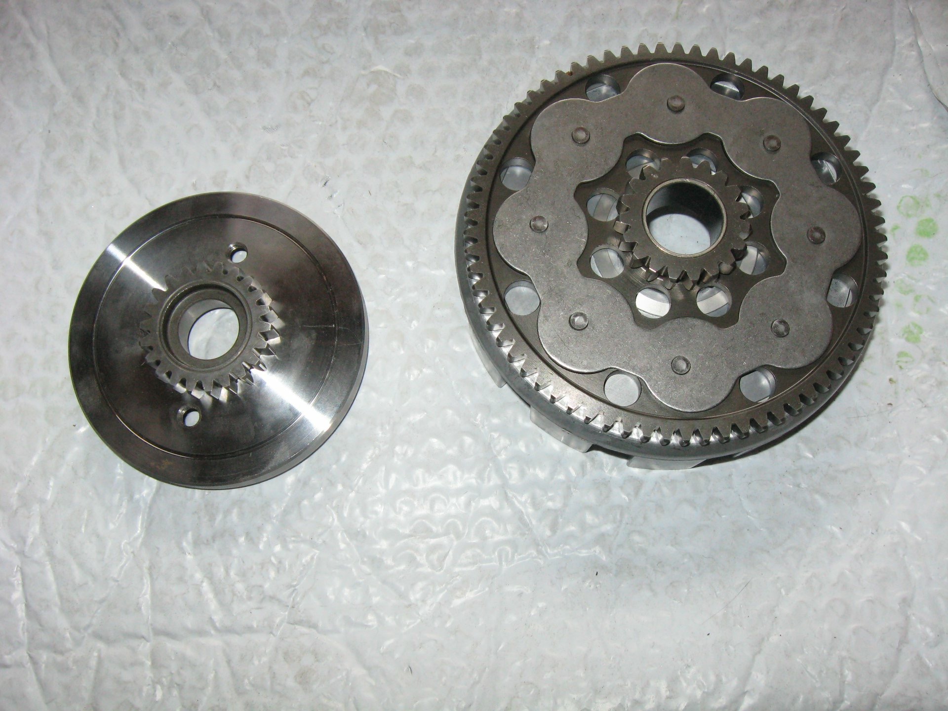

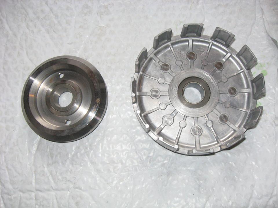

I have confirmed that the primary side weight is an added weight . I assume it is added by Beta for certain models ,( Mostly for the UK market) and I know that they (Beta) do not sell it as a separate item . also the added weight is a different material and not hardened like the primary gear .   So now all I need to do is find a used one and transfer it to my primary gear !!
Link to comment
Fortunately a friend of mine posted these so I can see the new ones do appear to be a press fit so yup I was wrong again. I’d still be very wary of a DIY solution for this. Good luck though. I hope you can find a solution that works for you but this might be one case where it’s better to spend the money and buy the factory parts.
