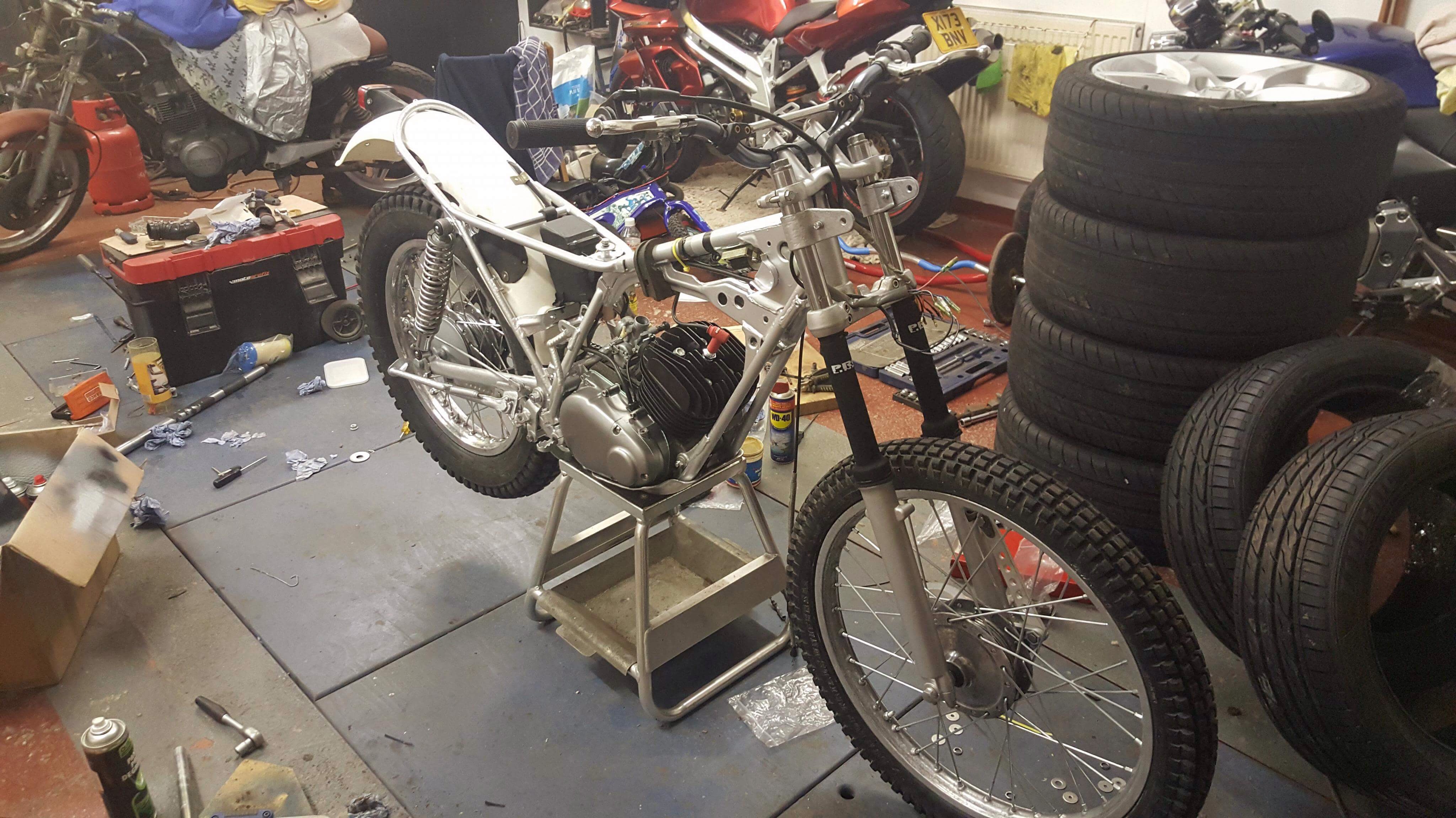

steve1979 Posted March 14, 2018 Report Share Posted March 14, 2018 Hi guys, Rebuild is coming along, getting into a few nitty gritty jobs now. While fitting up the throttle cable it felt a bit tight and rough. I dismantled it and oiled it but it's still stiff for the throttle to snap closed. My question is, do you bin the oil pump in favour of a single throttle cable and just mix the oil with the petrol. My thinking is, it's a near 40 year old pump, what if it doesn't deliver the oil as it should. bin it and single throttle cable or replace with new duel cable and keep the convenience of the pump? what have you guys done. Oh and as for tank graphics, do I opt for the thin double line that was on it originally or go for the chunky red graphic that wraps over the tank? cant decide what will look better. She's a 1980 so maybe to keep her heritage right I should go for the thin double line. But I do like the look of the chunky red? here's how she's looking just now. Quote Link to comment Share on other sites More sharing options...
