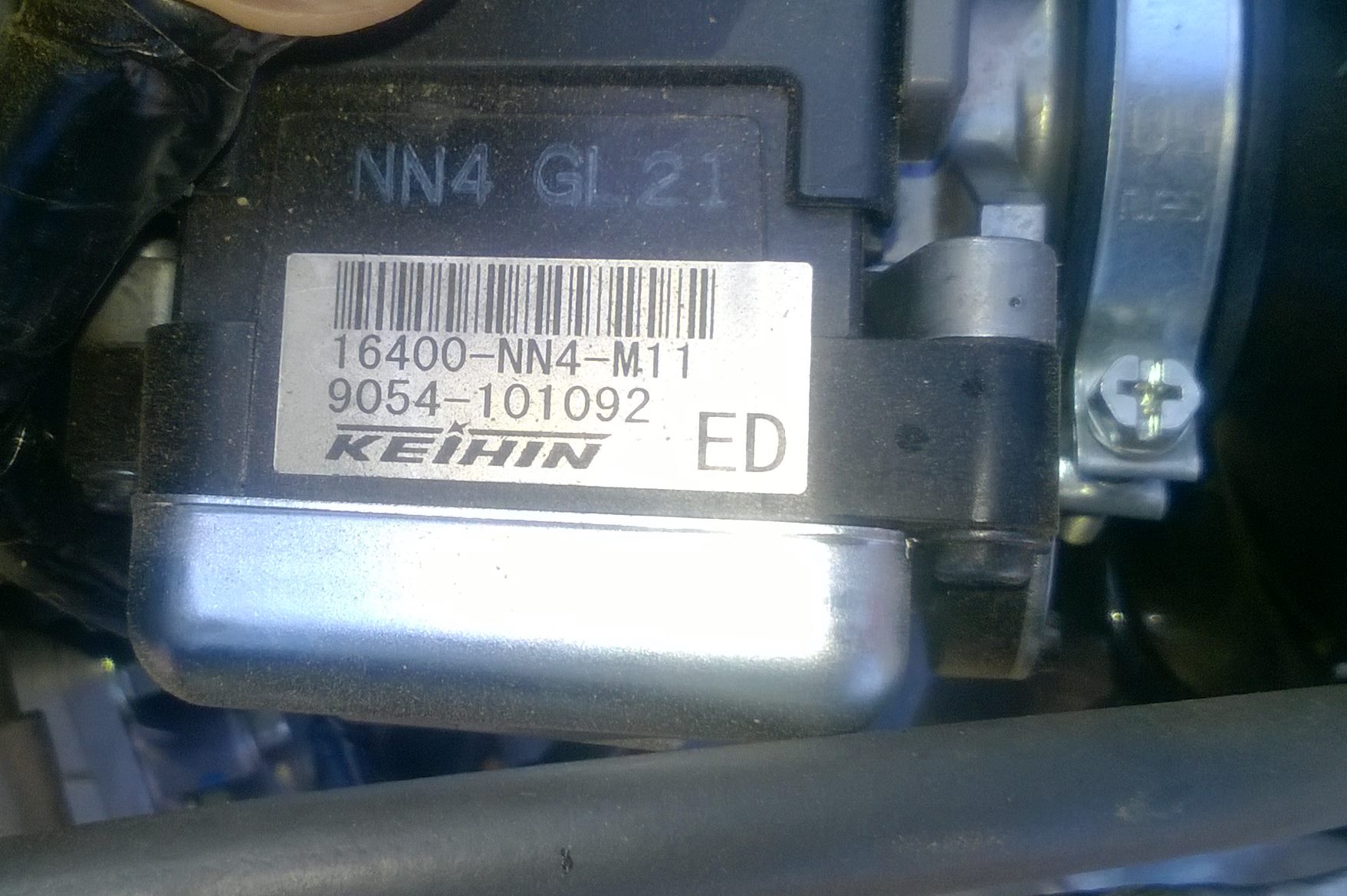

hc-hardy Posted April 17, 2018 Author Report Share Posted April 17, 2018 Sorry for the delay, her is the picture of the 2018 ECU, there is no difrence exept from the "stamp" on it wich is NN4 GL21 mine ont he 2017 is NN4 G24.... Quote Link to comment Share on other sites More sharing options...
