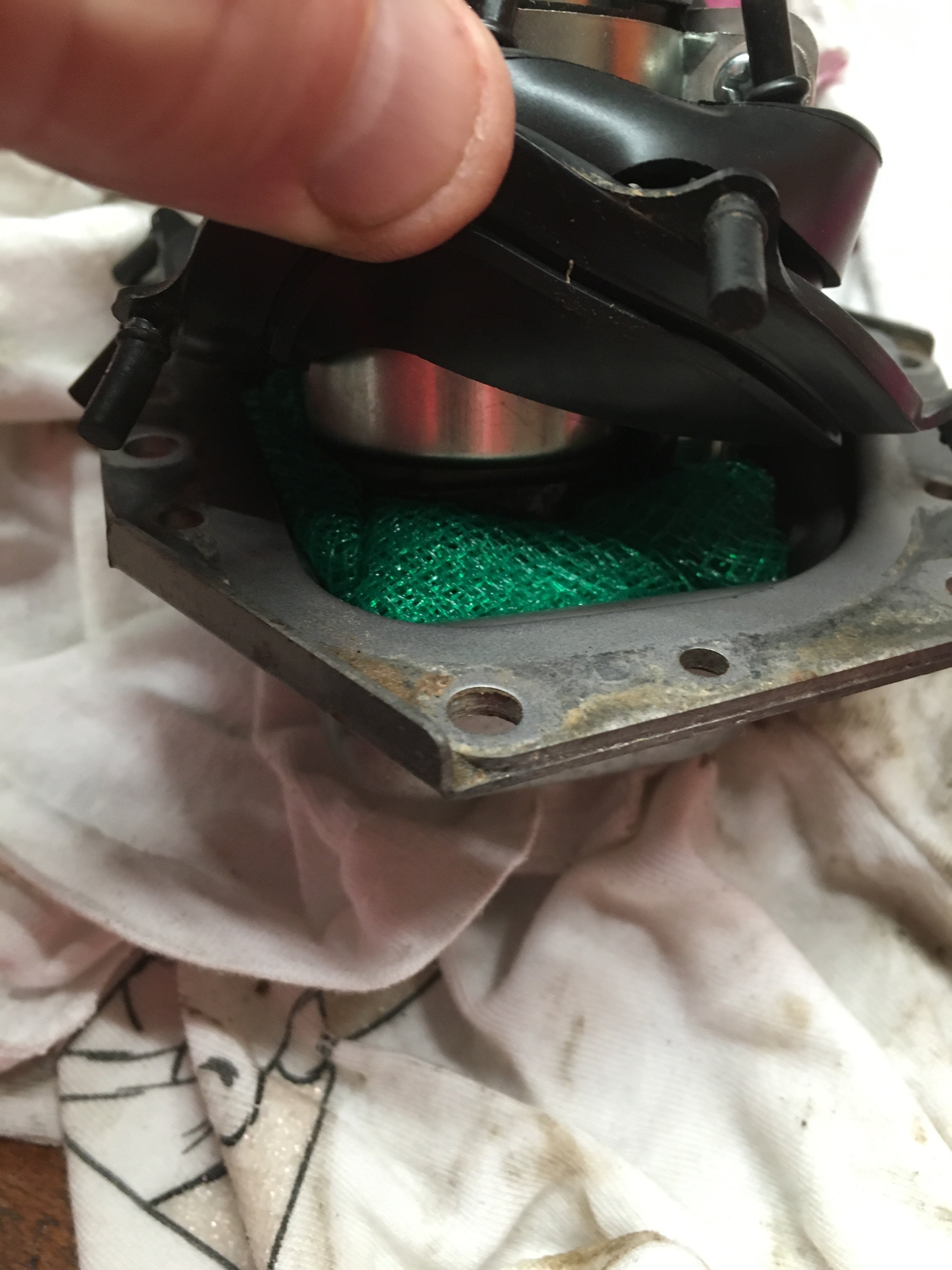

gasgasshetland Posted March 25, 2018 Author Report Share Posted March 25, 2018 Hi Guys. Was out again today. Had changed plug,checked coolant. Slackened off the throttle cable and brought the idle speed up, but it continued to do the same and drop the idle speed on shutting off throttle. I’ve taken the tank off to check it. Looks spotless inside. Is the teabag type filter in the small sump below the pump? Lifting the gasket I ca see a green mesh. Is it within the mesh. I will attach a photo. Any advice welcome I was thinking to get the throttle body off and see if it needed cleaning. It’s all new to me as I’ve been a Gasgas/ carb user until this bike being my first fuel injected so it’s all a bit of a mystery to me?? Quote Link to comment Share on other sites More sharing options...
jonnyc21 Posted March 25, 2018 Report Share Posted March 25, 2018 It's under the pump assembly in a space between the green stuff. You have to pull the pump to get at it. Quote Link to comment Share on other sites More sharing options...
