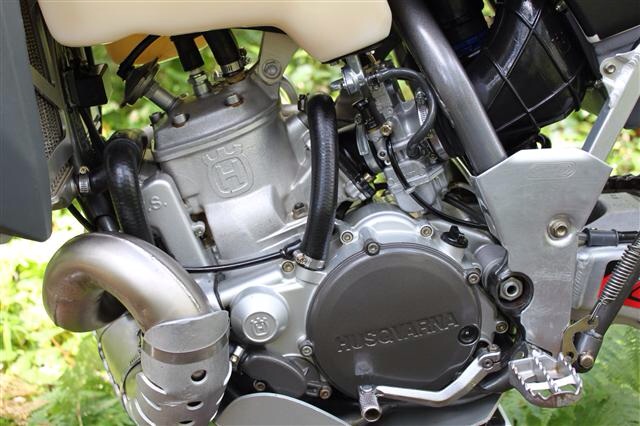

nhuskys Posted March 22, 2018 Report Share Posted March 22, 2018 R&D Husky in Australia, used to do this compression release mod to WR360 head. It was from a 2T lawnmower engine. Quote Link to comment Share on other sites More sharing options...
