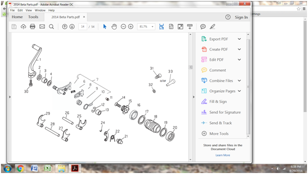

nh014 Posted March 26, 2018 Report Share Posted March 26, 2018 Check the rivet in the gear selector assembly, item 7 in the attached figure. If the rivet in the selector (item 8) comes out, or becomes loose, the transmission will not shift. Quote Link to comment Share on other sites More sharing options...

reggie Posted March 26, 2018 Report Share Posted March 26, 2018 Things to make sure you do when you have the clutch cover off. 1) Make sure you keep track of the shims on both the shift shaft and the kick start shaft. 2) Make sure item 15 is attached tightly to the shift drum , I have seen one of these not tight before. Good luck. Quote Link to comment Share on other sites More sharing options...
