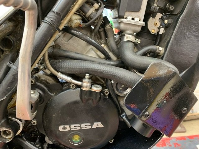

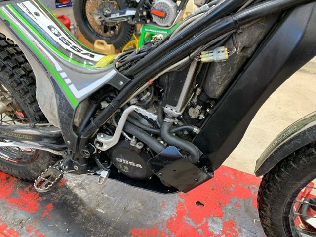

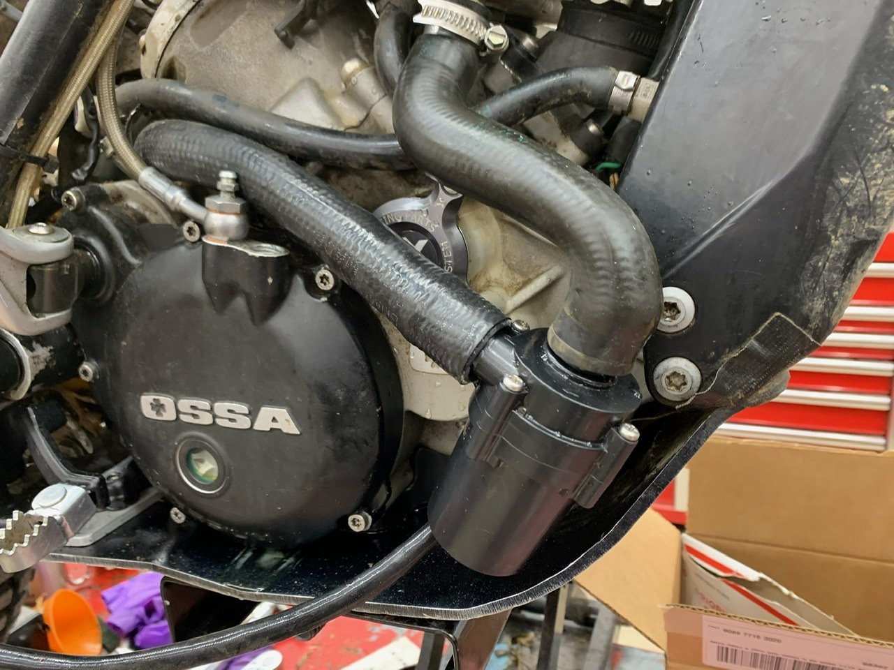

Yes, I think it is the same pump Vertigo uses.
    The pump works well and seemed to fit in this spot with a guard.  Not many places to put it- and I’ve never seen one done.
For the upper hose, I used one off a KTM that was connected to ‘splitter’.  Fit quite well.  I originally was going to mount it inverted, but it seemed to pump way better this way.
Link to comment
