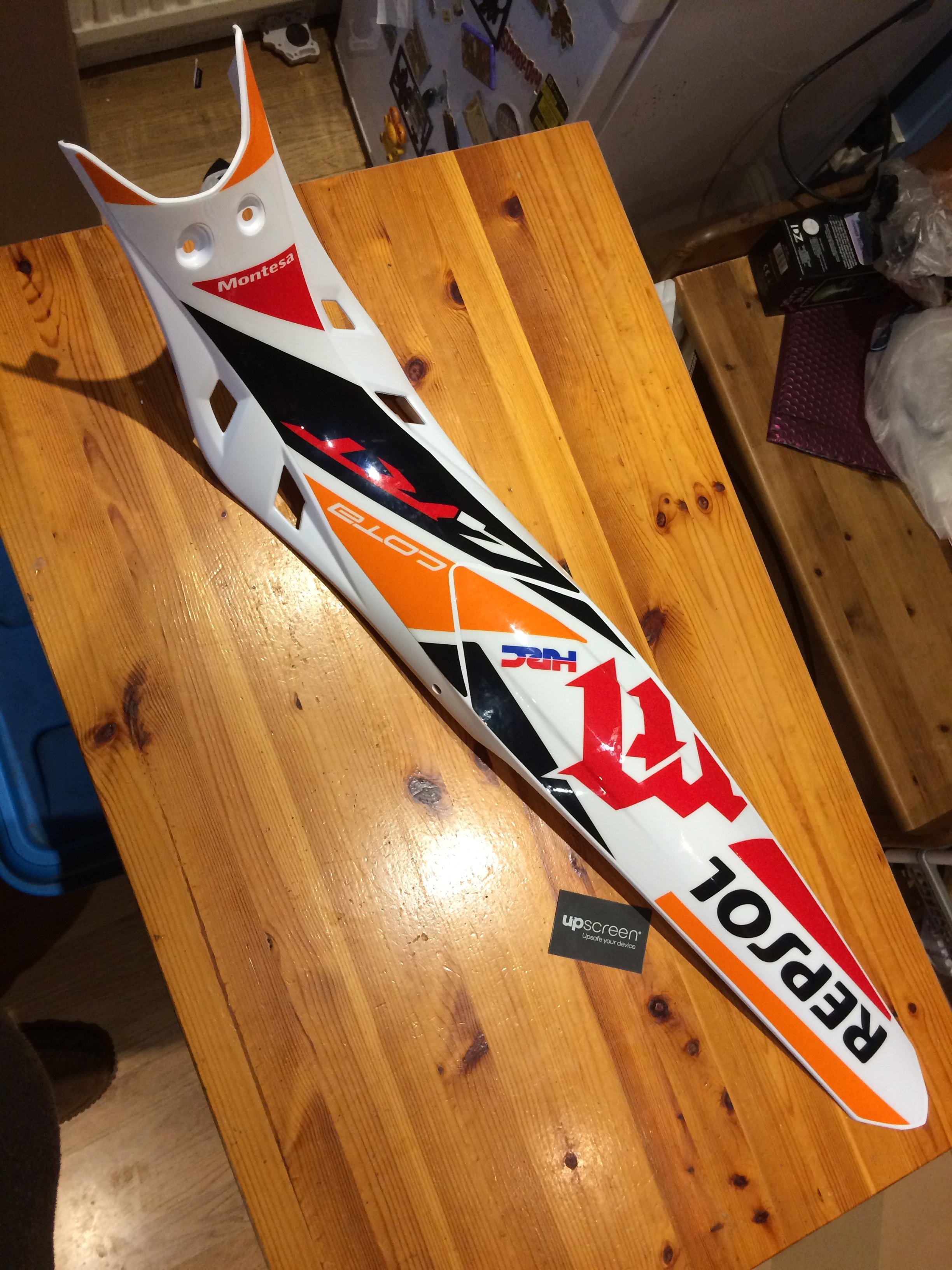

barfy Posted April 4, 2018 Report Share Posted April 4, 2018 So I’m after some advice about putting on a rear mudguard sticker. I’ve got a new mudguard and sticker on the way after breaking the current one at the weekend. From what I’ve read and my thoughts here is what I was going to do: Warm the sticker on the radiator. Wet the mudguard with a solution of water and washing up liquid. Starting at the back put the sticker on using a hair dryer to heat and slightly stretch down the middle of the sticker. Work from the middle to the edge squeezing out the bubbles. Repeat with the seat but without slightly stretching the middle of the sticker. Quote Link to comment Share on other sites More sharing options...

barfy Posted April 4, 2018 Author Report Share Posted April 4, 2018 Thanks for the advice guys. I'm good with flat surfaces, but it's the 2 way curvature that is a bit of concern. The mudguard and stickers arrived today, so I'll give it a go on Saturday when I've got some time to take it carefully and can get on the kitchen table. Sounds like I best not ask the wife to give me a hand because it could end in tears. Most probably mine when I've buggered £60 worth of graphics that have gone wrong. Fingers crossed... Quote Link to comment Share on other sites More sharing options...

barfy Posted April 7, 2018 Author Report Share Posted April 7, 2018 Thanks Section, I like my bikes to look neat. I hope it distracts the observer for when I have my feet down. Anyway thanks for the advise. It’s all done and although some small bubbles where the crease is in the mudguard under the sticker it looks ok. Well I’m happy with it. Quote Link to comment Share on other sites More sharing options...

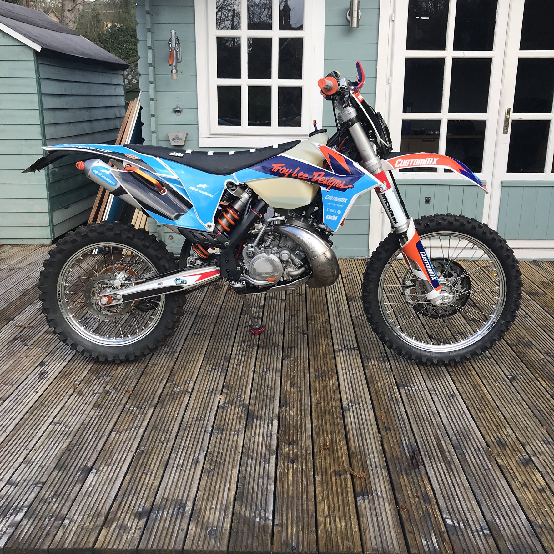

steve0 Posted March 19, 2019 Report Share Posted March 19, 2019 Graphics are not that hard even on compound curves, have to disagree with the above, I never use water and always use lots of heat, just done this for our kid to sell, don’t be afraid to lift and lift again if your not happy Quote Link to comment Share on other sites More sharing options...
