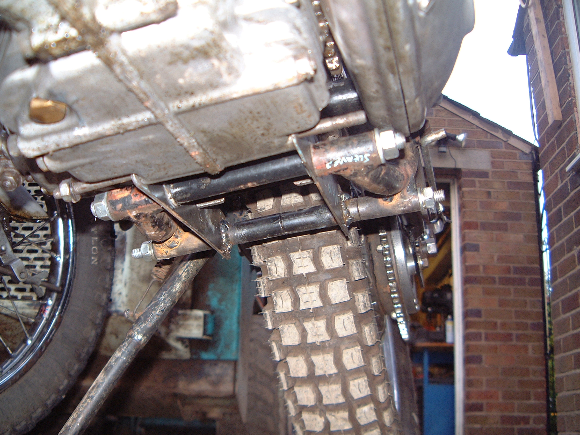

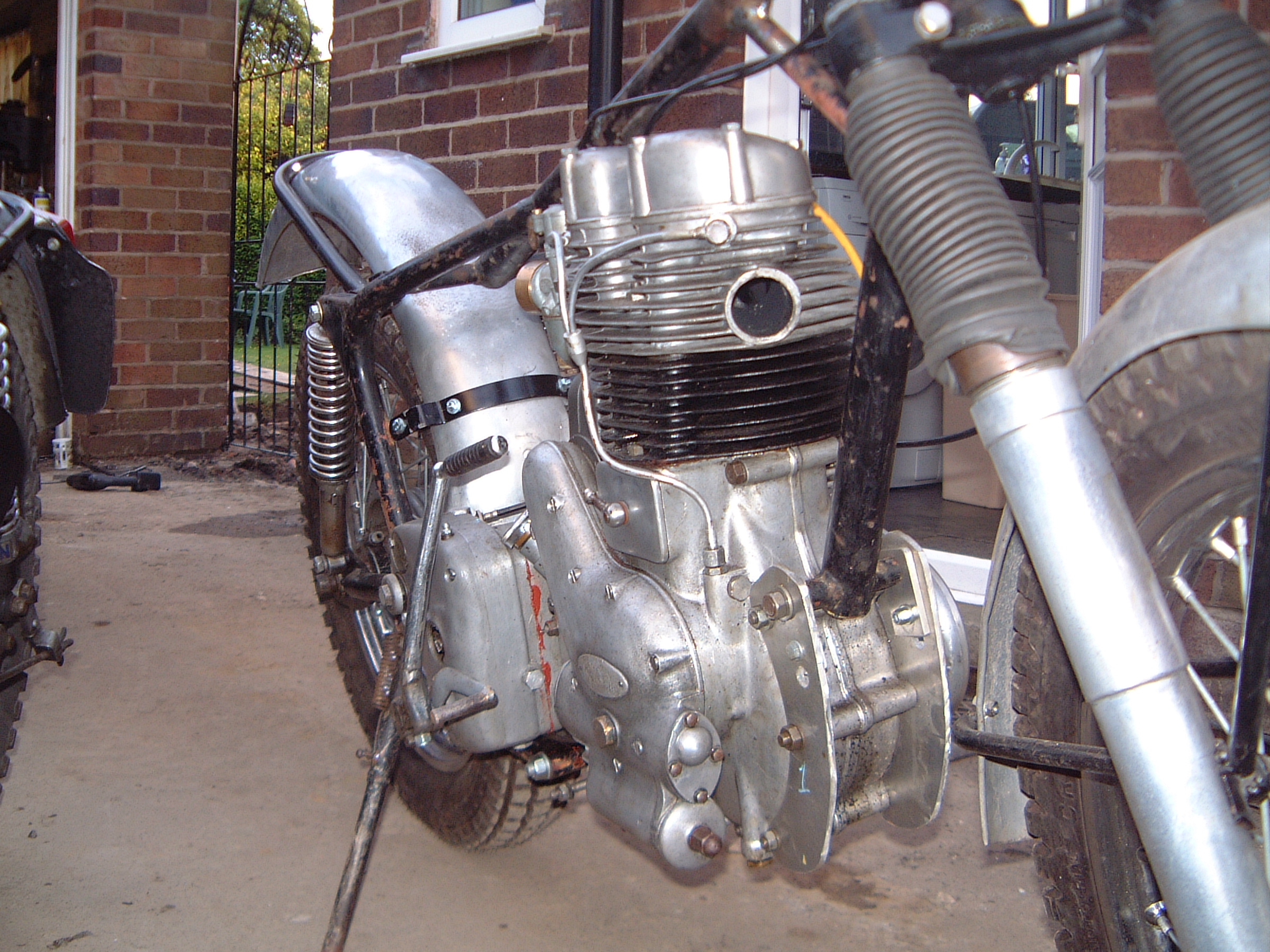

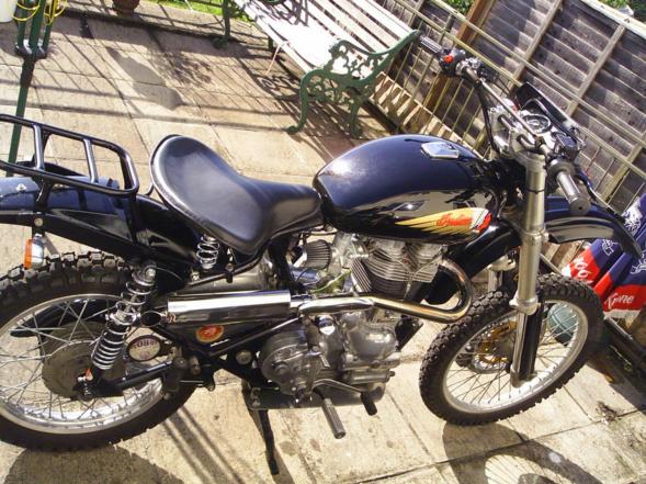

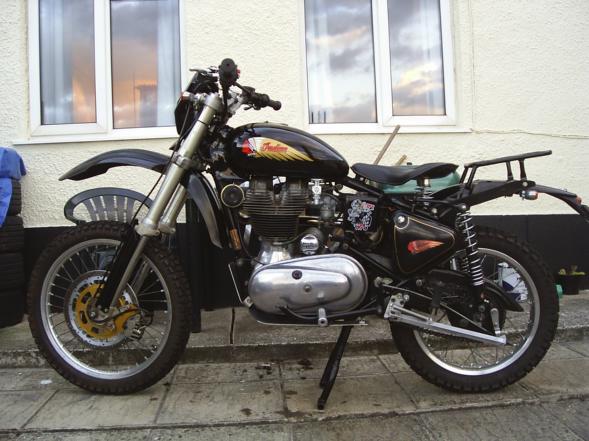

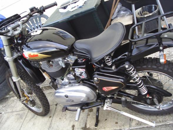

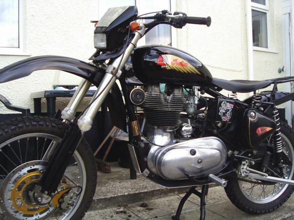

pug Posted April 7, 2018 Report Share Posted April 7, 2018 4.0 x 18 tyre will fit in a Bullet Arm I put one in not long after this Green Lane build I did 8 -10 years back VIDEO Quote Link to comment Share on other sites More sharing options...

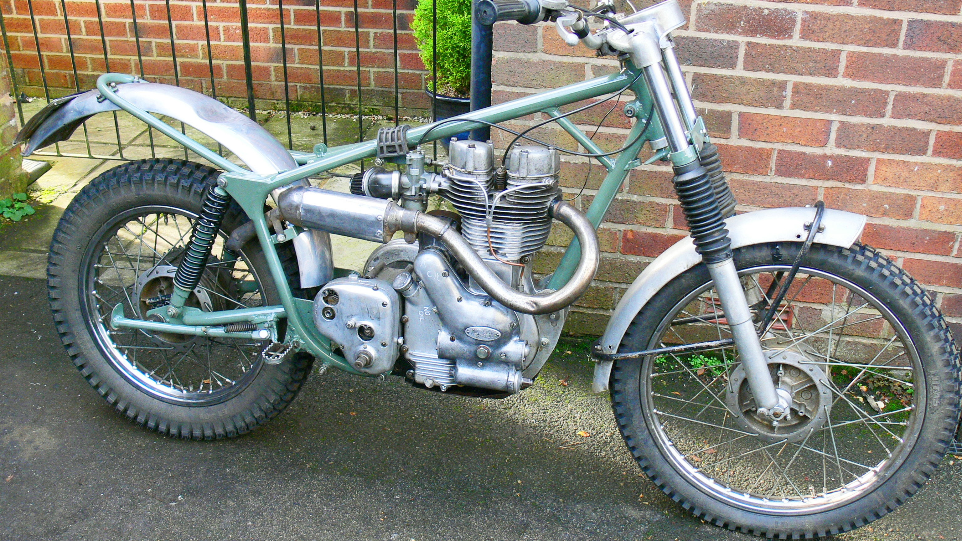

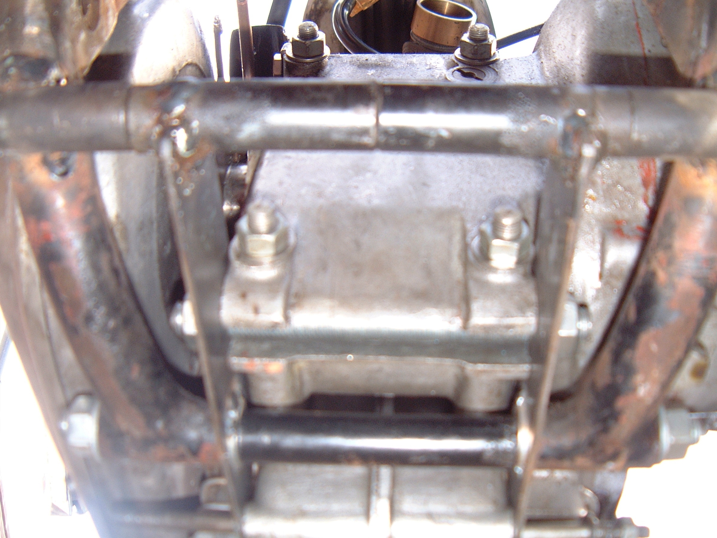

lakelandramblers Posted April 7, 2018 Report Share Posted April 7, 2018 1 Quote Link to comment Share on other sites More sharing options...
Prototype Posted April 8, 2018 Author Report Share Posted April 8, 2018 Thanks lot for the pictures .. Regards Quote Link to comment Share on other sites More sharing options...
