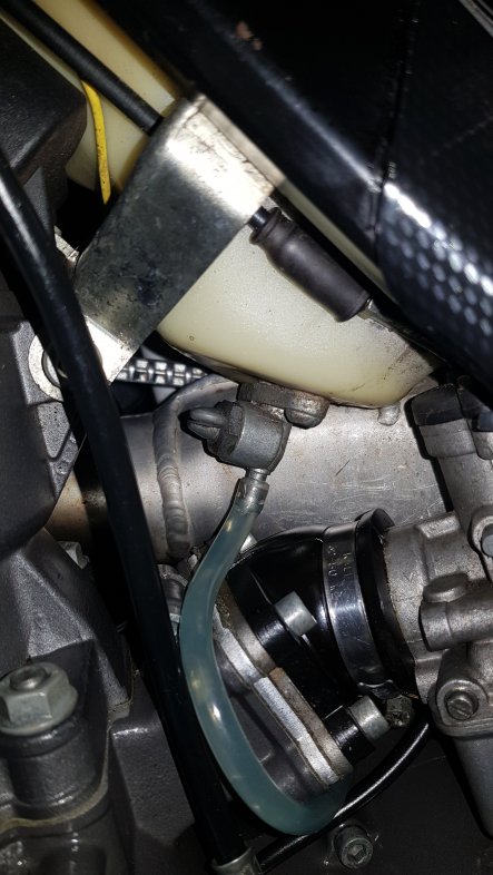

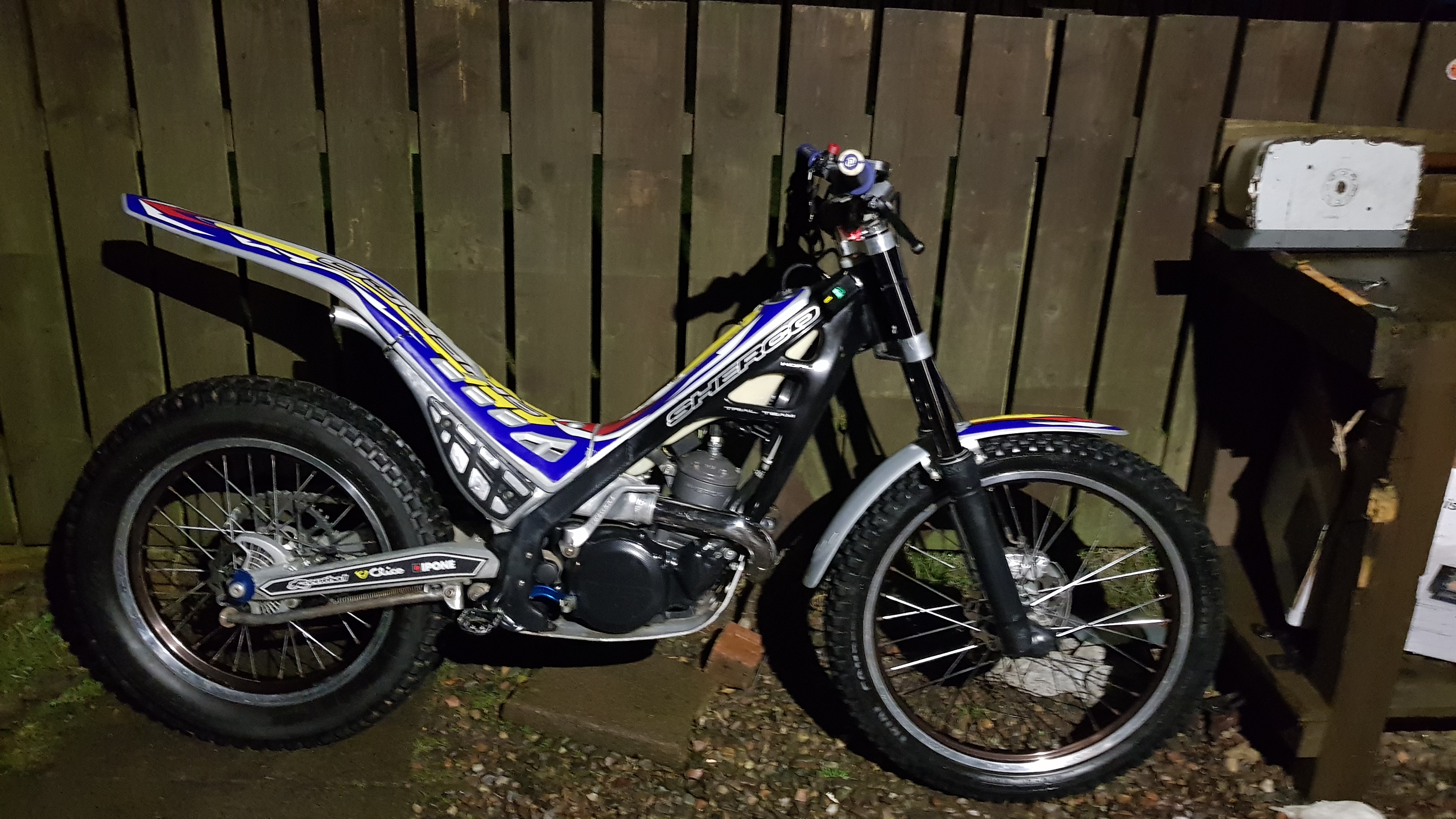

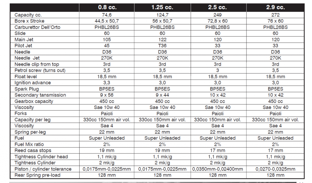

Brand0n Posted April 10, 2018 Report Share Posted April 10, 2018 Hi guys recently picked up my first bike 2007 sherco 250. I'm just looking for info( as pictued) which way is the fuel on and off. Assuming (on) is lever facing down? Also what's the correct gear box oil for this bike and how much. I can't seem to find this info online. Any info greatly appreciated, thanks all. Quote Link to comment Share on other sites More sharing options...
pauls320 Posted April 11, 2018 Report Share Posted April 11, 2018 Looks like your fuel valve is off in pic, down is on. https://www.lewisportusa.com/manuals/09sherco/2009_2T_owners.pdf Bike looks to like its in nice shape from pic 1 Quote Link to comment Share on other sites More sharing options...

copemech Posted April 11, 2018 Report Share Posted April 11, 2018 (edited) light gear oil, or use atf for a quicker clutch Edited April 11, 2018 by copemech 1 1 Quote Link to comment Share on other sites More sharing options...
pauls320 Posted April 13, 2018 Report Share Posted April 13, 2018 If you decide to use the motor oil..Dont use automotive motor oil as it has friction modifiers etc added, needs to be wet clutch specific motorcycle grade, MA, MA2. 1 Quote Link to comment Share on other sites More sharing options...
