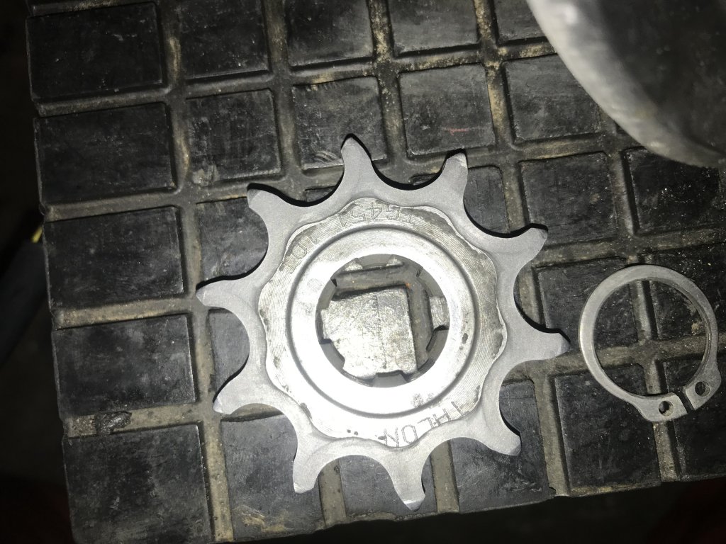

jackman290 Posted April 12, 2018 Report Share Posted April 12, 2018 I just ran into this while replacing the stator on my uncles 2003 290. His sprocket was so worn that I’m shocked it never piled into the crank case. We have a new sprocket on order and I’m hoping there’s no wear to the drive shaft splines. I would also think that the sprocket would wear before the harnened shaft, but won’t have an answer until I get the new sprockets! I will post an update once they come in, hopefully by this weekend. Here’s a pic of what his severely worn front sprocket. ?!! Quote Link to comment Share on other sites More sharing options...

jackman290 Posted April 15, 2018 Report Share Posted April 15, 2018 I just fitted the new Talon front sprocket to my uncles 290, and it still has some wobble/play to it. It sounds like that's just the norm from the replies above, the shaft isn't warn on this one. Quote Link to comment Share on other sites More sharing options...

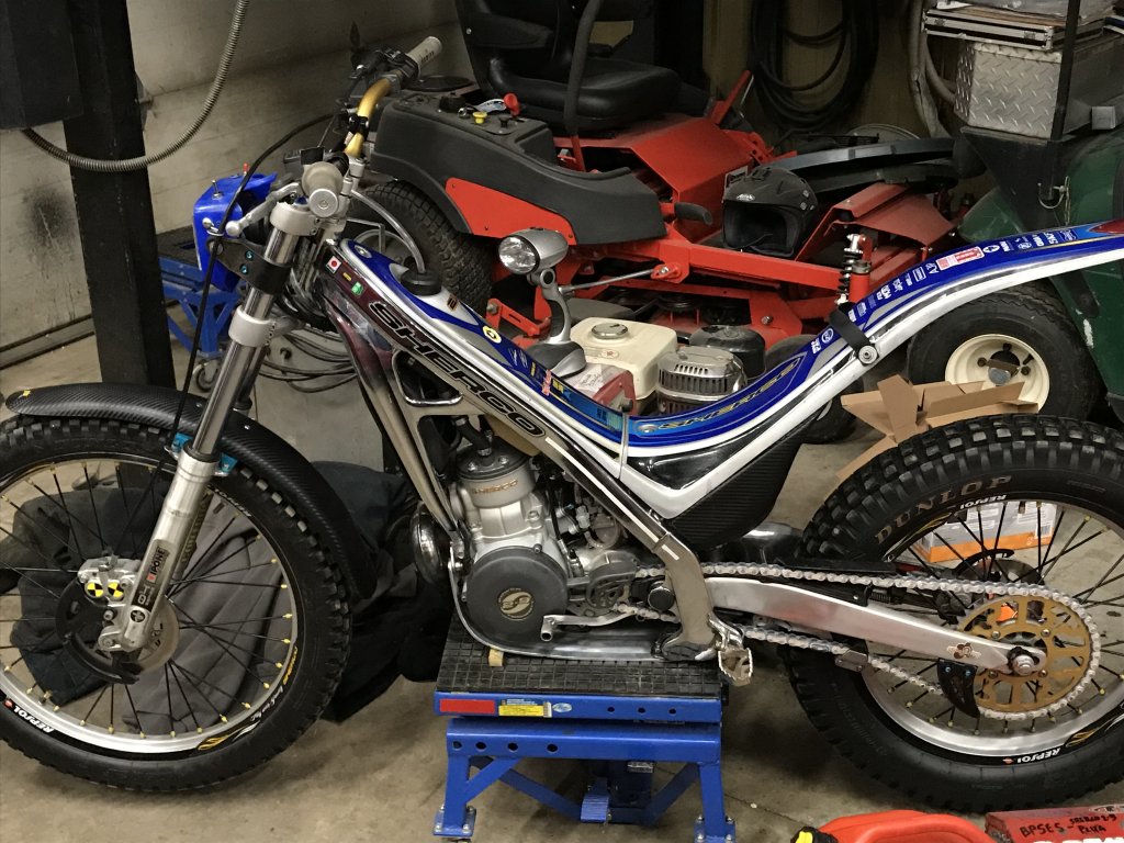

jackman290 Posted April 16, 2018 Report Share Posted April 16, 2018 Here’s a shot of it with the new chain and sprockets. I wrapped the front fender with some 3m carbon fibre I had laying around because the original had some serious bend-marks/creases. The heat gun is key. Timed the new stator with a timing light and she fired up on the first kick She’s like a new bike again (it actually looks nicer than my 2015 lol) The drive sprocket still has some wobble play to it, but it’s hardly noticeable once the chain is installed and tensioned. The next big plan for this bike is an engine rebuild due to play in the main bearings/connecting rod. (Followed by new tires) 1 Quote Link to comment Share on other sites More sharing options...
tony27 Posted April 16, 2018 Report Share Posted April 16, 2018 I see it's a Jarvis replica like mine, these were the last that they made. The tank & guard graphics aren't available anymore so I'd suggest getting rid of the rear bolts & running cable ties to allow the guard to unclip in the case of a step off. It was 1 of the first things I did when I got mine new & it has definitely saved me quite a bit of money 1 1 Quote Link to comment Share on other sites More sharing options...
jackman290 Posted April 16, 2018 Report Share Posted April 16, 2018 Fantastic idea, I will heed this advice! I had a hard time getting the tank back on (over the wire harness and CDI stuff), so I heated the bottom of the tank with a heat gun and it now fits without stressing any components underneath ? Quote Link to comment Share on other sites More sharing options...
