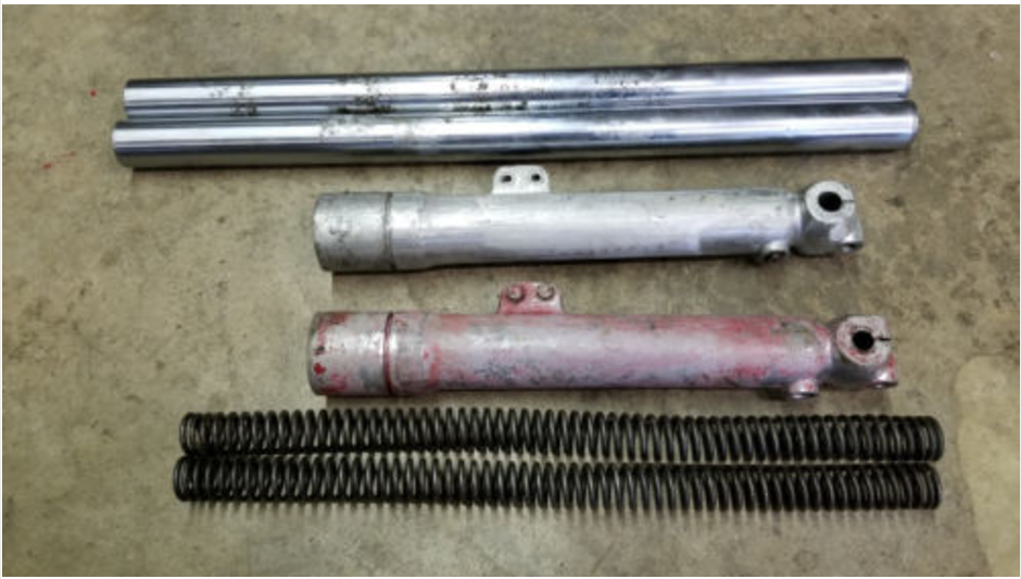

bsacad Posted April 25, 2018 Report Share Posted April 25, 2018 I have a set of Betor forks from a Sherpa on a vintage flat track bike I'm building. A friend has offered me some Pursang lowers with the in-line axle which would be better for racing. I was wondering if it is possible to swop the stanchions and internals from my Sherpa forks to the Pursang lowers? The length will be adjusted anyway so that is not a consideration at the moment. Sorry, I know this is trials forum but it seems the most knowledgeable about Bultaco forks that I have found. Any help much appreciated. Caddy Quote Link to comment Share on other sites More sharing options...

feetupfun Posted April 30, 2018 Report Share Posted April 30, 2018 The in-line axle 35mm Pursang forks I inspected today have taper-top fork tubes which means they are from a Pursang that was made before they went to a clamp-type top triple clamp design which happened around 1972 from memory. The Pursang sliders are the same internally as leading-axle Alpina/Sherpa T/Matador fork sliders of the same era. 1 Quote Link to comment Share on other sites More sharing options...
bsacad Posted April 30, 2018 Author Report Share Posted April 30, 2018 Thanks for the reply. These are the ones I was looking at. They seem to be a slightly different model.... Quote Link to comment Share on other sites More sharing options...
