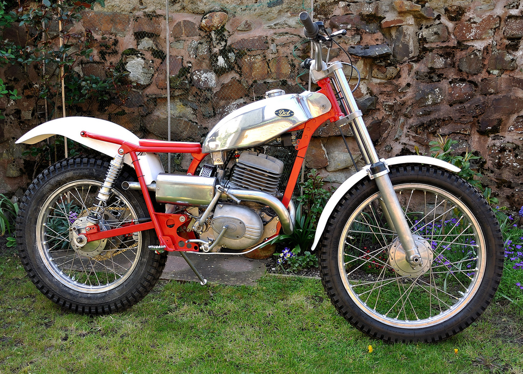

greevesrob Posted April 28, 2018 Report Share Posted April 28, 2018 Hi all After riding my greeves a couple of pre65 events and not doing to bad iam considering options to improve the bike. The problem is the hubs they are the full width bhc 1s good looking but very heavy on the rear and the brakes dont work that well. After speaking to other people brand new 1s from gerry seem to be the way to go but didnt really want to go for new i would prefer the grimeca hubs that wiggy put in the dots he made but would it be scottish legal on a greeves. Any thoughs? Quote Link to comment Share on other sites More sharing options...
b40rt Posted April 28, 2018 Report Share Posted April 28, 2018 Gerry's hubs are cub replica's, Grimeca's aren't Scottish legal on a British manufactured bike. 1 Quote Link to comment Share on other sites More sharing options...
greevesrob Posted April 28, 2018 Author Report Share Posted April 28, 2018 I know gerrys hubs are cub reps but some of the dots in scotland will have grimeca hubs from a fantic in them as all the 1s built by john bull and wiggy have so i was thinking of them instead of new cub reps but if they are a gray area then there no point Quote Link to comment Share on other sites More sharing options...
scottishsteve Posted April 28, 2018 Report Share Posted April 28, 2018 Speak to Gerry I'm in the same position. Can't use 19??but it's ok to use 2017 hubs. Gerry does a good job. Quote Link to comment Share on other sites More sharing options...
teamferret Posted April 29, 2018 Report Share Posted April 29, 2018 I never found the original DOT hubs any better or noticeably lighter that the Greeves (British Hub) full width ones. If you have oversized linings bonded onto the shoes and then machine them to the brake diameter they will work fantastic when dry. The alloy bantam hubs are very nice and light and have the advantage that the rear hub has the brake plate on the correct side for the brake pedal, but they ain't cheap. Quote Link to comment Share on other sites More sharing options...
