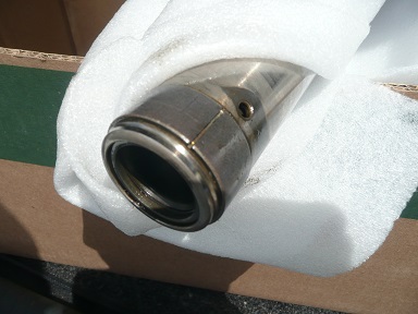

slip_kid Posted June 7, 2018 Author Report Share Posted June 7, 2018 I know the part is not shown and it likely is designed to last as long as the bike is expected to last . . . one season of competition? It does not look to show as much wear as the guide bushings (different material) so it's not as much a worry, but here's a photo just the same. My next concern is the headstock bearings. What are people using as replacements?? Quote Link to comment Share on other sites More sharing options...
