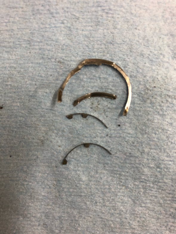

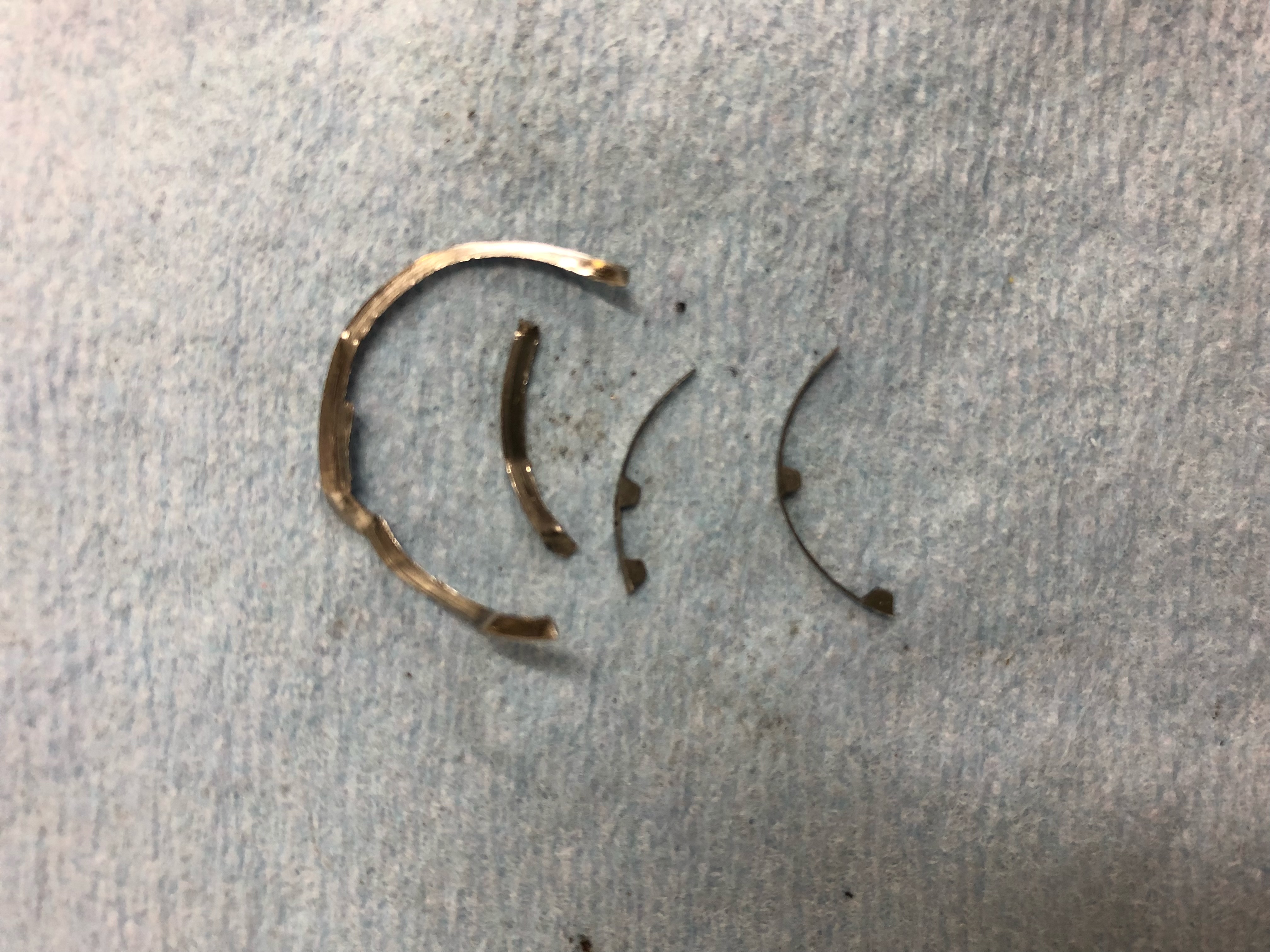

Jhb57 Posted June 18, 2018 Report Share Posted June 18, 2018 Hi guys Hoping you can help me out! I changed the oil in my 2016 evo factory yesterday, and as I was putting the sump back in I noticed some swarf poking out the sump. Using the magnet I fished out all I can, there was no sign of anymore but now I’m a bit unsure what to do! From my motocross days i’d Split the engine no questions asked, but strangely the gearbox feels absolutely fine, In fact I only put 500ml of oil in this time rather than 550 and it feels the best it’s ever been. It also didn’t miss a beat Sunday. I have no idea when the part broke but I’m reluctant to split the engine as I can’t find anything wrong with the bike! I’ve looked at the parts diagram and I can’t see anything resembling what I’ve found. Has anyone experienced anything like this before? Or does anyone recognise the chewed up parts? Planning on riding it Wednesday and seeing how it goes... Thanks in advance Quote Link to comment Share on other sites More sharing options...

lineaway Posted June 18, 2018 Report Share Posted June 18, 2018 Looks like part of a bearing cage. Bite the bullet and split the cases. Quote Link to comment Share on other sites More sharing options...

reggie Posted June 18, 2018 Report Share Posted June 18, 2018 I suspect it is one of the following part numbers, these parts are in the gearbox 007041100 000 or 2773860 000 or 2773870 000 it would appear that the cases will need to be split. Good luck Quote Link to comment Share on other sites More sharing options...
stpauls Posted June 19, 2018 Report Share Posted June 19, 2018 That's not swarf, that's part of a component. Quote Link to comment Share on other sites More sharing options...
Jhb57 Posted June 20, 2018 Author Report Share Posted June 20, 2018 Thanks guys,reggie they’re exactly the parts I was thinking. The engine is now on the work bench I couldn’t leave it, hopefully split the cases tomorrow and find out the issue! Quote Link to comment Share on other sites More sharing options...
Jhb57 Posted June 24, 2018 Author Report Share Posted June 24, 2018 FYI, it was one of the parts reggie mentioned, just a little washer. Just got to build the top end back up and put it in the bike now, thanks for your help! Quote Link to comment Share on other sites More sharing options...
