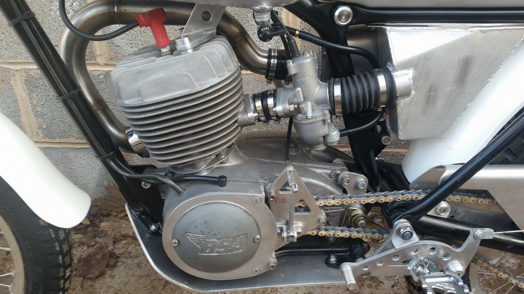

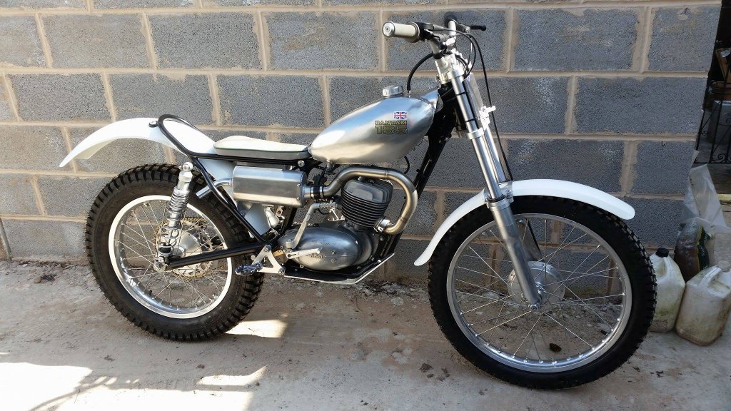

old trials fanatic Posted June 20, 2018 Report Share Posted June 20, 2018 6 3 Quote Link to comment Share on other sites More sharing options...

turbohead Posted June 21, 2018 Report Share Posted June 21, 2018 And what Bantam you have there! Please, give us all details of frame, wheels, suspension, engine spec and so on! (just thinking of starting a first D1 build myself, while I am getting used to trial for the second time in my life, now retired and riding an '81 SWM 320 .....) 1 Quote Link to comment Share on other sites More sharing options...
old trials fanatic Posted June 21, 2018 Report Share Posted June 21, 2018 50 minutes ago, turbohead said: And what Bantam you have there! Please, give us all details of frame, wheels, suspension, engine spec and so on! (just thinking of starting a first D1 build myself, while I am getting used to trial for the second time in my life, now retired and riding an '81 SWM 320 .....) Rob Homer frame. Hubs from Alan Whitton Racing billet aluminium Bantam copies with alloy back plates. Morad rims stainless spokes laced by myself. Suspension revalved Betor units. Engine is modified D14/4 with alloy barrel and custom casting one off head reworked crank and flywheels with PVL ignition and brass additional weight from Jim Pickering. Modified Yamaha clutch from Harry Stanistreet. Modified outer cases. Lower 2nd and 3rd gears from Jim Pickering. Smaller engine crank sprocket. Self built exhaust and silencer. Marzocchi forks in Norton sliders. Alloy and titanium spindles. Modified Billet alloy yokes etc etc etc Loads more but its an ongoing project. Not as trick as some. 2 Quote Link to comment Share on other sites More sharing options...
jimmitchell Posted June 21, 2018 Author Report Share Posted June 21, 2018 On 20/06/2018 at 6:50 PM, old trials fanatic said: Many thanks for all replies, especially to otf. Thanks for the photos of a lovely looking bike - was that one of the Bantams up at Kinlockleven some weeks past? jim Quote Link to comment Share on other sites More sharing options...
old trials fanatic Posted June 22, 2018 Report Share Posted June 22, 2018 23 hours ago, jimmitchell said: No mate but very similar Quote Link to comment Share on other sites More sharing options...
