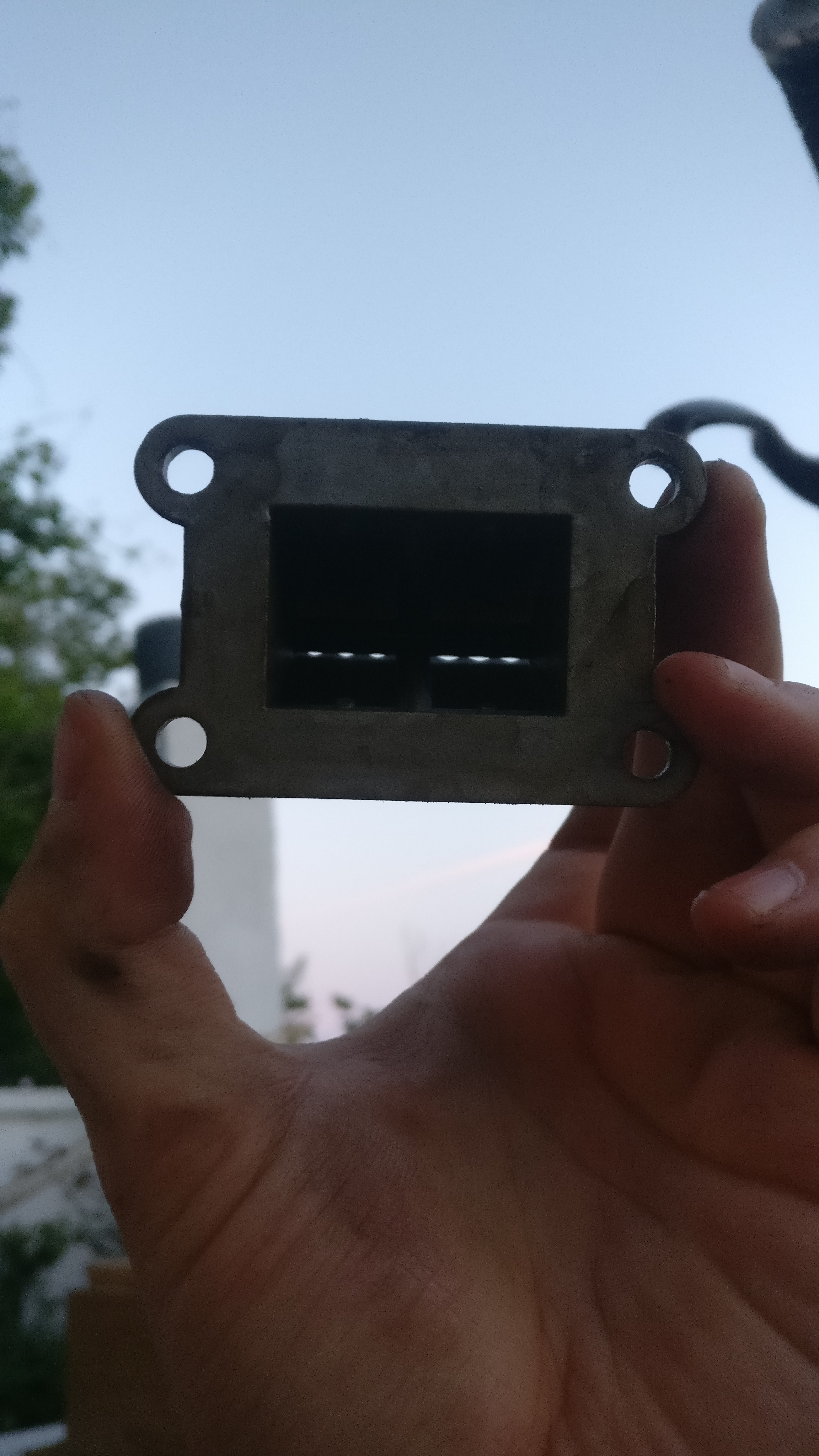

mlcjot Posted June 22, 2018 Author Report Share Posted June 22, 2018 Pulled the reed block. The bottom pair have quite a bit of light showing through. The top pair are closed. Is this normal? Cheers Quote Link to comment Share on other sites More sharing options...

mlcjot Posted June 22, 2018 Author Report Share Posted June 22, 2018 trapezeartist: Yep I'm not too concerned about the clutch drag! Totally liveable. Nebulous: The reeds all look fine. I'm not familiar with 2 strokes really, so am unsure if the reeds should always be slightly open, or if this is a fault. copemech: I'll revisit the fuel screw when I get back to the bike. Good point about the heavy flywheel, makes sense! Should the reeds always be slightly open? For engine idle speed perhaps? Thanks! Quote Link to comment Share on other sites More sharing options...
copemech Posted June 23, 2018 Report Share Posted June 23, 2018 5 hours ago, mlcjot said: trapezeartist: Yep I'm not too concerned about the clutch drag! Totally liveable. Nebulous: The reeds all look fine. I'm not familiar with 2 strokes really, so am unsure if the reeds should always be slightly open, or if this is a fault. copemech: I'll revisit the fuel screw when I get back to the bike. Good point about the heavy flywheel, makes sense! Should the reeds always be slightly open? For engine idle speed perhaps? Thanks! reeds may not seal perfectly , yet when under backpressure they will ! it needs more fuel, most all dellortos run maxed at 3.5 turns Quote Link to comment Share on other sites More sharing options...
mlcjot Posted June 23, 2018 Author Report Share Posted June 23, 2018 (edited) Nebulous: I appreciate your frustration on my account, but really I love the discovery and the learning and I've had so much helpful input since I posted here two days ago. I'm finding the trials community to be very helpful and welcoming! Thank you That video suggests that I should replace the reeds, I'll verify correct float height and put it back together for a test run, and then look at ordering some reeds. copemech: Roger that, I'll be winding out the fuel screw when next starting her up. Thanks! I found a Spanish website that seems to have old parts in stock, has anyone had any experience with www.endurorecambios.com? Have a great weekend. The sun is shining in south-west Ireland! Edited June 23, 2018 by mlcjot Quote Link to comment Share on other sites More sharing options...
section swept Posted June 23, 2018 Report Share Posted June 23, 2018 (edited) The reed valves should be closed with no gaps that you can see daylight through. Initially remove reed valve and ensure it’s not bent or distorted. Refit carefully to the block. Have you made sure the throttle slide can move freely up and down? By the sound of the engine and the age I would be looking to change those crankcase oil seals anyway, lube the lips of the new ones with either 2T oil or silicon grease sparingly if you will, the seals allow crankcase compression to escape taking with it some of the fuel and air, on revving up and then shutting down the seals allow air to be sucked into the crankcase which lets the engine run too fast for too long back down to idle. While you’re in there you can check the main bearings for excess carbon which does get in and cause frictional losses and eventually failure. From the sound of the engine on the video it is ok ? mechanically, but it’s easy to make sweeping statements. By doing the work you will become more confident in the bike and know your way around so if it stops miles from anywhere you may have a chance of fixing it.? Edited June 23, 2018 by section swept Quote Link to comment Share on other sites More sharing options...
