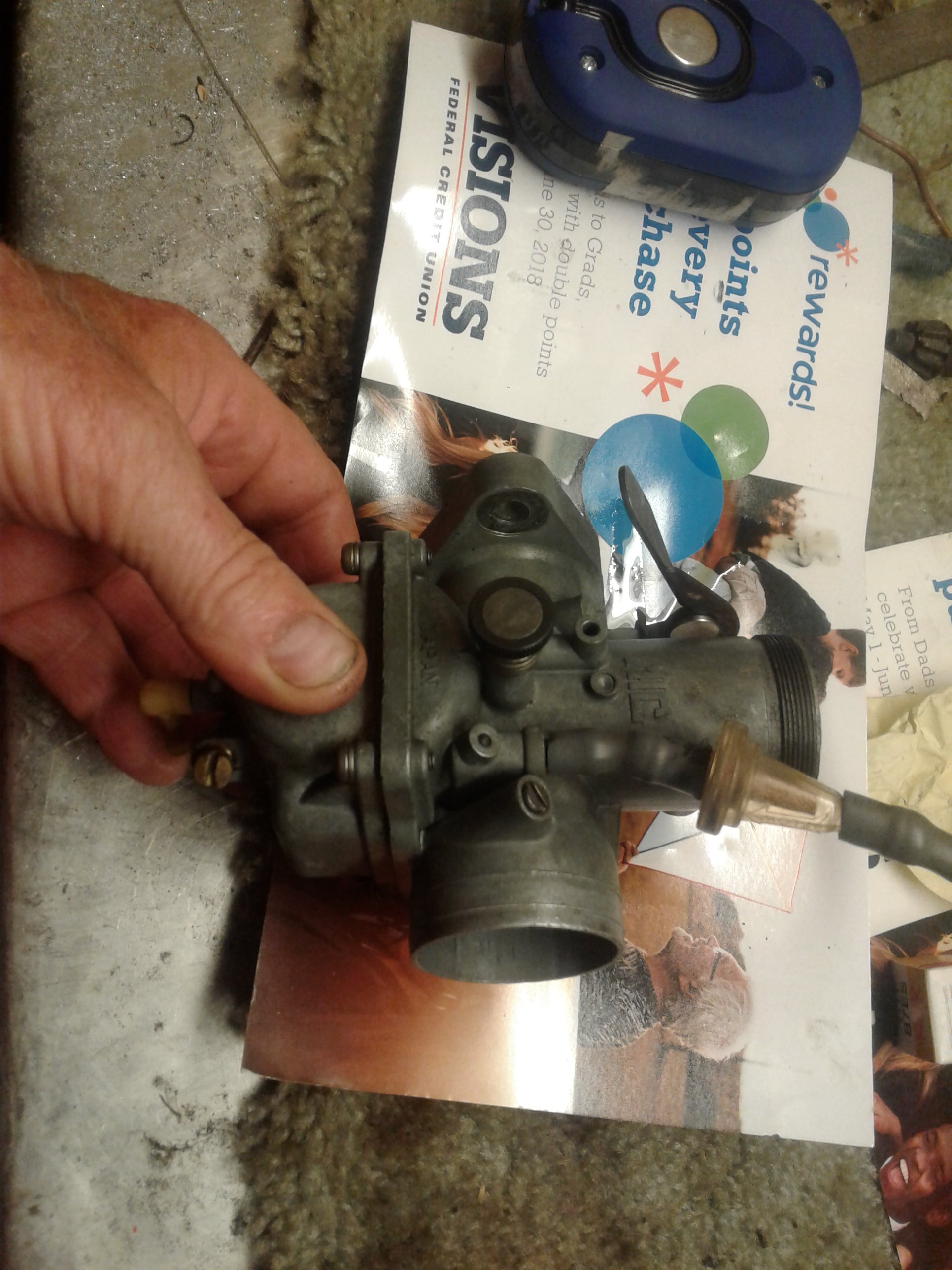

Snowman56 Posted June 28, 2018 Report Share Posted June 28, 2018 Hi, I recently bought a 1975 Suzuki RL250. It ran but not well. I found that the main jet was plugged. After carefully cleaning it out and blowing it dry with compressed air, I reassembled the carb, gassed it up and it started easily. It runs for a while but looses power in a couple minutes and then stalls. it will not restart until it cools down. Any suggestions as to how to adjust the carb? It has a 130 main jet. I'm running modern synthetic oil at 40:1. Quote Link to comment Share on other sites More sharing options...
Snowman56 Posted June 29, 2018 Author Report Share Posted June 29, 2018 Thanks, I'll check those out. I understand that a 140 main jet was std and I have a 130. But like I said in the original post, the bike runs worse now than before when the main jet was plugged with debris. Quote Link to comment Share on other sites More sharing options...

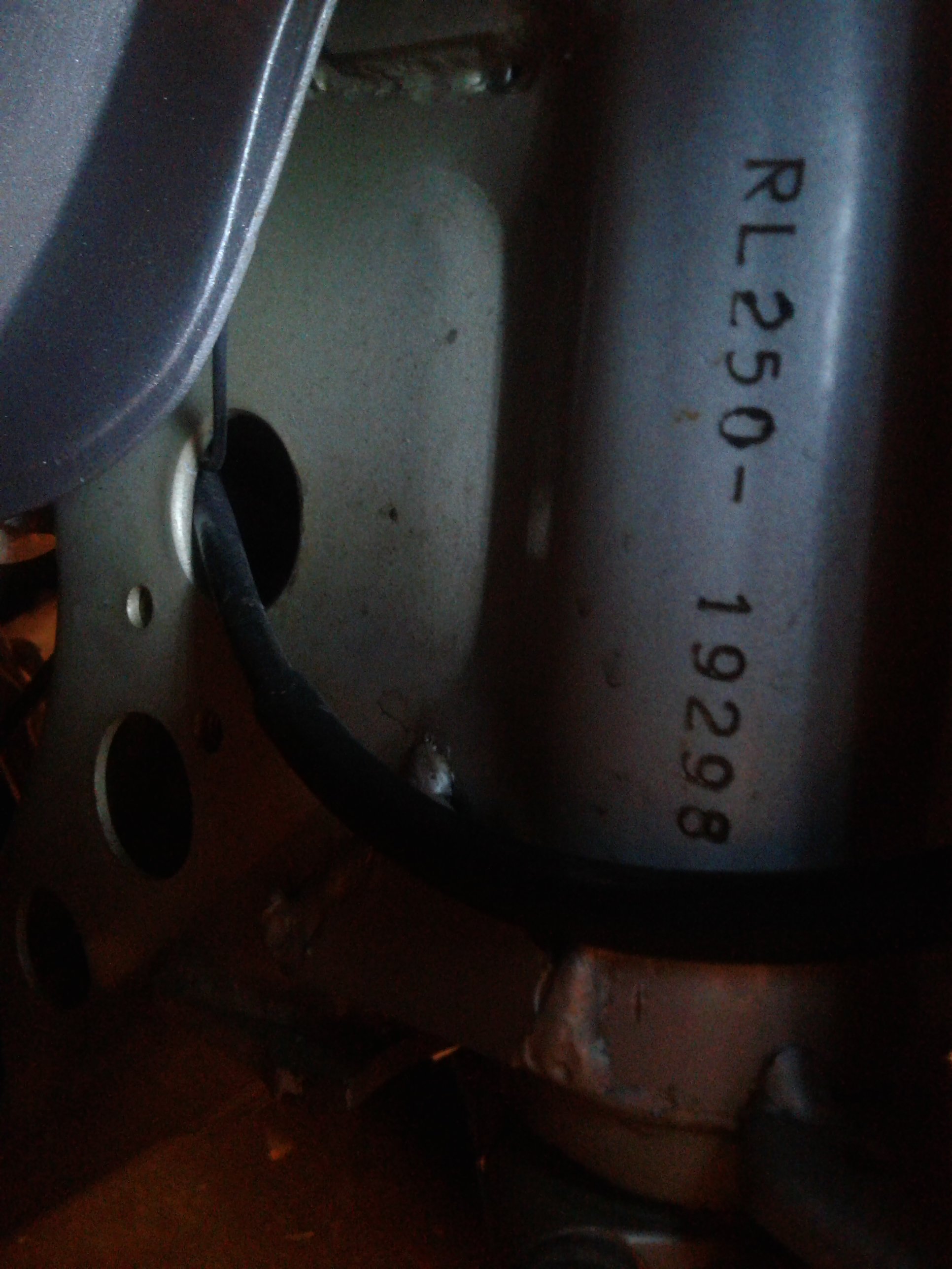

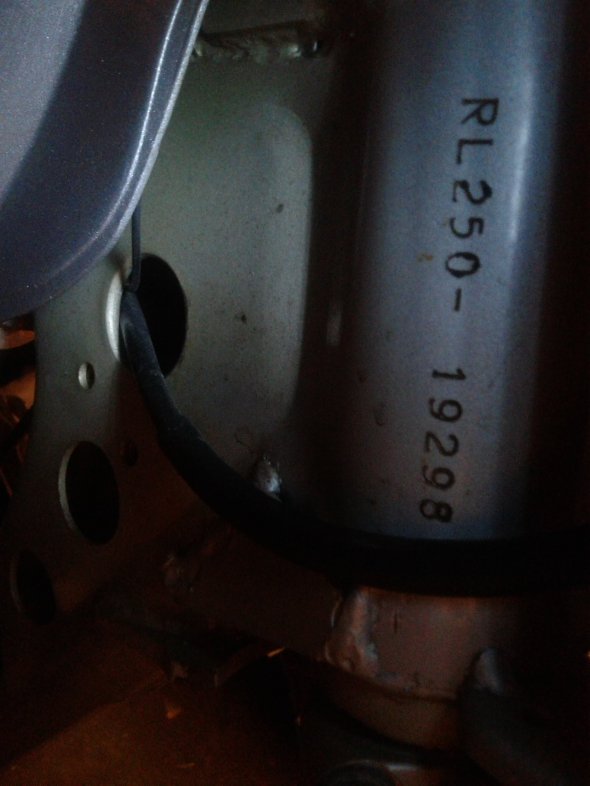

Snowman56 Posted June 29, 2018 Author Report Share Posted June 29, 2018 I'm actually unsure of the year. frame number is RL250-19298. pls see pics. Quote Link to comment Share on other sites More sharing options...
Snowman56 Posted June 29, 2018 Author Report Share Posted June 29, 2018 Thanks, so I guess my bike is a 1975. Quote Link to comment Share on other sites More sharing options...
