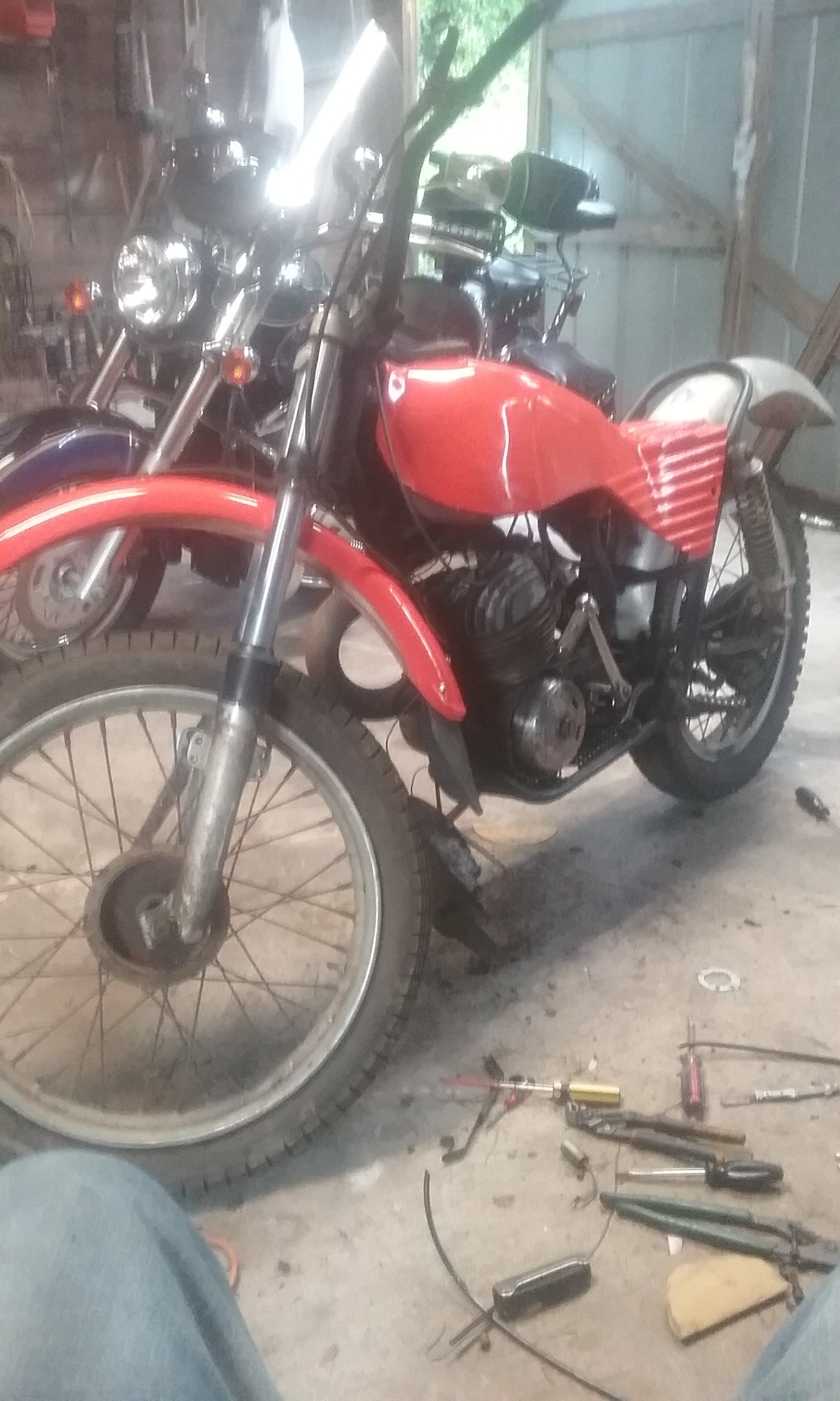

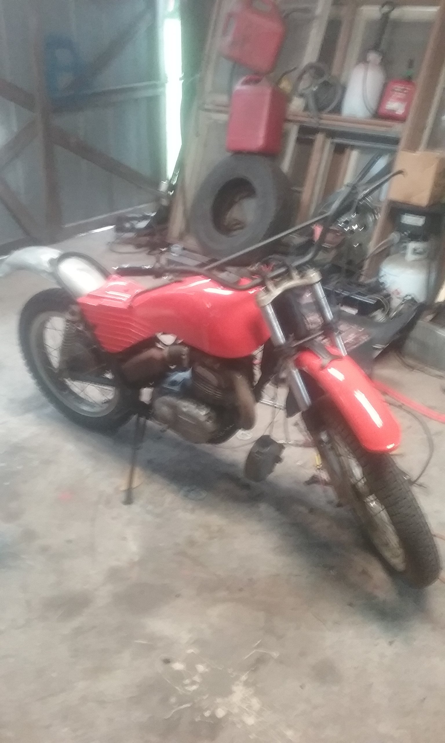

Art Posted June 28, 2018 Report Share Posted June 28, 2018 When I try to start it, it don't eventry to start not even with starting fluid I cleaned spark plug and points but still nothing? Anybody got any suggestions I would sure begrateful I'll post couple of pics Quote Link to comment Share on other sites More sharing options...
Art Posted June 28, 2018 Author Report Share Posted June 28, 2018 I don't no the year or nothing when I put the number off motor which starts with M and the number off bar under handle bars which is the same number it just starts with B I get nothing Quote Link to comment Share on other sites More sharing options...
lineaway Posted June 29, 2018 Report Share Posted June 29, 2018 Install a new condenser. The body to the frame (So it is grounded) mount it by the coil under the tank. Just splice it into the black wire going to the coil. Sure beats pulling the flywheel off! 1 Quote Link to comment Share on other sites More sharing options...
