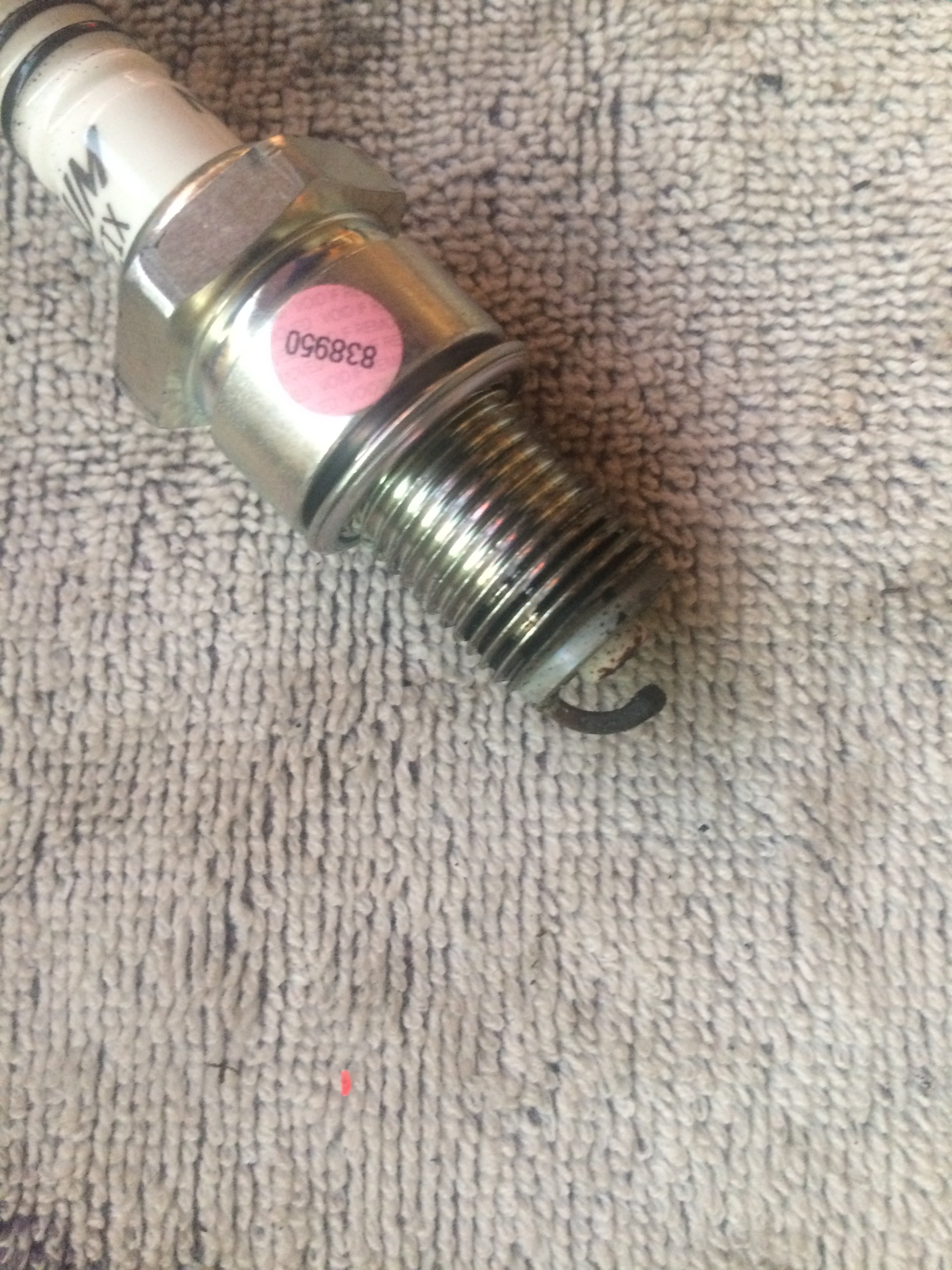

barfy Posted July 9, 2018 Author Report Share Posted July 9, 2018 (edited) Thank you @pauls320. Next time I disassemble the carb I’ll take out the never tamper block. I have some tamper proof torque keys. Also I’ll order some new gaskets because they seem quite cheap. I’ve just put it all back together, resealing the inlet and it seemed to be running fine. I also put in a fresh plug to pull it out to see what it looked like for mixture. I thought I’d give it a quick blast up the road where it stopped on me after about 1/2 mile. Then restarted second kick. When I got back I stopped the bike and pulled out the plug. Hopefully I’ve attached a photo to show that it’s running very weak and blown the electrode. It was about 1/2 to 3/4 throttle when it stopped so might indicate I need a bigger main jet but I’ve never seen a plug with a blown electrode. Edited July 9, 2018 by barfy Quote Link to comment Share on other sites More sharing options...
pauls320 Posted July 9, 2018 Report Share Posted July 9, 2018 Barfy, I do not recommend removing the jet block...only as a last resort after finding you have a leakage problem with it. It can be a pain to seal...and Keihin do not sell the seals/gaskets individually, they tell you to buy a whole new carb . Looks like a little detonation there, air leak, jetting, fuel. how much oil in fuel...too much and it gets lean...fuel displaced by oil....Good luck Quote Link to comment Share on other sites More sharing options...
barfy Posted July 9, 2018 Author Report Share Posted July 9, 2018 @pauls320 Thanks for the advise about the jet block. I’ll see if I can blow it out best I can with the airline, if there is any contamination. There is a dealer in Chesterfield, Derbyshire, England that does all of the gaskets for the PWK and they’re only a few ££. I’ve ordered them this evening. I run the oil at about 90:1 on 98 octane pump fuel, normally BP. I’ve ordered some new plugs at the same time as the gaskets. Quote Link to comment Share on other sites More sharing options...

barfy Posted July 11, 2018 Author Report Share Posted July 11, 2018 Chatting to someone today about why a plug would burn out the electrode and he said he’d only seen it before when the timing was far too advanced. The timing is fixed by the flywheel pickup and CDI isn’t it? Quote Link to comment Share on other sites More sharing options...
