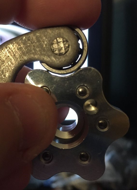

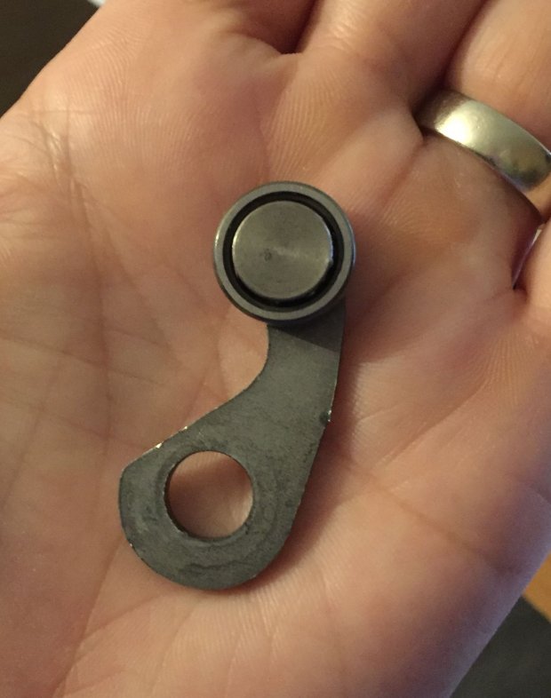

dan williams Posted July 25, 2018 Author Report Share Posted July 25, 2018 Well I got my spare parts to experiment with and already have some interesting observations. First is the finish on the cam follower arm is lousy. It's merely stamped out and not de-burred at all. This could lead to the follower not, er, following if it gets stuck on its burrs. Second, I think Beta used too large a bearing. The picture shows that not only is the bearing not seating all the way in the cam notch but there are two contact points which is not correct as they will try to move the bearing in different directions on the initial movement of the shifter causing wear on the cam. The other thing that is obvious is the shifter action starts ~2/3 of the way up the cam. My suspicion is that the design is correct and somebody got a good deal on 16mm bearings so that's what they used figuring it was close enough. I have to think about this a bit more, contact angle and slope/force calculations but I think this is easily improved. Quote Link to comment Share on other sites More sharing options...

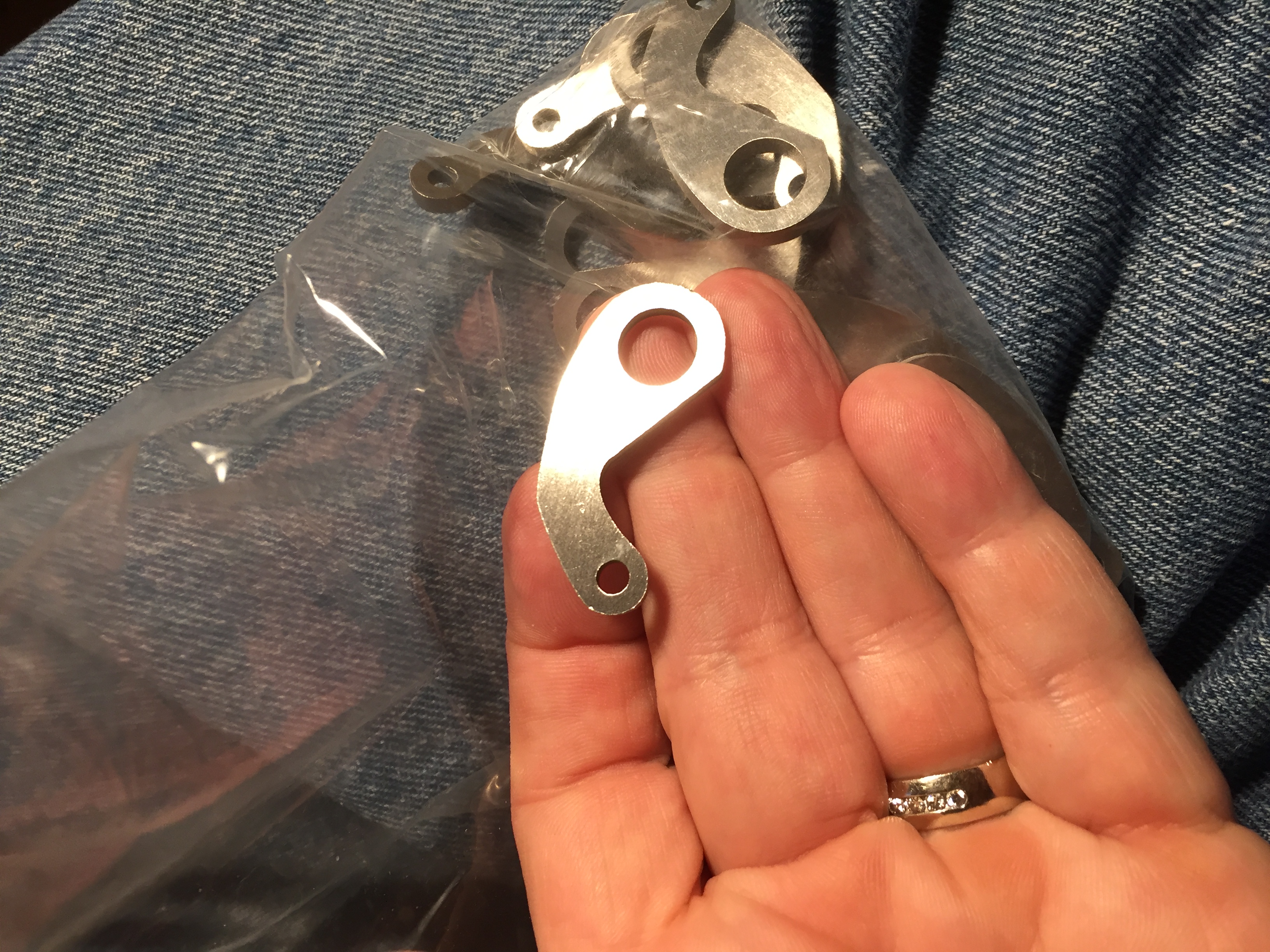

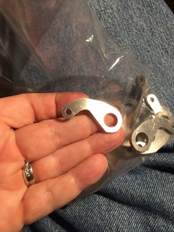

dan williams Posted July 29, 2018 Author Report Share Posted July 29, 2018 Let the prototyping begin. Rendering of the cam arms I'm having made. I'll fit this with 11mm bearings instead of the 16mm bearings. What could go wrong? I love emachineshop. I can design a part and see it made real in a few weeks without breaking the bank. 1 Quote Link to comment Share on other sites More sharing options...

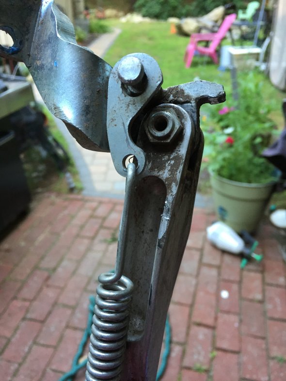

dan williams Posted July 29, 2018 Author Report Share Posted July 29, 2018 So while I’m waiting for parts to experiment with I wanted to tighten the kick stand which is, as always, loose. So I take it off to have a look and..... Quote Link to comment Share on other sites More sharing options...
dan williams Posted July 29, 2018 Author Report Share Posted July 29, 2018 Anything look familiar? Quote Link to comment Share on other sites More sharing options...
heffergm Posted July 29, 2018 Report Share Posted July 29, 2018 Maybe they put the wrong one in your gearbox... Although I guess if they're identical, no harm done. Quote Link to comment Share on other sites More sharing options...
guy53 Posted July 30, 2018 Report Share Posted July 30, 2018 You have to give them credit, it's kind of one part fits all Guy Quote Link to comment Share on other sites More sharing options...
dan williams Posted July 30, 2018 Author Report Share Posted July 30, 2018 “I don’t get it Luigi, We never have enough of these cam follower arms!” Luigi, who assembles the kick stands, quietly snickers. 1 Quote Link to comment Share on other sites More sharing options...
dan williams Posted August 1, 2018 Author Report Share Posted August 1, 2018 Ooooo more experimental parts are in. Quote Link to comment Share on other sites More sharing options...
