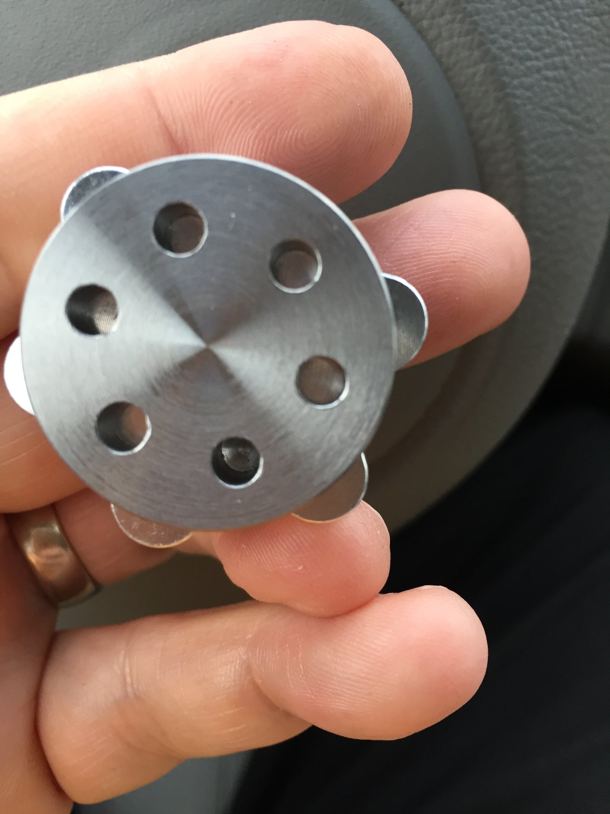

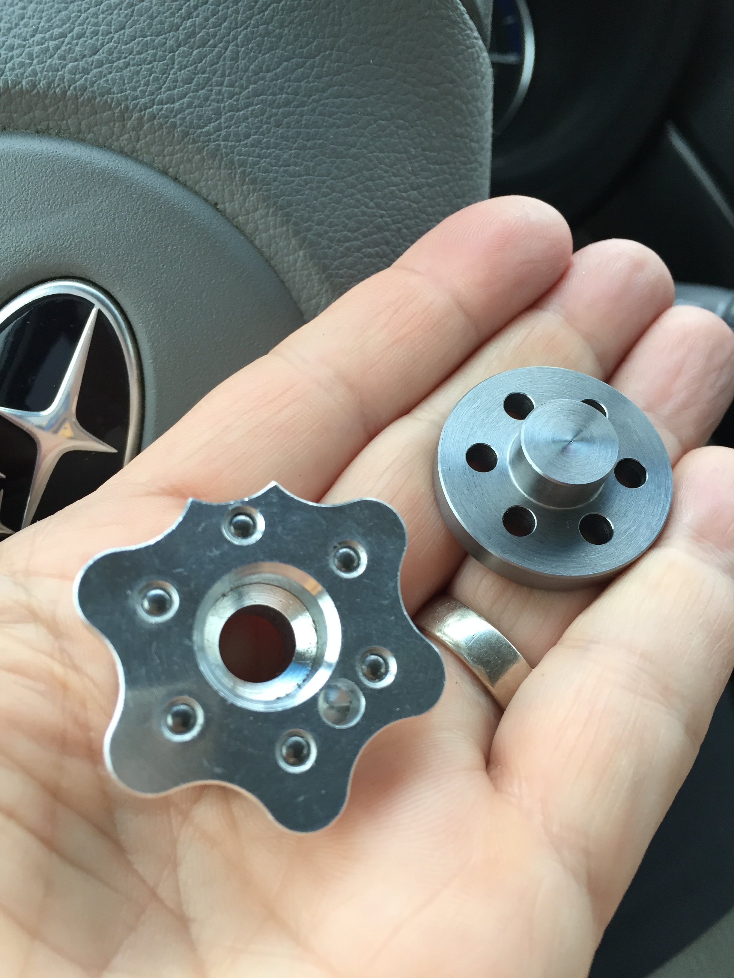

dan williams Posted December 26, 2018 Author Report Share Posted December 26, 2018 My jig for making alignment holes to place the neutral between any two gears is in. I think I’ll try setting neutral between fourth and fifth to start with. Quote Link to comment Share on other sites More sharing options...
dan williams Posted December 28, 2018 Author Report Share Posted December 28, 2018 The jig is in and fits like it was made for this. Which it was. Let the fettling begin! Quote Link to comment Share on other sites More sharing options...
