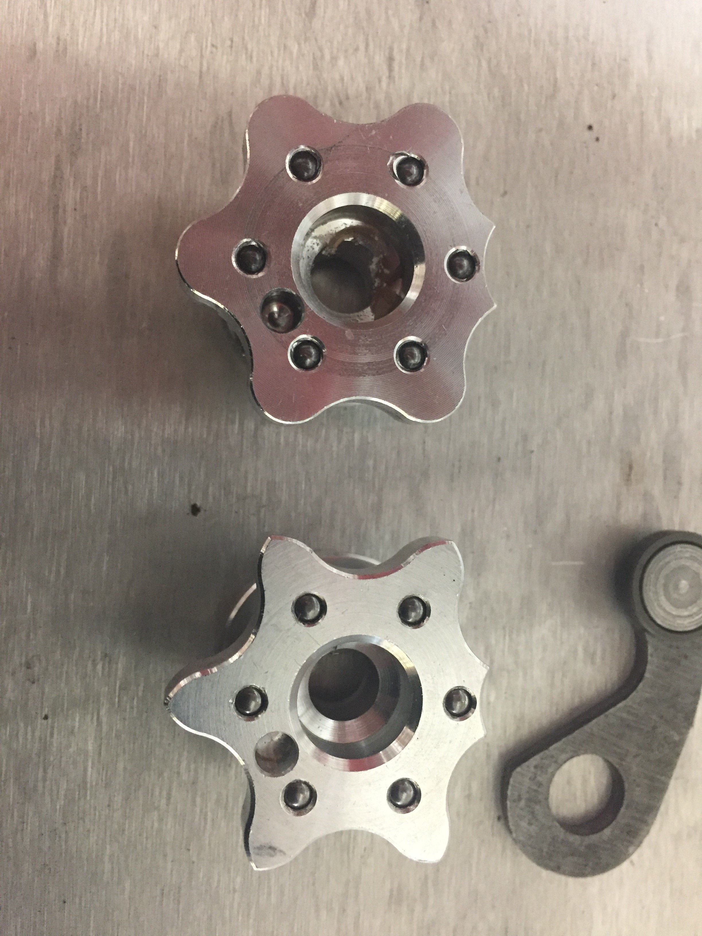

Beta rev'3 Posted November 11, 2018 Report Share Posted November 11, 2018 I've got a 2019 been out a few times on it and today it came out of 2nd on its own a few times....after coming off an 06 that was absolutely bullet proof i'm starting to wish i'd tried a different brand... 1 1 Quote Link to comment Share on other sites More sharing options...
dan williams Posted November 13, 2018 Author Report Share Posted November 13, 2018 On 11/11/2018 at 1:09 PM, Beta rev'3 said: I've got a 2019 been out a few times on it and today it came out of 2nd on its own a few times....after coming off an 06 that was absolutely bullet proof i'm starting to wish i'd tried a different brand... That's not encouraging since you should have the new cam. Quote Link to comment Share on other sites More sharing options...
Beta rev'3 Posted November 13, 2018 Report Share Posted November 13, 2018 It's behaved today and stayed in gear, it definitely feels like a challenge trying to find neutral and the petrol cap does me in, that had me cossing a fair bit ? Quote Link to comment Share on other sites More sharing options...
lineaway Posted November 13, 2018 Report Share Posted November 13, 2018 (edited) The bike is not supposed to find nuetral easily when running. Not fixing the fuel cap is just crazy of them. Edited November 13, 2018 by lineaway Quote Link to comment Share on other sites More sharing options...
thesolidman1 Posted November 14, 2018 Report Share Posted November 14, 2018 I put the new updated gear cam in my 2016. It has popped out of gear. Only once so far though. I have friends with 2018 Factory's and their bikes pop out of gear. "Popping out of gear", in this case, is the same as "Popping into neutral". If you look at the updated cam vs the original design, there is nothing changed to make it harder to go into neutral. Quote Link to comment Share on other sites More sharing options...
lineaway Posted November 14, 2018 Report Share Posted November 14, 2018 Popping out of gear must be caused by all those expensive name brand oils. DexIII and I don't even have the folding tip on my lever. I only have missed 1 shift all year and it never has popped out of gear. Quote Link to comment Share on other sites More sharing options...
Beta rev'3 Posted November 15, 2018 Report Share Posted November 15, 2018 Yes I get it shouldn't find neutral easily when in gear I was just comparing it to my old 06 which never came out of gear but was a lot easier to find neutral on. I did toy with the oil Idea after its first oil change I put Putoline GP10 in it, I've ordered some of the recommended in the manual and will try that to compare it Yes the Petrol Cap is a chuffin Joke... Quote Link to comment Share on other sites More sharing options...
dan williams Posted December 2, 2018 Author Report Share Posted December 2, 2018 I finally got around to ordering the hole jig from emachineshop that will let me put neutral between any two gears. Hopefully I got the dimensions close enough. It should come in end of December. Quote Link to comment Share on other sites More sharing options...
dan williams Posted December 2, 2018 Author Report Share Posted December 2, 2018 On 11/14/2018 at 10:35 AM, thesolidman1 said: I put the new updated gear cam in my 2016. It has popped out of gear. Only once so far though. I have friends with 2018 Factory's and their bikes pop out of gear. "Popping out of gear", in this case, is the same as "Popping into neutral". If you look at the updated cam vs the original design, there is nothing changed to make it harder to go into neutral. It is a better fit for the 16mm bearing on the indexer but I agree that is not going to fix it. Quote Link to comment Share on other sites More sharing options...
Rki McV Posted December 4, 2018 Report Share Posted December 4, 2018 So close to buying a new 250 Evo and carrying out the clutch fix and sticking an aftermarket fuel cap on but all this talk of them popping out of gear is really putting me off ? 1 Quote Link to comment Share on other sites More sharing options...
lineaway Posted December 4, 2018 Report Share Posted December 4, 2018 You have one guy talking about and two want to be`s chiming in. I have never heard anyone in my club ever mention it. I have ridden about 40 events on my 2016 and it never has. I did miss a shift once this year! Quote Link to comment Share on other sites More sharing options...
Rki McV Posted December 4, 2018 Report Share Posted December 4, 2018 17 minutes ago, lineaway said: You have one guy talking about and two want to be`s chiming in. I have never heard anyone in my club ever mention it. I have ridden about 40 events on my 2016 and it never has. I did miss a shift once this year! Huh? I’d never heard of it my self until I saw this but for other owners, with 2018/2019 models, saying they have this problem too, it’s a bit worrying when i’m looking to buy a brand new one. I do acknowledge there are tonnes of Evo’s out there and this is only a tiny few people talking about this issue... 1 Quote Link to comment Share on other sites More sharing options...

dan williams Posted December 5, 2018 Author Report Share Posted December 5, 2018 Nah I think that’s overthinking it. Most transmission designs are like carburetor designs. Taken from street bikes where you are only in first or second when you are stopping or starting. The time you usually need access to neutral. The majority of time you are rolling around in a higher gear. Trials bikes are a different animal since the critical operating regime is typically the first three gears. As for popping out of gear there’s plenty of anecdotal evidence that my experiance is not unique. So if yours doesn’t have this problem good for you. 1 Quote Link to comment Share on other sites More sharing options...
