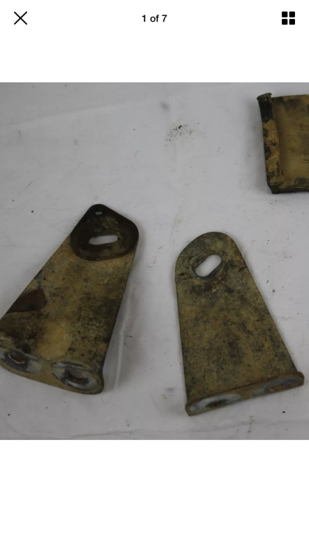

I am after brackets to suit the original designed seat base the yellow part and the seat that goes on top. I have brought some aftermarket seat brackets from tytrials to try but they do not fit, (about an inch to short) they must be for a newer ty
i think it might be this type I'm after but don't know the measurements so can't be sure.

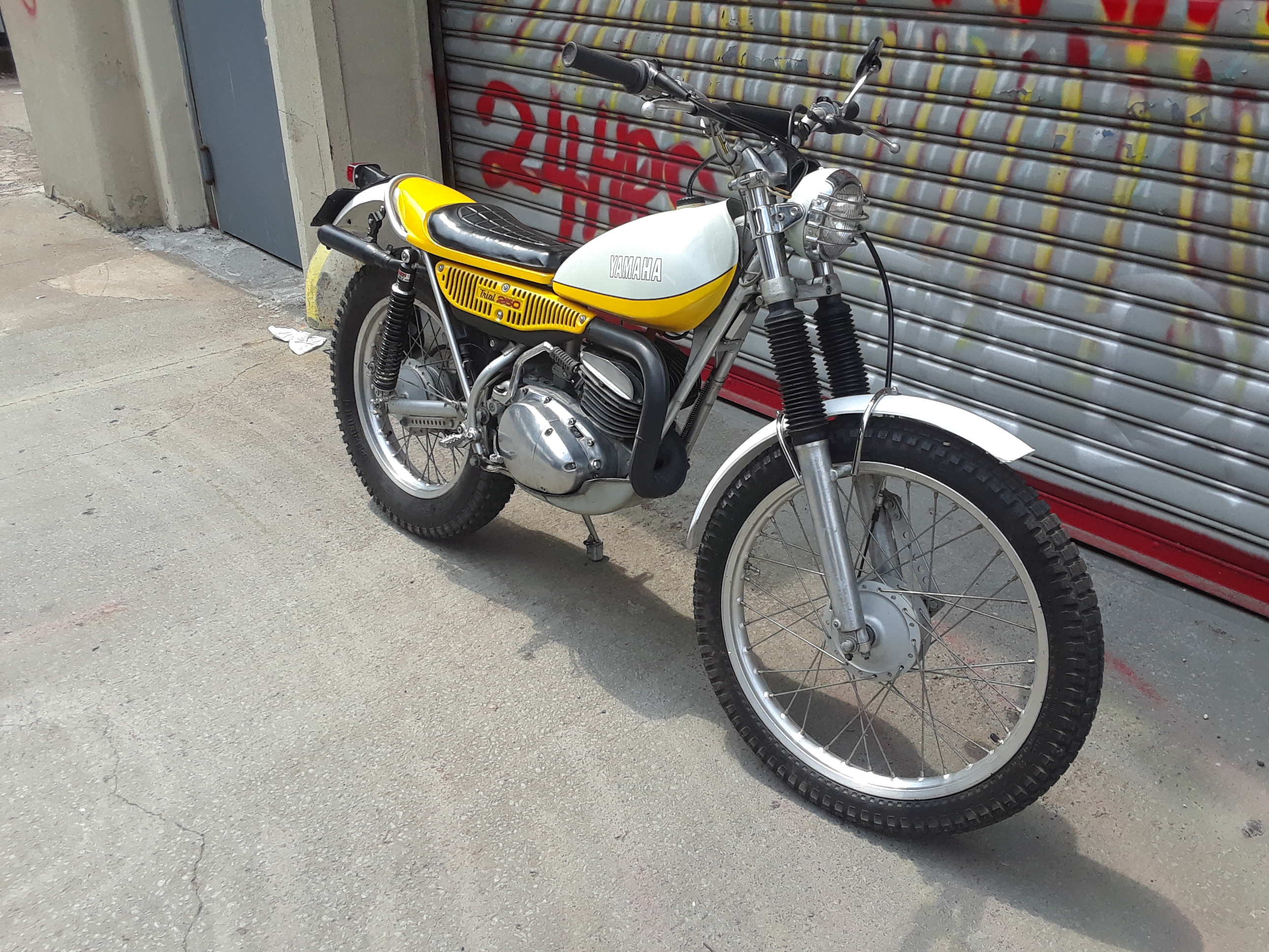

section swept, the A model seat that T5avs1 is seeking is nothing like what you have shown in your photos. You have shown the seat for C, D and E models TY250.
The original seats on the A (and B model TY250) were also a very poor design with a thin steel skeletal frame glued to a foam pad and a vinyl cover glued to the pad and wrapped around the underside of the steel frame. The thin steel frame had captive nuts for the mounting brackets attached and 6mm steel bolts went through the brackets and the fibreglass shroud/surround/fairing. Because these original seats fell apart quickly, Yamaha developed an improved design that had a moulded plastic base which fitted very well to the original fibreglass shroud/surround/fairing and were sold as a replacement part. I only know this because one of my TY250Bs came with this plastic base seat design, with part number sticker still attached.
I do not know of anyone still making replica seat bases that fit on the A, B models fibreglass shroud/surround/fairing. It wouldn't be too hard to make from scratch a seat base that will fit against the fibreglass shroud/surround/fairing if you were really keen to retain the original look. However most people I know do away with the fibreglass shroud and buy an aftermarket (C,D, E) seat or seat base as shown in section swept's photos and weld on a couple of mounting plates to their A or B model frames to replicate the C, D, E model seat mounting plates.

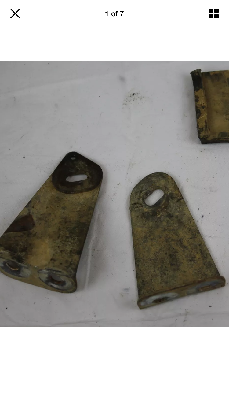

The brackets shown in the T5avs1 photo are seat brackets for A and B models seat design and their lower ends attach to the inner ends of the upper shockie mounts. The small hole in the end of one of the brackets is for a spring that pulls the end muffler forwards. I don't know of any supplier of the A, B model seat brackets, but they would be easy to fabricate.

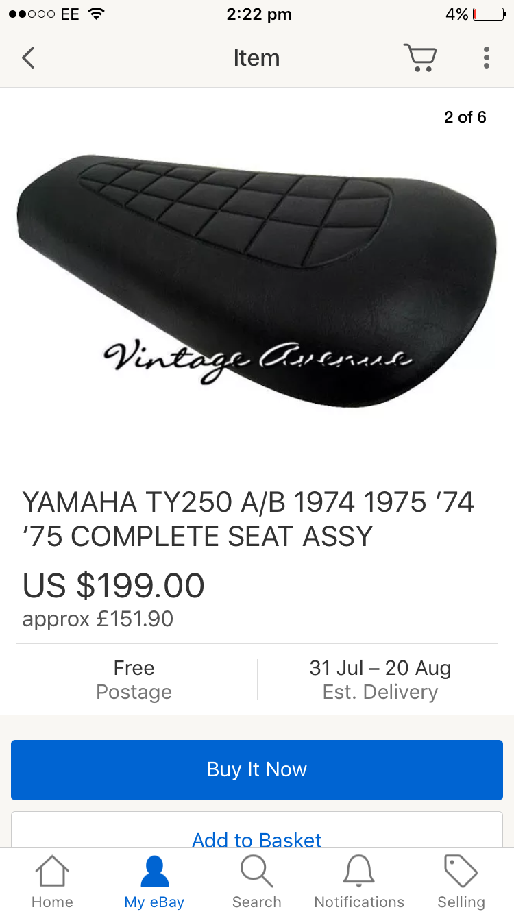

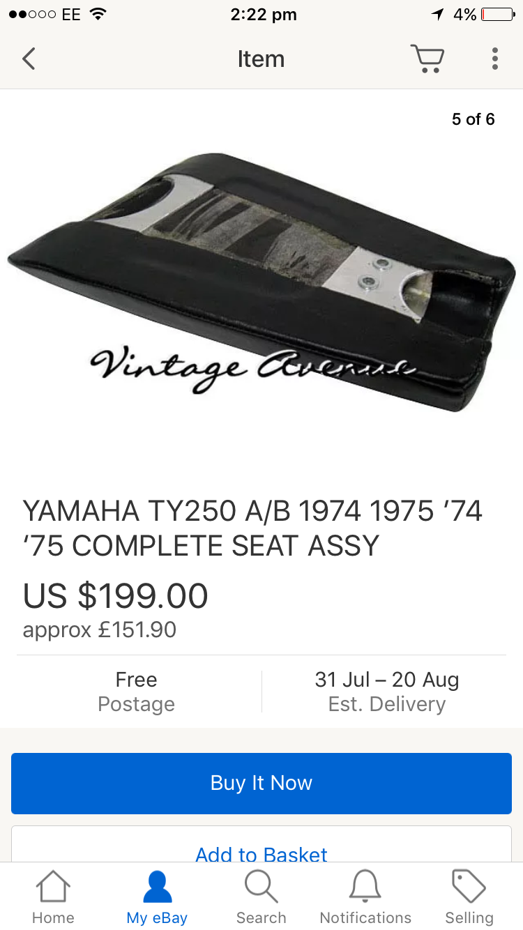

I have just found this seat on eBay which says it is for the a and b model does this look about right to you?
As for the brackets i need the originals or fabricate some new ones as I dont want to weld new mounting plates onto my frame as i have already had it painted.

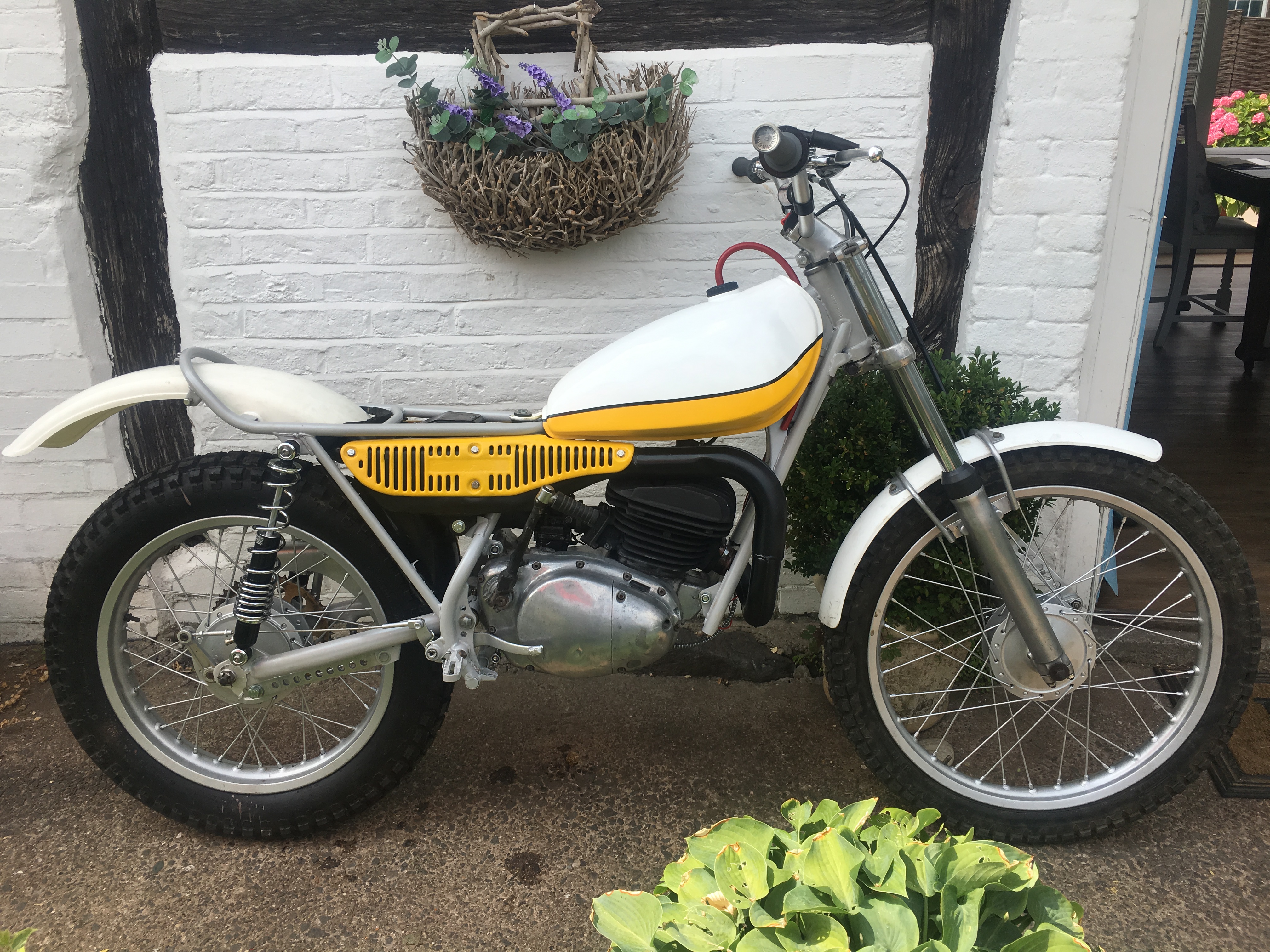

This is the bike bike so far

Yes that does look like the right seat to suit the A and B model fibreglass seat surround.
I looked at the remaining photos on that listing on eBay and had trouble seeing if there were holes for the rear mounting bracket bolts or not.
I see you have a C, D, E rear guard fitted. You may need to shorten the front end of that guard to fit the fibreglass seat surround.
