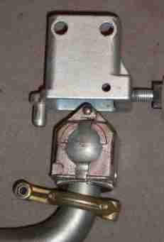

Hi,
I bought a bike rack from Dave Cooper to transport my Rev3 on my Honda Civic and as told to by them I bought the Bak-Rak swan neck to flange converter. Which is apparently what is needed for the standard Honda Civic tow bar. I fitted it as instructed but the rack sags back (away from the car) even before the bike goes on, and then twists back more when the bike is on. The whole unit also rocks a lot. I explained this to Dave Cooper who told me it was a Bak-Rak issue and Bak-Rak told me it's fine and does this. Does anyone have experience in this or suggestions on how to make it feel more secure?
Thanks in advance for any help.

The rack looks the business with what look like substantial welds. Trouble is that there is now so much leverage acting upon the tow ball that every mounting point on the car is being loaded, more so than when towing a trailer as most of the weight is supported by the towed items wheels.
As oni nou suggests an alternative additional strap arrangement to spread the load over more of the car might make things more stable. The saving grace here is that you probably will only use the rack occasionally rather than full time.
Link to comment
I can't see exactly what is going on inside that Bakrak thingie, but it just seems a triumph of optimism over reality to think that anything is going to attach to a ball and then provide a stable support of an offset load of 80 or 90kg. Is the Bakrak intended for pushbikes?
Although the Dave Cooper rack is ingenious and a lot of people have covered a lot of miles with them, I still find it unduly flexible and decided against it for myself.

The BakRak adapter is tested to 650kg british and 300kg TUV German so it appears that the weak link is the tow bar nose weight not the BakRak adapter.

The pic's show the two bolt flange on the adapter is not vertical as it would be on a flanged tow bar. Check the fitting, hard to believe it's been made that badly as it looks good.

I used to have a DC rack on a regular flat plate type towbar and found it worked well with minimal flex etc. although the forces involved must be pretty large (I'm also pretty sure insurance would use it as a loophole to avoid paying out if anything occurred). The problem with those ratings (650kg) are that they are probably the downward load force measured at the towbar - introduced by a trailer or caravan etc. What the DC rack is doing is applying a turning force or "moment" which is the combined weight of bike and rack multiplied by the distance from the ball to the centre of gravity of said bike and rack. The only way to counteract this is Oni nou's strap idea or Nebulous's extension bar under the car. I expect the bracket has some plates which contact the neck below the bar, but they will be very close to the pivot and won't really be able to balance the force from the bike.

You are correct
The problem with the Bak-Rak is that it clamps on the ball and not the ball+the stem, hence why it can pivot until the Bak-Rak hits the stem, however Bak Rak do an anti pivot collar which clamps to the stem, but personally I'd invest the £70 for a flanged swan neck
