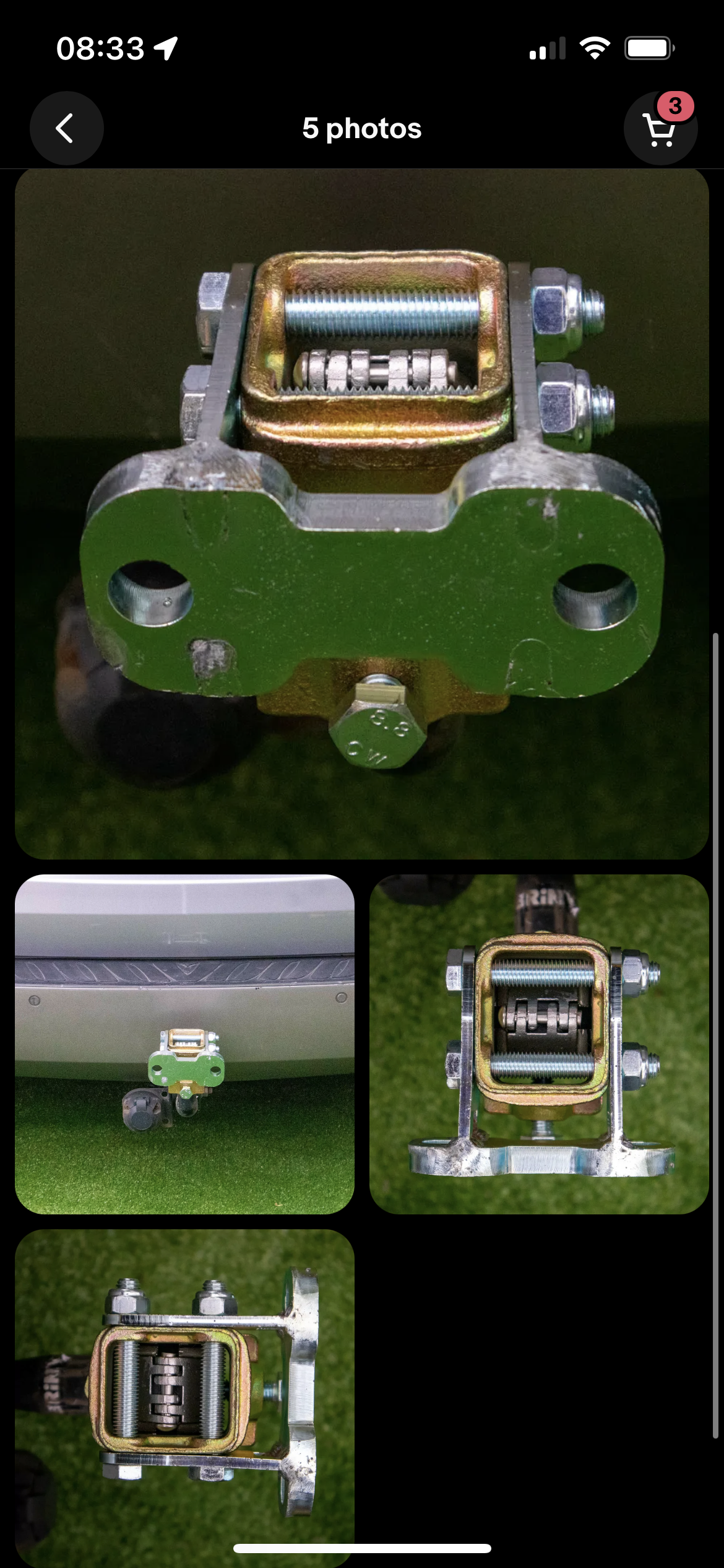

MarkMac Posted March 2, 2023 Report Share Posted March 2, 2023 Ive stumbled across this thread after a google search as I have a detachable swan neck towball on my new car and wanted to know if a DC rack would work. the bak-rak adapter seemed perfect, then this thread threw my judgement. however!! I’ve since discovered the install shown in this thread is incorrect. The clamp bolt is shown on the “car” side of the ball. It needs to be on the rear face of the ball as in this attached picture! That should correct the lean the poster discussed and the dact the flange wasnt vertical to start with!👍 Hope it helps clarify in this tread and any future google searchers like myself 🙂 Quote Link to comment Share on other sites More sharing options...
b40rt Posted March 2, 2023 Report Share Posted March 2, 2023 10 minutes ago, MarkMac said: Ive stumbled across this thread after a google search as I have a detachable swan neck towball on my new car and wanted to know if a DC rack would work. the bak-rak adapter seemed perfect, then this thread threw my judgement. however!! I’ve since discovered the install shown in this thread is incorrect. The clamp bolt is shown on the “car” side of the ball. It needs to be on the rear face of the ball as in this attached picture! That should correct the lean the poster discussed and the dact the flange wasnt vertical to start with!👍 Hope it helps clarify in this tread and any future google searchers like myself 🙂 I suggested it was back to front, and only 5 years later ............ Quote Link to comment Share on other sites More sharing options...

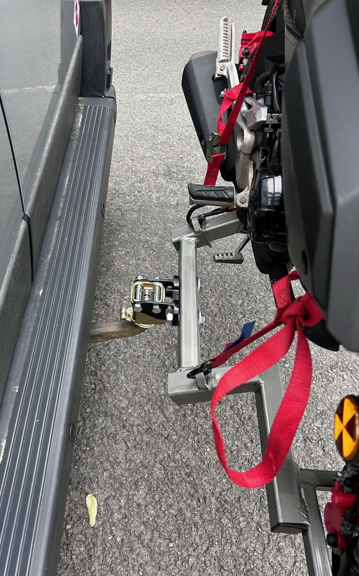

Trustytriumph Posted July 11, 2024 Report Share Posted July 11, 2024 On 7/27/2018 at 1:49 PM, MAL1980 said: Hi, I bought a bike rack from Dave Cooper to transport my Rev3 on my Honda Civic and as told to by them I bought the Bak-Rak swan neck to flange converter. Which is apparently what is needed for the standard Honda Civic tow bar. I fitted it as instructed but the rack sags back (away from the car) even before the bike goes on, and then twists back more when the bike is on. The whole unit also rocks a lot. I explained this to Dave Cooper who told me it was a Bak-Rak issue and Bak-Rak told me it's fine and does this. Does anyone have experience in this or suggestions on how to make it feel more secure? Thanks in advance for any help. Quote Link to comment Share on other sites More sharing options...

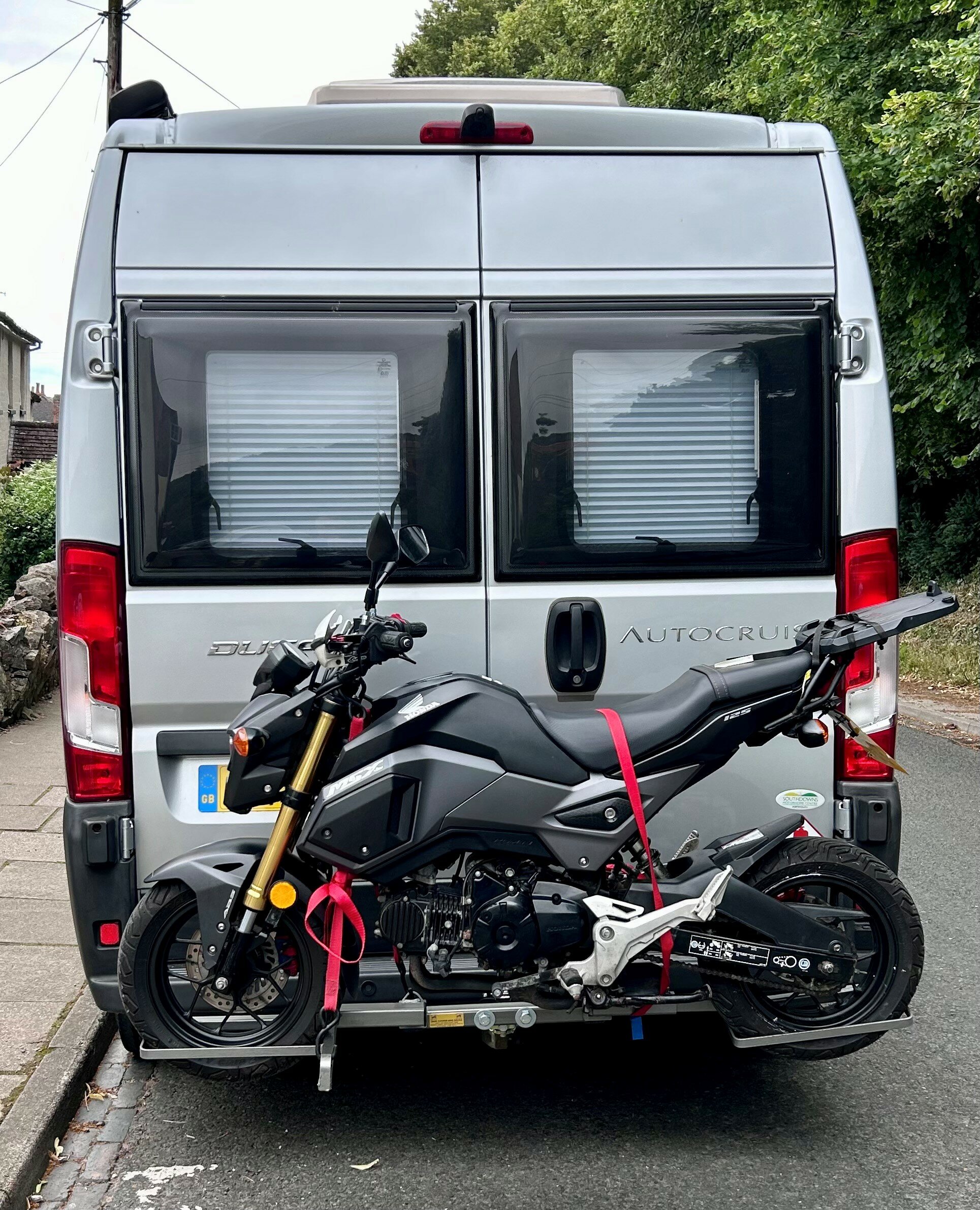

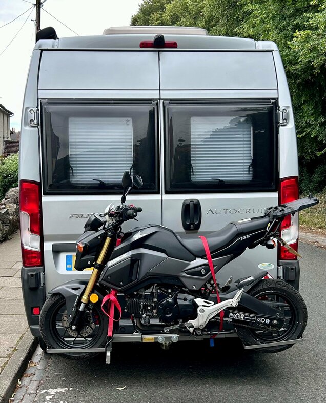

Trustytriumph Posted July 16, 2024 Report Share Posted July 16, 2024 On 7/11/2024 at 1:43 PM, Trustytriumph said: Hi all sorry to again add to an old thread but I’ve gone down the same route as others above using a DC rack and Bak Rak converter to mount my Honda GROM (90kg ) on first fitting there was a lot of slop and rotation which was adding up to a concerning level of movement. Having got my torque wrench out and tweaked everything up it’s stopped the rotation on the ball but not the bouncing up and down - that’s down to the rack - I am going to see if I can modify the design to add a strengthening bar from under the tow bar back up to the underside of the rack to try and stop the rack bouncing up and down. I noticed that Bak Raks own G4 platform has one of these and is rated much higher weight wise to 120kg. Just wondering if anyone else had any other view or way of resolving? My issue may simply be weight - my bike is probably 20kg heavier than most trials bikes which is what the rack is designed for . Quote Link to comment Share on other sites More sharing options...
