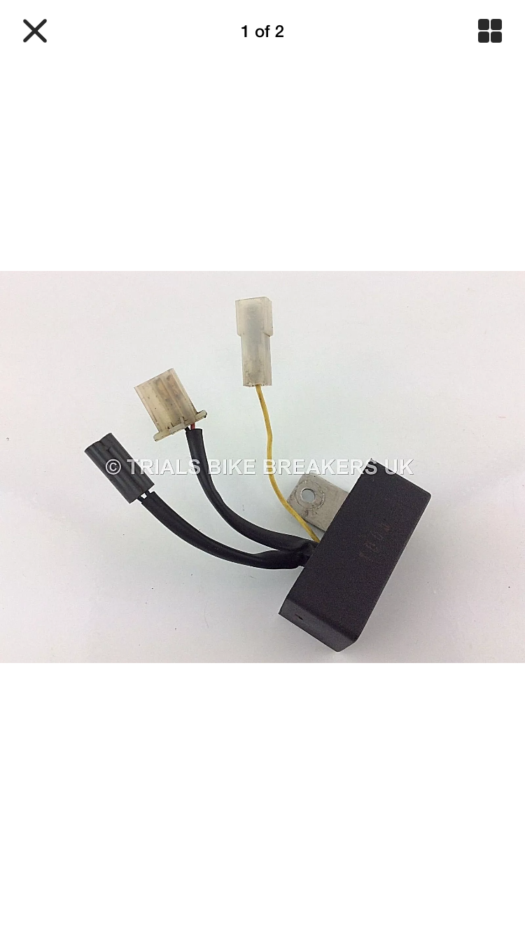

Gazbee123 Posted July 30, 2018 Report Share Posted July 30, 2018 (edited) Hi all purchased a regulator could you tell me if the yellow wire need power to it please there is 5 in total two for the fan two for the thermostat and one left YELLOW ? Is it for the front light or should a wire be connected I took the old part off today yellow wasn’t connected fan won’t work unless I put battery on it fitted new part still won’t work even bypassing the thermostat doesn’t help kind regards Edited July 30, 2018 by Gazbee123 More info Quote Link to comment Share on other sites More sharing options...
dan williams Posted July 30, 2018 Report Share Posted July 30, 2018 (edited) I believe the yellow wire is the ac feed from the stator. I assume the ground lug is the other side of the ac feed so it needs to be bolted to the frame. Edited July 30, 2018 by dan williams Quote Link to comment Share on other sites More sharing options...

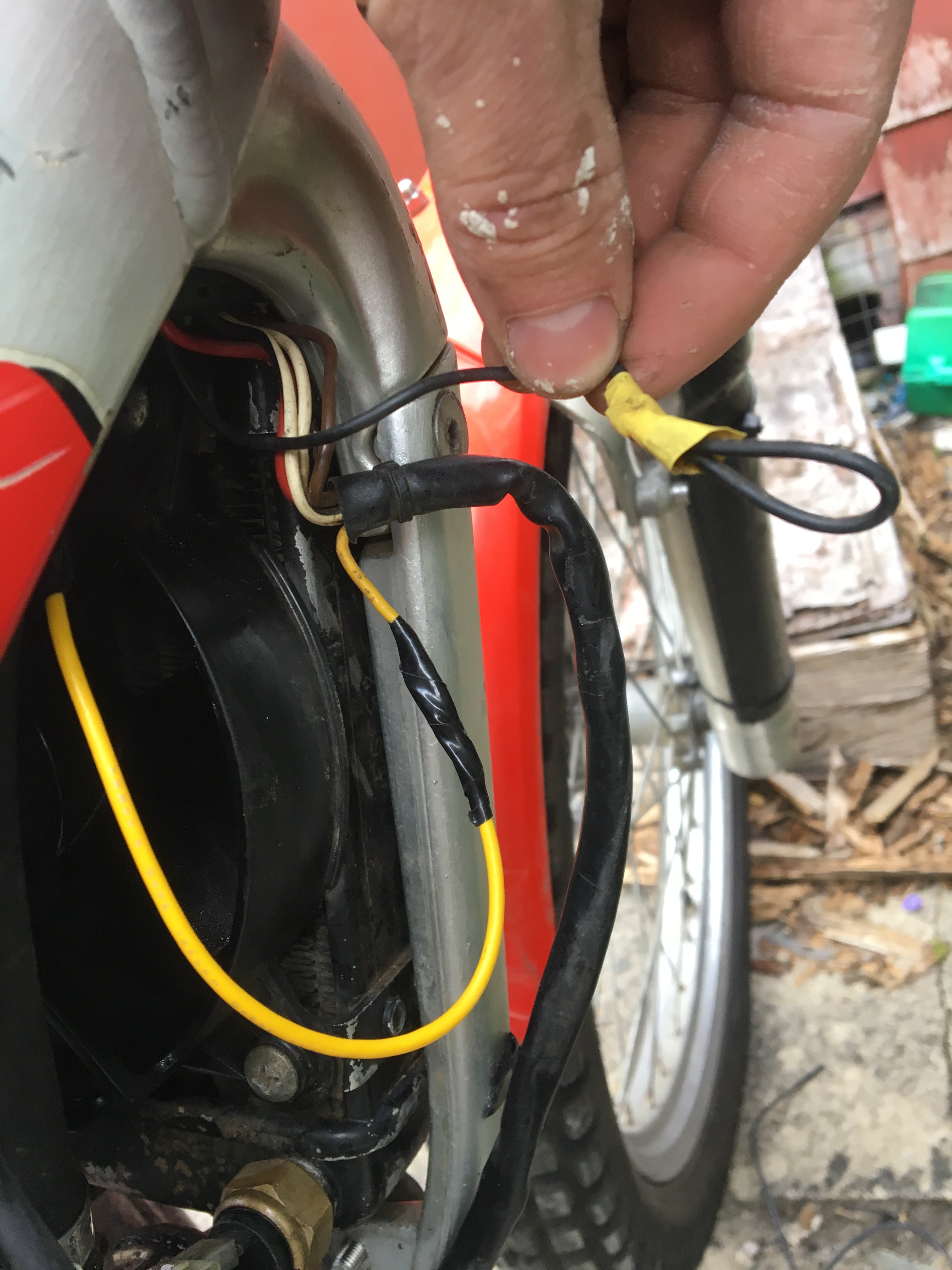

Gazbee123 Posted July 30, 2018 Author Report Share Posted July 30, 2018 (edited) Hi thanks for the reply so the regulator bolts to the frame to act as an earth I’ve done that .. and the yellow wire in the picture is connected to the stator wire to give live feed to the regulator ? Edited July 30, 2018 by Gazbee123 More info Quote Link to comment Share on other sites More sharing options...
dan williams Posted July 30, 2018 Report Share Posted July 30, 2018 That would be my guess. Of course without a schematic I could be wrong but it seems the only way the thing could work if you are correct about the other connectors. Quote Link to comment Share on other sites More sharing options...
Gazbee123 Posted July 30, 2018 Author Report Share Posted July 30, 2018 Hi yes other wires go to the fan and the thermostat the yellow is just left there hanging I will connect it tomorrow then bypass the thermostat and see if fan comes on . Thanks Quote Link to comment Share on other sites More sharing options...
reggie Posted July 31, 2018 Report Share Posted July 31, 2018 You guys are correct yellow and tab mount AC in / white connector to the fan / grey connector to the t-stat switch 1 1 Quote Link to comment Share on other sites More sharing options...
jonnyc21 Posted July 31, 2018 Report Share Posted July 31, 2018 Interesting, I just had my daughters Beta 80 apart for some tests of the fan and see this post. It was connected just as Reggie says... yellow is connected and earth grounded on the tab, the others two went to the fan and t-stat. 1 Quote Link to comment Share on other sites More sharing options...
Gazbee123 Posted July 31, 2018 Author Report Share Posted July 31, 2018 Spot on it works fine now kill switch still doesn’t work can anyone tell me what the black wire is for please Quote Link to comment Share on other sites More sharing options...
