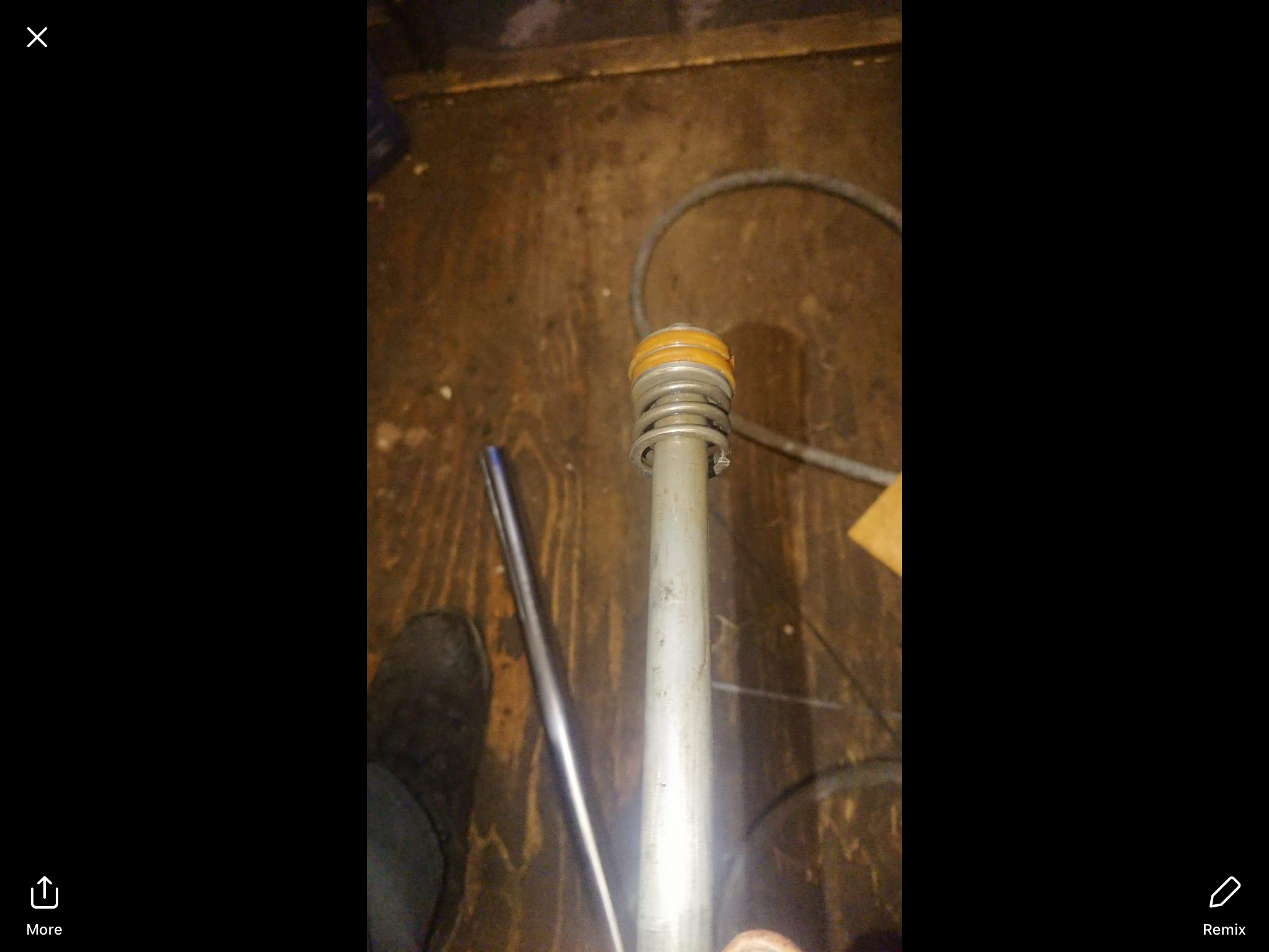

aonejames Posted July 31, 2018 Report Share Posted July 31, 2018 My betor forks are making a loud bang when lifting the front end . I have stripped the forks down and see no problem any help would be appreciated Quote Link to comment Share on other sites More sharing options...

aonejames Posted August 1, 2018 Author Report Share Posted August 1, 2018 There is a short spring I stripped the forks and rebuilt them the same way the problem could have been there . I have looked at the parts diagrams and can’t see anything missing I am going to try a heavier grade of oil . Thank you for your input keep you posted ? Quote Link to comment Share on other sites More sharing options...
kurtas Posted August 2, 2018 Report Share Posted August 2, 2018 Should have 180mL per leg in the 125. i wouldn't think an extra 40mL of oil per leg would cause it to top out. If it has always been like it since you've owned it the bump stop could be the problem. If its only just happened my guess is oil. either amount wrong or weight. Quote Link to comment Share on other sites More sharing options...

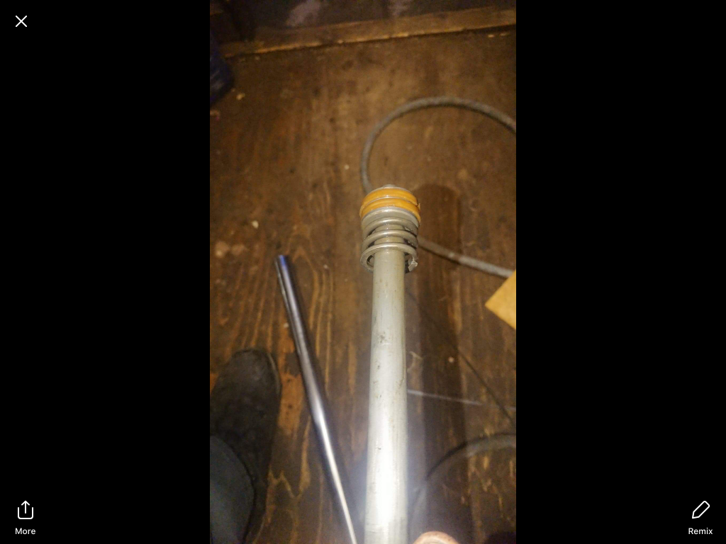

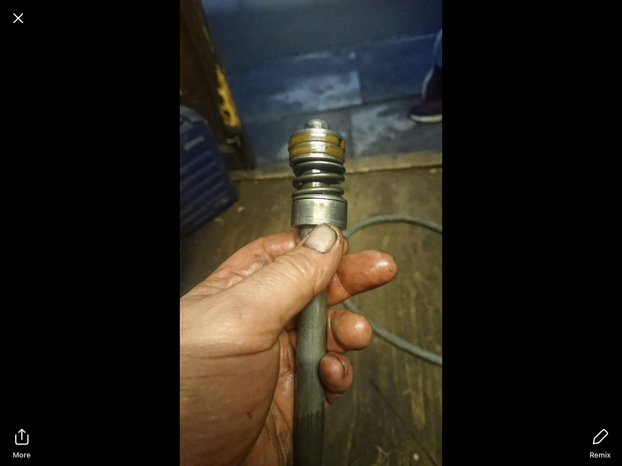

aonejames Posted August 27, 2018 Author Report Share Posted August 27, 2018 what’s missing ? Quote Link to comment Share on other sites More sharing options...
