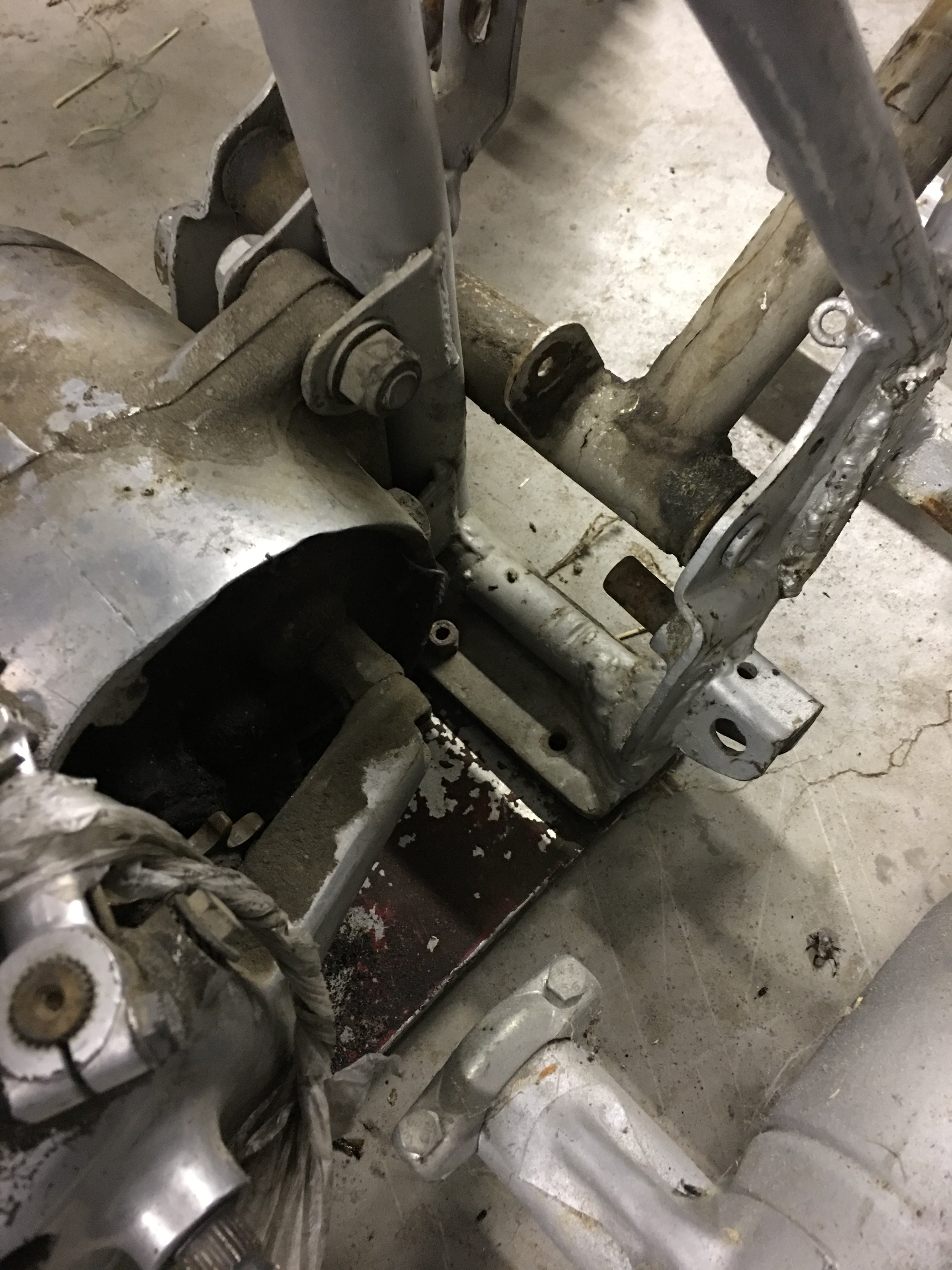

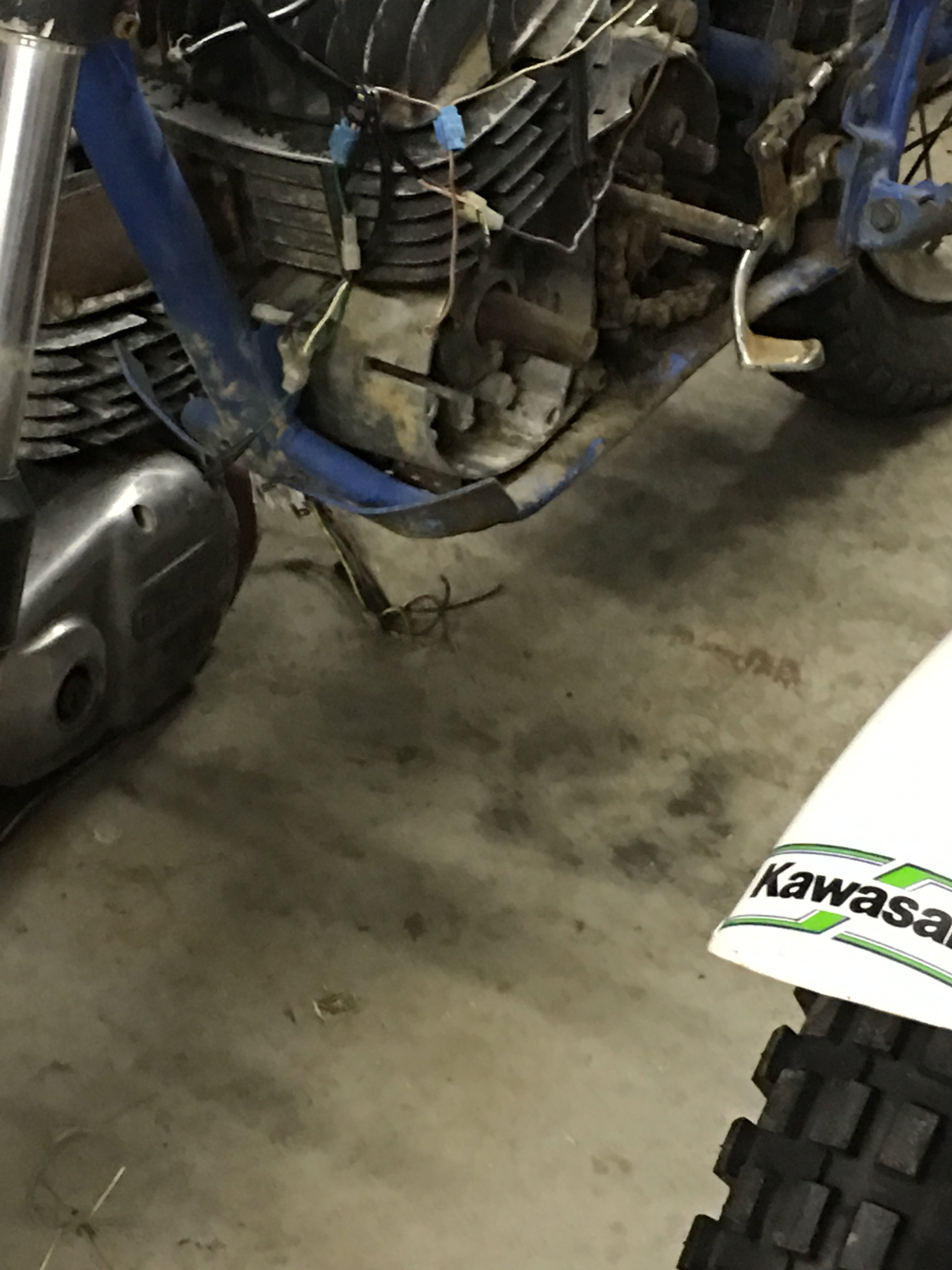

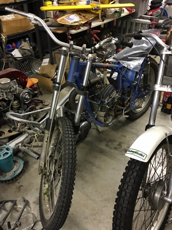

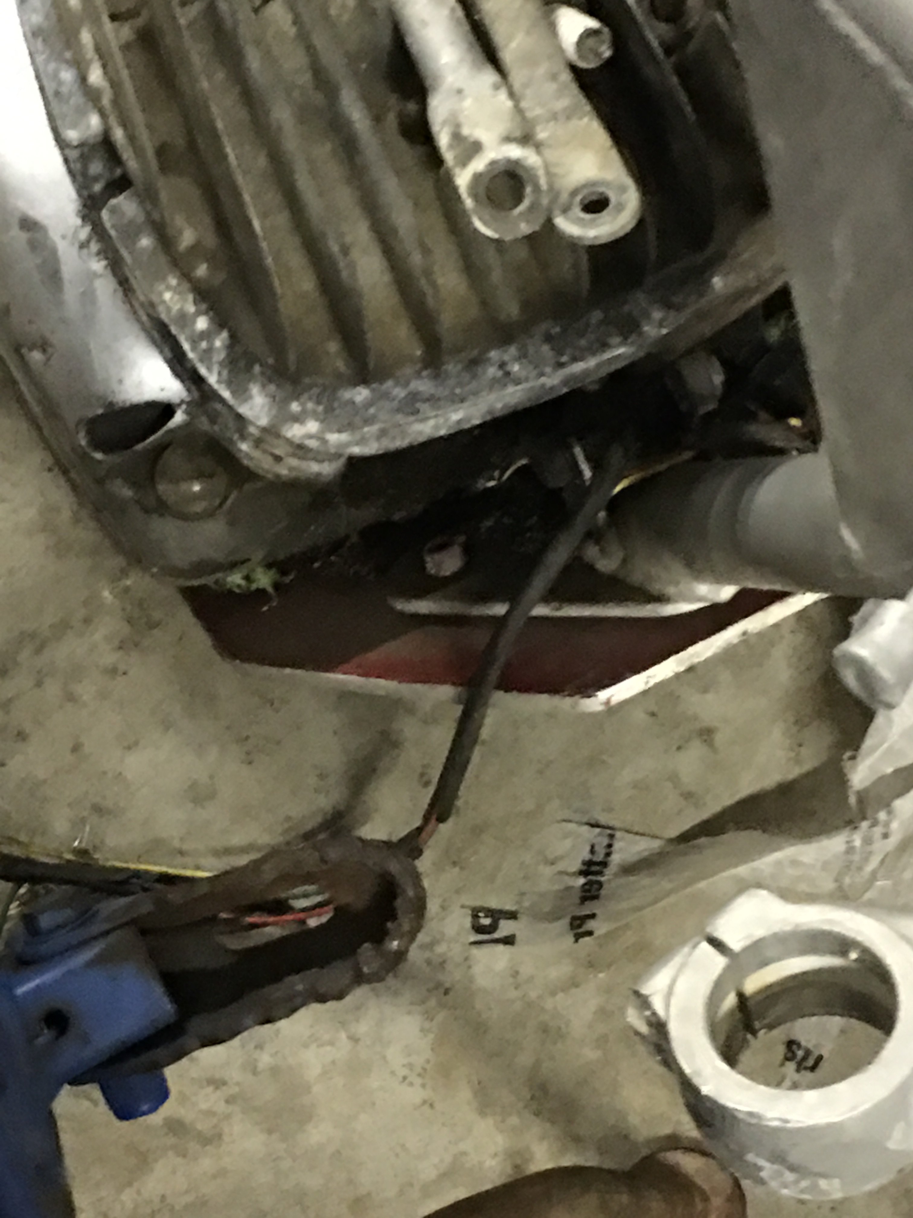

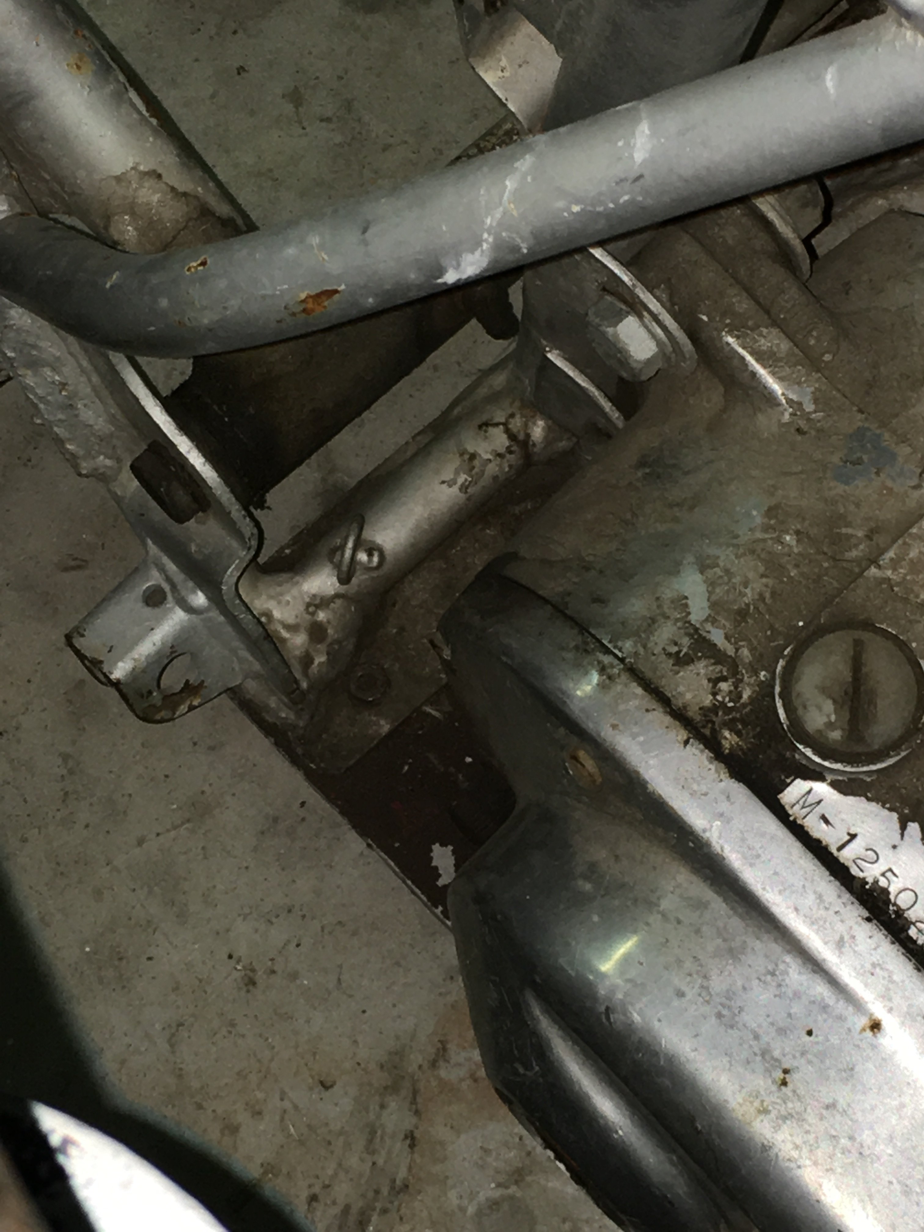

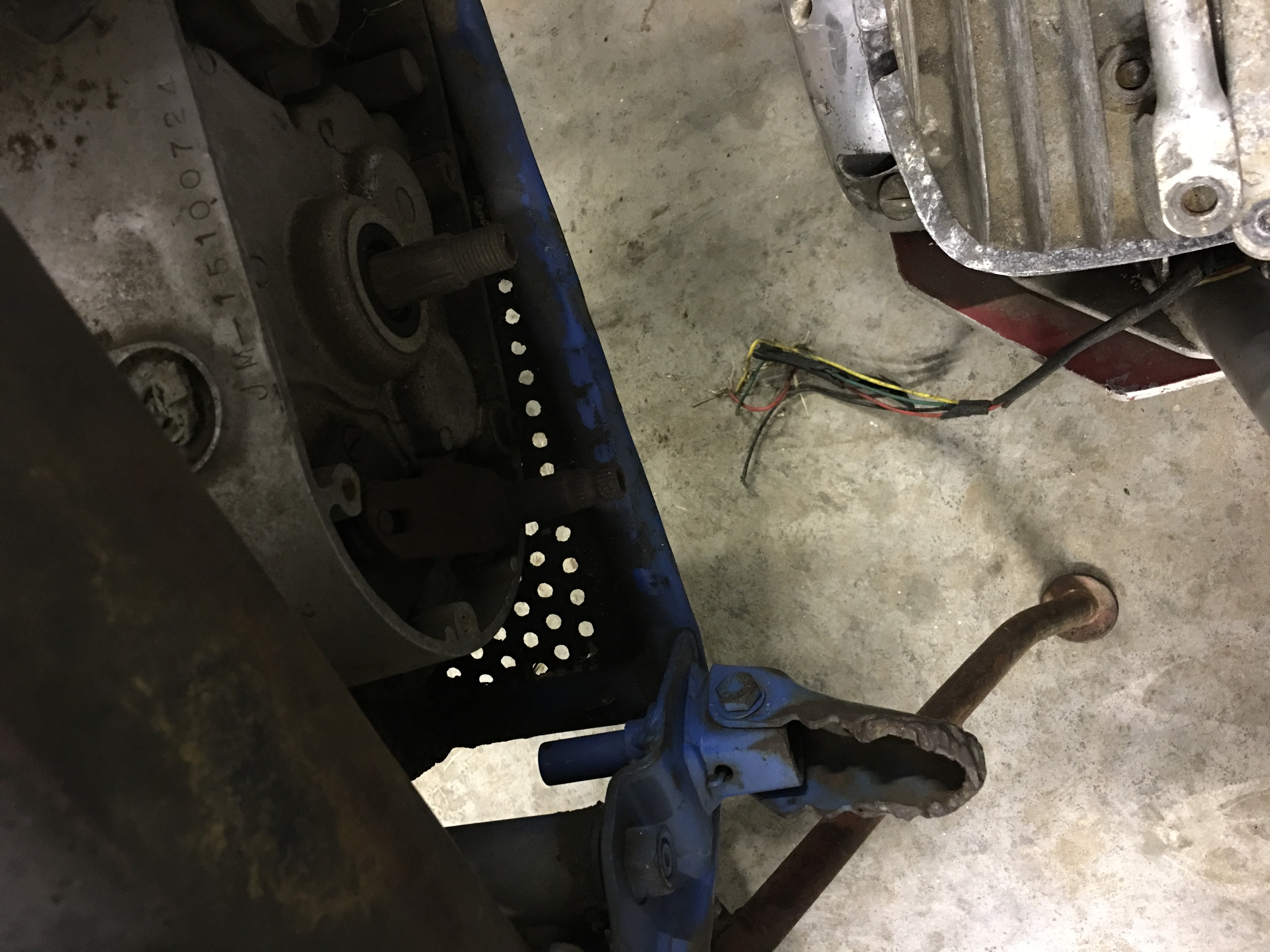

Cribbs74 Posted August 8, 2018 Report Share Posted August 8, 2018 First time poster and of course I have a few questions. I picked up 2 very rough Bultaco Sherpas. One is a Model 125 and is just a frame, the other is a Model 151 and is basically just a roller with engine. The Frames on these are quite different one has a cradle under the engine and bash plate, the other has just a bash plate and no cradle. Not sure if that is normal or not. Frame numbers are as follows: JB-12502105 JB-1500724 Engine Numbers: M-12502105 M-15100724 Lastly, where can I get parts? I have seen a couple US Bultaco suppliers as well as a couple overseas suppliers, but those are all new parts. Where do I go for used parts? Surely Ebay is not the only source. I need a lot of small parts, things that aren’t reproduced or NOS. I am attaching a couple photo’s of the frames so you guys can tell me what is wrong. Thanks for any help you can provide. Ron Cribbs Quote Link to comment Share on other sites More sharing options...

scot taco Posted August 8, 2018 Report Share Posted August 8, 2018 I believe those frames are pretty similar but could be wrong.I do know that they would have both had frame rails under the engine.The one with just a skid plate has been modified that way which was a pretty common mod.For used parts call Bultaco Classics in NY or Lynn Mobely at Mobelys Bultaco.I have only delt with Bultaco Classics which use to be called Hughs Bultaco.Same people and they have a ton of used parts not listed on their website. 1 Quote Link to comment Share on other sites More sharing options...

Cribbs74 Posted August 13, 2018 Author Report Share Posted August 13, 2018 Back to the frames again. I need to replace the cradle frame tubes that attach to the skidplate on the M-151. They have been bashed nearly flat. Does anyone have an idea as to the tubing thickness? What type of steel were used on these frames? Chromoly? Thanks, Ron Quote Link to comment Share on other sites More sharing options...
feetupfun Posted August 13, 2018 Report Share Posted August 13, 2018 Those frames were made at a time when Bultaco frames were starting to be made from chrome moly steel so it might or might not be. Not a problem though because you can successfully weld chrome moly tubing to other common alloy steels and to mild steel. If it was me I would use whatever I could find that was the correct OD, so it looked right. Frame tubes under the engine on a trials bike cop quite a beating so going thicker wall than what you might use if you were trying to make it as light as possible might be a good idea. I would use 2mm wall or thicker. If you want to measure the existing tube thickness, grind part-way through the tube with an angle grinder somewhere in the damaged area. 1 Quote Link to comment Share on other sites More sharing options...
section swept Posted August 13, 2018 Report Share Posted August 13, 2018 The frame tube wall thickness is 2.00mm as standard, probably a good reason why the frames are heavy. Quote Link to comment Share on other sites More sharing options...
Cribbs74 Posted August 14, 2018 Author Report Share Posted August 14, 2018 Ask and ye shall receive, thanks guys. Any idea as to the O.D.? I know I could cut it off and measure, but if someone knew of the top of their head that would be easier Ron Quote Link to comment Share on other sites More sharing options...
section swept Posted August 14, 2018 Report Share Posted August 14, 2018 (edited) Just measure any part of the frame side rails, the main loop would be good but 20mm or 3/4 in OD ?? Edited August 14, 2018 by section swept Quote Link to comment Share on other sites More sharing options...
