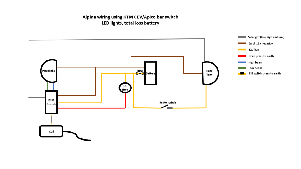

petorius Posted August 15, 2018 Report Share Posted August 15, 2018 I have been looking into this recently for an Alpina that i am putting together, i believe the standard headlight is a CAV item, 130mm. I am looking at fitting a cheap repro' Honda CG 125 unit, retailing from £15 like this; https://www.ebay.co.uk/itm/Replica-HONDA-CB100-CB125-CG125-Headlight-Headlamp-Complete/401547914069?ssPageName=STRK%3AMEBIDX%3AIT&_trksid=p2060353.m1438.l2649 As i do not intend to ride in the dark i am looking at fitting total loss electrics with a 12V Li-ion CCTV battery, LED bulbs, DC horn. A nice small rear brake/tail/ number plate light board available here; http://www.dynamoregulatorconversions.com/led-bulbs-especially-for-motorcycles-shop.php This is the tiny battery i have https://www.ebay.co.uk/itm/Li-ion-Battery-Pack-for-CCTV-Camera-Mini-Portable-DC-168-12V-Rechargeable-Pretty/301408597336?ssPageName=STRK%3AMEBIDX%3AIT&_trksid=p2060353.m1438.l2649 1 Quote Link to comment Share on other sites More sharing options...

petorius Posted August 16, 2018 Report Share Posted August 16, 2018 I guess it will depend on how carried away you want to get with the headlight bulb. The site above has dipping bulbs rated at 250mA, low beam and 500mA, high beam at 12V. For the brake light boards i have seen them rated at 80mA for brake light and 60mA for tail light numberplate light. You can get very bright, higher rated dipping bulbs which seem to be around 1600mA high beam. My guess is that with the lights on riding on high beam using the lower rated headlight bulb i would get around 2hrs using the 1800mAh battery and 45 minutes or so if you used the very bright bulb on high beam. Higher rated batteries are available for a few pounds more. Having said that the battery i have is so small, light and cheap you could carry a spare in your pocket. Another couple of suppliers here; http://www.norbsa02.freeuk.com/goffyleds.htm https://matchlessclueless.com/store/lucas-564-leds/12v-lucas-564-led-kit/ Just like to mention i have not actually installed any of this yet so cannot vouch for how successful it would be but i am looking to use a KTM type bar switch which is quite a nice solution, as it has all the controls in a single switch. Apico make an alternative, this is what i am intending to use and i made a quick sketch based on this. Not yet having a switch to test i cannot confirm wire colours are definitely correct though. http://www.apico.co.uk/portfolio/start-kill-switches/ 1 Quote Link to comment Share on other sites More sharing options...
