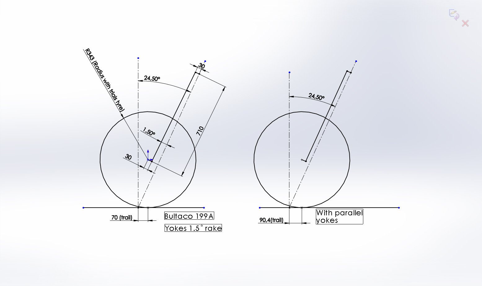

detective 21 Posted August 25, 2018 Report Share Posted August 25, 2018 my project currently has some 36mm jap forks in that are not really suitable for trials, I am planning to change to bultaco 35mm leading axle forks as I have access to some, my question is what type of yokes? cubs are non parallel with 1.5 degrees in the yokes as standard, but given that I am changing to leading axle forks should I be looking of parallel yokes to compensate for this change or would non parallel ones work without causing issues to trail/rake? Quote Link to comment Share on other sites More sharing options...

carl ekblom Posted January 26, 2019 Report Share Posted January 26, 2019 1,5 degree rake at the yokes equals approx 20mm offset at the front wheel axle 1 Quote Link to comment Share on other sites More sharing options...

carl ekblom Posted February 19, 2019 Report Share Posted February 19, 2019 If Bultaco 199A have had parallel yokes the trail would have increase from 70mm to 90.4mm. Bultaco Sherpa yokes have 1.5 degree rake. I also have a 199B. It has a steering angle of 27degrees As far as I know modern bikes have parallel yokes, approx 60mm offset and a steering angle of 20-22degrees. 199A has 24.5degree steering angle and a total offset of approx 80,4mm (result is strange steering) 1 Quote Link to comment Share on other sites More sharing options...
trialsrfun Posted February 19, 2019 Report Share Posted February 19, 2019 20 hours ago, EREM said: Please forgive my ignorance... but do you mean it make it 20mm longer between axles? 4 hours ago, carl ekblom said: If Bultaco 199A have had parallel yokes the trail would have increase from 70mm to 90.4mm. Bultaco Sherpa yokes have 1.5 degree rake. I also have a 199B. It has a steering angle of 27degrees As far as I know modern bikes have parallel yokes, approx 60mm offset and a steering angle of 20-22degrees. 199A has 24.5degree steering angle and a total offset of approx 80,4mm (result is strange steering) If you look at the two lines on the left picture posted by Carl you can see that the space at the lower end is greater than at the top this is where the 20mm comes from. Quote Link to comment Share on other sites More sharing options...
