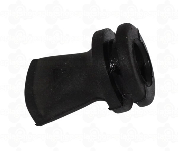

inchhigh Posted August 27, 2018 Report Share Posted August 27, 2018 (edited) I took the flap off mine when I did the six days drilled the hole a little bigger and put a rubber drain plug in . the flap work's ok but in deeper water can cause problems. here's the plug i used Edited August 27, 2018 by inchhigh Quote Link to comment Share on other sites More sharing options...
