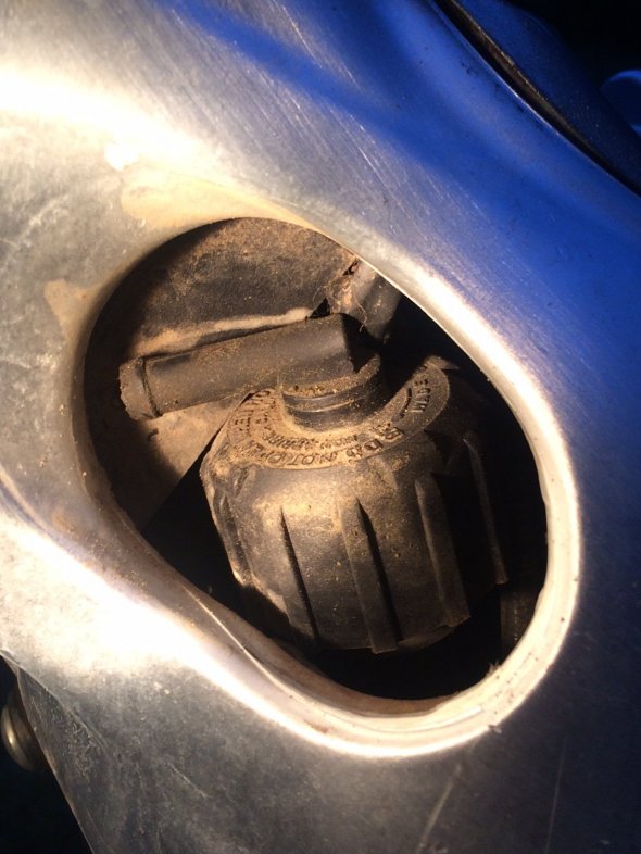

ahh_me2 Posted August 27, 2018 Report Share Posted August 27, 2018 ummm, new guy and newbie(trials) here. Just bought a 2001 Rev3 250 and wanted to check the fluids, after removing the plastic cover on the left side of the frame/tank, I saw the "rad cap" but it seems there is a plastic/metal block preventing it from un-threading upward, what am I missing? other than a few brain cells lol Here's my view of it: Quote Link to comment Share on other sites More sharing options...
nh014 Posted August 27, 2018 Report Share Posted August 27, 2018 Beta has an electrical junction box, the wiring looms, and the radiator cap all jammed into that small space. Usually you can force the box over enough to remove the cap. Quote Link to comment Share on other sites More sharing options...
2stroke4stroke Posted August 27, 2018 Report Share Posted August 27, 2018 Use a screwdriver and the heel of your hand to undo the cap. Quote Link to comment Share on other sites More sharing options...
ahh_me2 Posted August 27, 2018 Author Report Share Posted August 27, 2018 Thanks, was able to push the box over enough to unscrew the cap and remove it. Using a mirror I looked down the spout, it goes down 2 inches or so then branches off at 90 degrees, couldn't see any coolant. Should coolant come right up to the top? Quote Link to comment Share on other sites More sharing options...
2stroke4stroke Posted August 27, 2018 Report Share Posted August 27, 2018 I used fill it right up then put a clear tube down to the required level (top of body of radiator) then sook out the surplus with a syringe. But any excess would be expelled anyway. Quote Link to comment Share on other sites More sharing options...
ahh_me2 Posted August 28, 2018 Author Report Share Posted August 28, 2018 So not knowing what coolant fluid was used, I ended up draining the whole thing, I didn't get very much out, it must have been pretty low. It was a blue liquid, I'm thinking it's the Arctic Ice coolant that is sold around here at the moto dealers. I guess once it's a known fluid, a person can simply top it up on a regular basis as there doesn't seem to be any way of determining actual level. All part of the ongoing maintenance of a trial bike I suppose. Thanks for the help! Quote Link to comment Share on other sites More sharing options...
