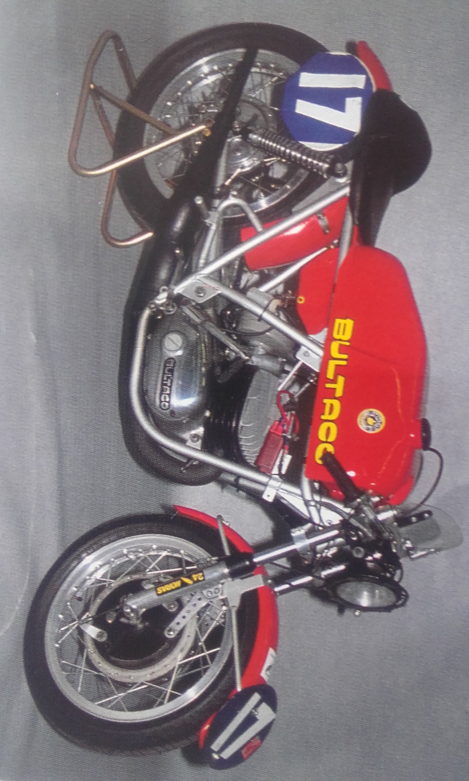

rusty nuts Posted August 28, 2018 Report Share Posted August 28, 2018 I have a love for all two wheels this one stood out for me . what engine from bultaco is it based on anyone knows please or a one off ? Quote Link to comment Share on other sites More sharing options...
paulc76 Posted August 28, 2018 Report Share Posted August 28, 2018 Thats a bultaco TSS Quote Link to comment Share on other sites More sharing options...
woody Posted August 28, 2018 Report Share Posted August 28, 2018 Worth loads of money they are. All the Bultaco engines are essentially the same carcass, just different states of tune and gears to suit their application. The outward appearance changed in early seventies when they went from the round barrel and rounded cases to the square barrel and slimmer cases as fitted on your 175 Quote Link to comment Share on other sites More sharing options...
smokey125 Posted August 28, 2018 Report Share Posted August 28, 2018 It's not a TSS, it's a Montjuic 360 based 24 hour racer. Hence the lights and big tank. 1 Quote Link to comment Share on other sites More sharing options...
stevem75 Posted August 29, 2018 Report Share Posted August 29, 2018 Yes it is a Montjuïc race bike. The engine is a 4 speed 350cc This engine was used in the bandito and el montadero models. As well the M29 TSS used it. The preproduction Montjuïc road bike that never came to be used this power plant in its early development stage. Note the center port exhaust exclusive to this engine type. I believe the factory called this the “pedrables” engine. Whereas the 5 speed models were called San Antonio. There were only 2-3 of this montjuic built by the factory for 24 hours racing. It was likely loosely built around the 350 TSS but didn’t carry the M29 designation. Highly regarded and exceedingly rare Steve 1 Quote Link to comment Share on other sites More sharing options...

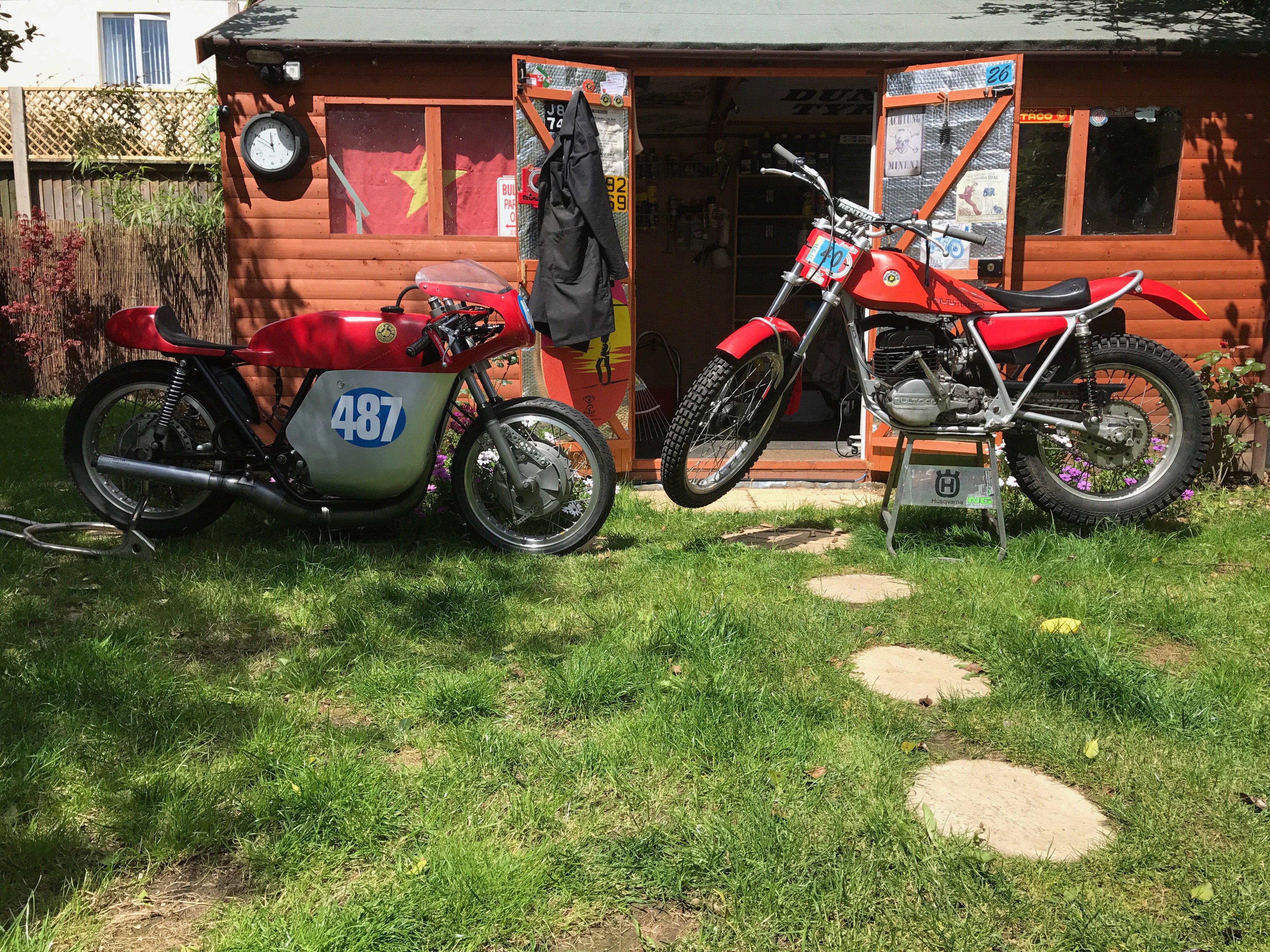

watch this Posted August 31, 2018 Report Share Posted August 31, 2018 The Montjuic did share the El Bandido engine for reliability the TSS only shared engine cases and was in a much higher state of tune with a 5 speed box. I'm lucky enough to own and race a TSS 2 1 Quote Link to comment Share on other sites More sharing options...
stevem75 Posted August 31, 2018 Report Share Posted August 31, 2018 Very nice !! One of only 57 made !!! (Or 58 depending who you talk to) I’ve seen serial #33 and one other one but can’t remember it’s serial. I actually wasn’t aware the M29 had a 5 speed box but it does make sense they would use it. Steve Quote Link to comment Share on other sites More sharing options...

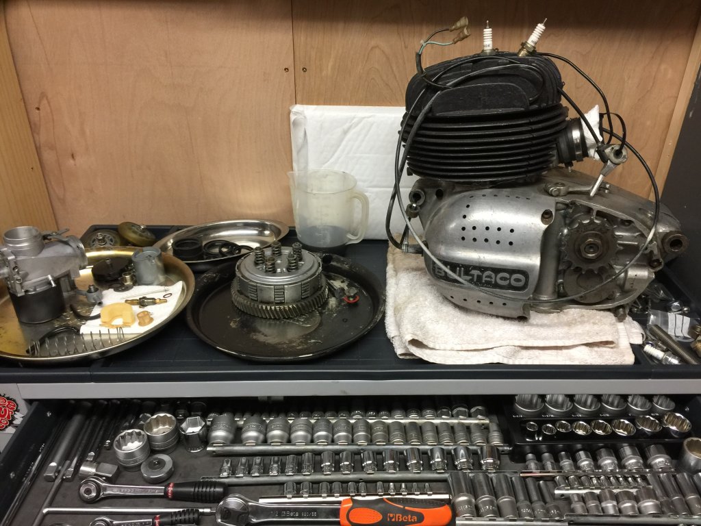

stevem75 Posted September 1, 2018 Report Share Posted September 1, 2018 Here are a few pics of the 400 prototype engine. Quote Link to comment Share on other sites More sharing options...
watch this Posted September 1, 2018 Report Share Posted September 1, 2018 (edited) On 9/1/2018 at 6:39 AM, stevem75 said: Here are a few pics of the 400 prototype engine. Expand Compact unit innit? Shame it never progressed. Looking closer at the Montjuic its interesting to note what a parts bin special it is, the frame looks very close to a TSS with additional bracing on the head stock and swing arm, the front and rear mudguards look like plastic items from a trials bike, air filter from a Metralla maybe? and very interesting to see they choose to leave the kickstart and clutch inspection cover (the TSS cases have neither its bump start only and no air filter), and most strangely the reversed gear-lever why no linkage like the TSS? The hole in the frame is there for it. Edited September 1, 2018 by watch this Quote Link to comment Share on other sites More sharing options...

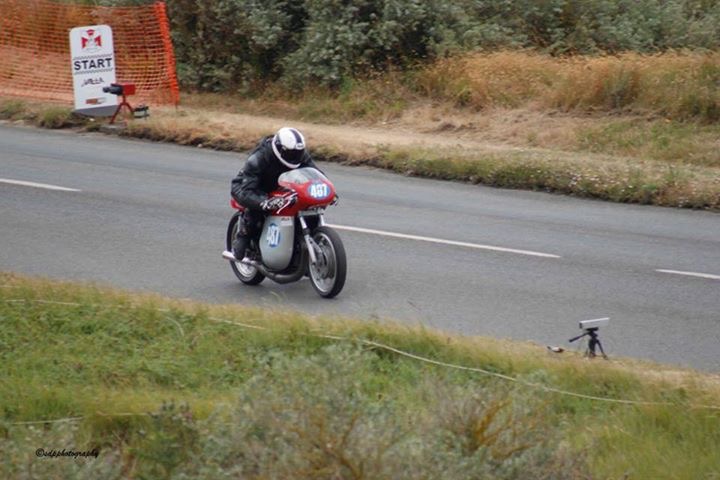

johnjsy Posted September 1, 2018 Report Share Posted September 1, 2018 Watch this, which year and which sprint are you in on the picture ? I remember seeing a picture in the local paper of a TSS being loaded in Granville I think it was, a couple of years ago, to Jersey. Then the trail went cold ! As I had a 1960’s TSS I was hoping to see it. Regards, John Parry. Quote Link to comment Share on other sites More sharing options...
watch this Posted September 1, 2018 Report Share Posted September 1, 2018 (edited) On 9/1/2018 at 10:59 AM, johnjsy said: Watch this, which year and which sprint are you in on the picture ? I remember seeing a picture in the local paper of a TSS being loaded in Granville I think it was, a couple of years ago, to Jersey. Then the trail went cold ! As I had a 1960’s TSS I was hoping to see it. Regards, John Parry. Expand Hi John, yep same bike sprint was only last year, I've been over to the mainland with it for a few race meets good fun little bike eh? I'm currently out of action with a hand injury so all my toys are tucked away, will hopefully have it out next year. Double entry for the hillclimbs for old times sake? Edited September 1, 2018 by watch this Quote Link to comment Share on other sites More sharing options...
