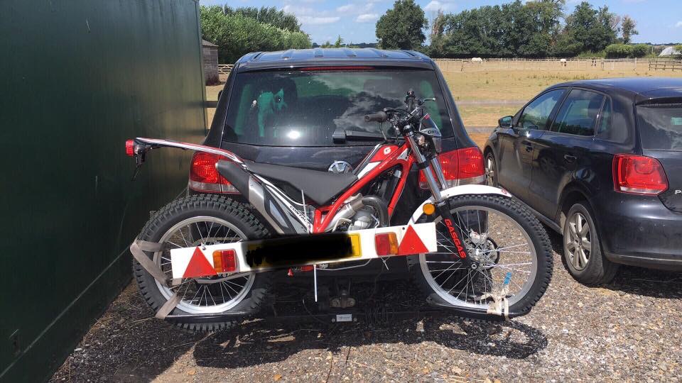

faussy Posted September 6, 2018 Report Share Posted September 6, 2018 (edited) PS, you do know bike racks exist? They take up a fraction of the space of a trailer, and if you have a towbar already fitted relatively cheap Edited September 6, 2018 by faussy 2 Quote Link to comment Share on other sites More sharing options...
