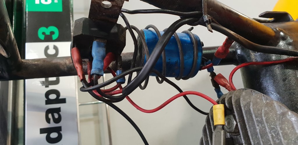

evo boy Posted February 11, 2019 Author Report Share Posted February 11, 2019 Hello all needs some mote help with my no spark. Could anyone tell me what the black square box is in my picture? Also I'm trying to test the magneto part what reading should I be getting? I'm looking at the point what should they be set to? Many thanks Quote Link to comment Share on other sites More sharing options...
b40rt Posted February 11, 2019 Report Share Posted February 11, 2019 (edited) You said you had boyer ignition ? Sounds like a standard set up to me. Black things a rectifier, blue a condenser. Edited February 11, 2019 by b40rt Quote Link to comment Share on other sites More sharing options...

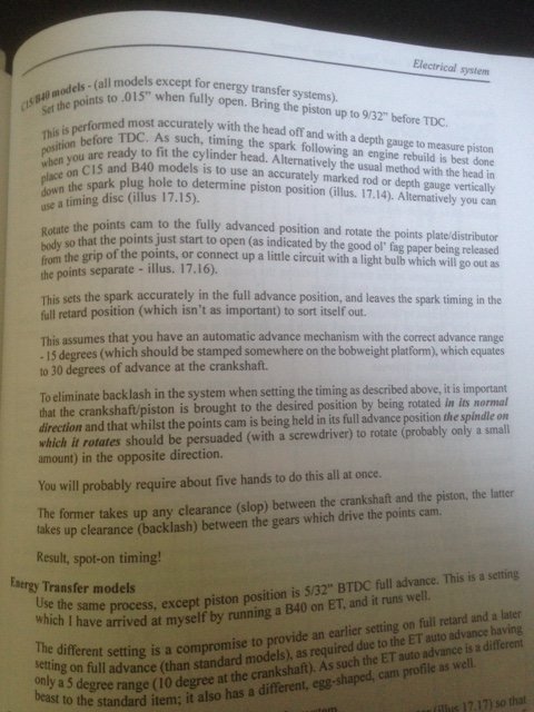

evo boy Posted February 11, 2019 Author Report Share Posted February 11, 2019 10 minutes ago, b40rt said: You said you had boyer ignition ? Sounds like a standard set up to me. Black things a rectifier, blue a condenser. Hello b40rt thanks for the reply that's what I was told by my Dad but think your right. You wouldn't know what the points should be set to? Many thanks Quote Link to comment Share on other sites More sharing options...
b40rt Posted February 11, 2019 Report Share Posted February 11, 2019 Quote Link to comment Share on other sites More sharing options...
