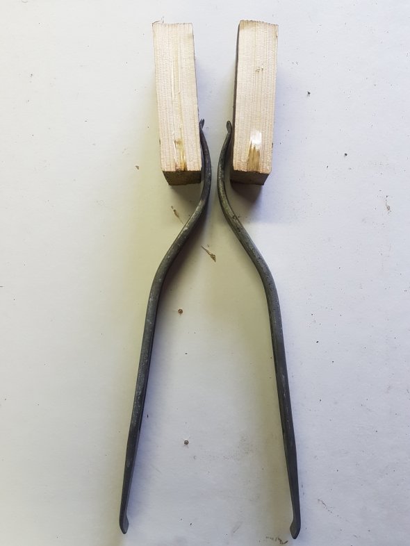

Domi600 Posted September 14, 2018 Author Report Share Posted September 14, 2018 Thanks for the advise lads but I got it fixed. I took a chance and spread the Tank using 2 pieces of wood and A couple of tyre levers. Still slightly narrower than orriganal but fits snugly on mounting rubbers now. 3 Quote Link to comment Share on other sites More sharing options...
