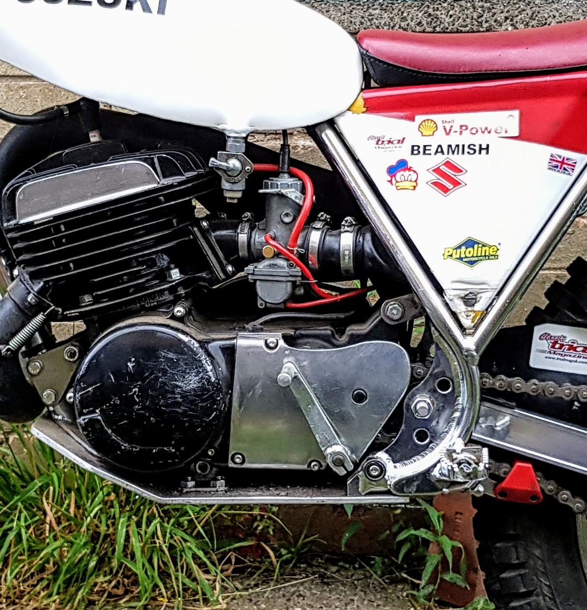

Tillerman6 Posted September 14, 2018 Report Share Posted September 14, 2018 If anyone would care to post a picture of a trials gear shift lever for the TY 250 A and / or just tell me what the length is supposed to be? I think mine is non- standard as the original owner had the bike set up for trail riding and I want to switch it back to trials mode for the time being. Quote Link to comment Share on other sites More sharing options...

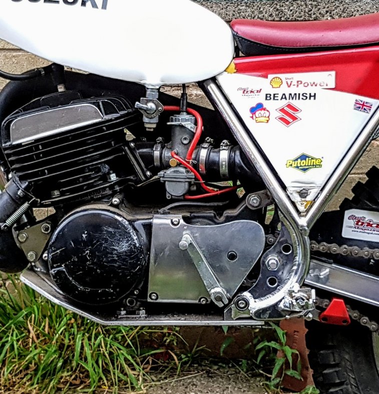

shakennstirred Posted September 15, 2018 Report Share Posted September 15, 2018 Mine and most trials riders have it pointing up out the way of rocks etc Spoiler Quote Link to comment Share on other sites More sharing options...
guy53 Posted September 15, 2018 Report Share Posted September 15, 2018 I ran many bike with the shifter setup like yours shakennstirred, I notice that it is '' harder '' on the casing if you are not careful when upshifting. Guy Quote Link to comment Share on other sites More sharing options...
b40rt Posted September 15, 2018 Report Share Posted September 15, 2018 Get a folding tip leavers, set at about 30 degrees. Any higher makes it a pain to change gear, and virtually impossible in a section. 1 Quote Link to comment Share on other sites More sharing options...
guy53 Posted September 15, 2018 Report Share Posted September 15, 2018 Spot on Guy Quote Link to comment Share on other sites More sharing options...
