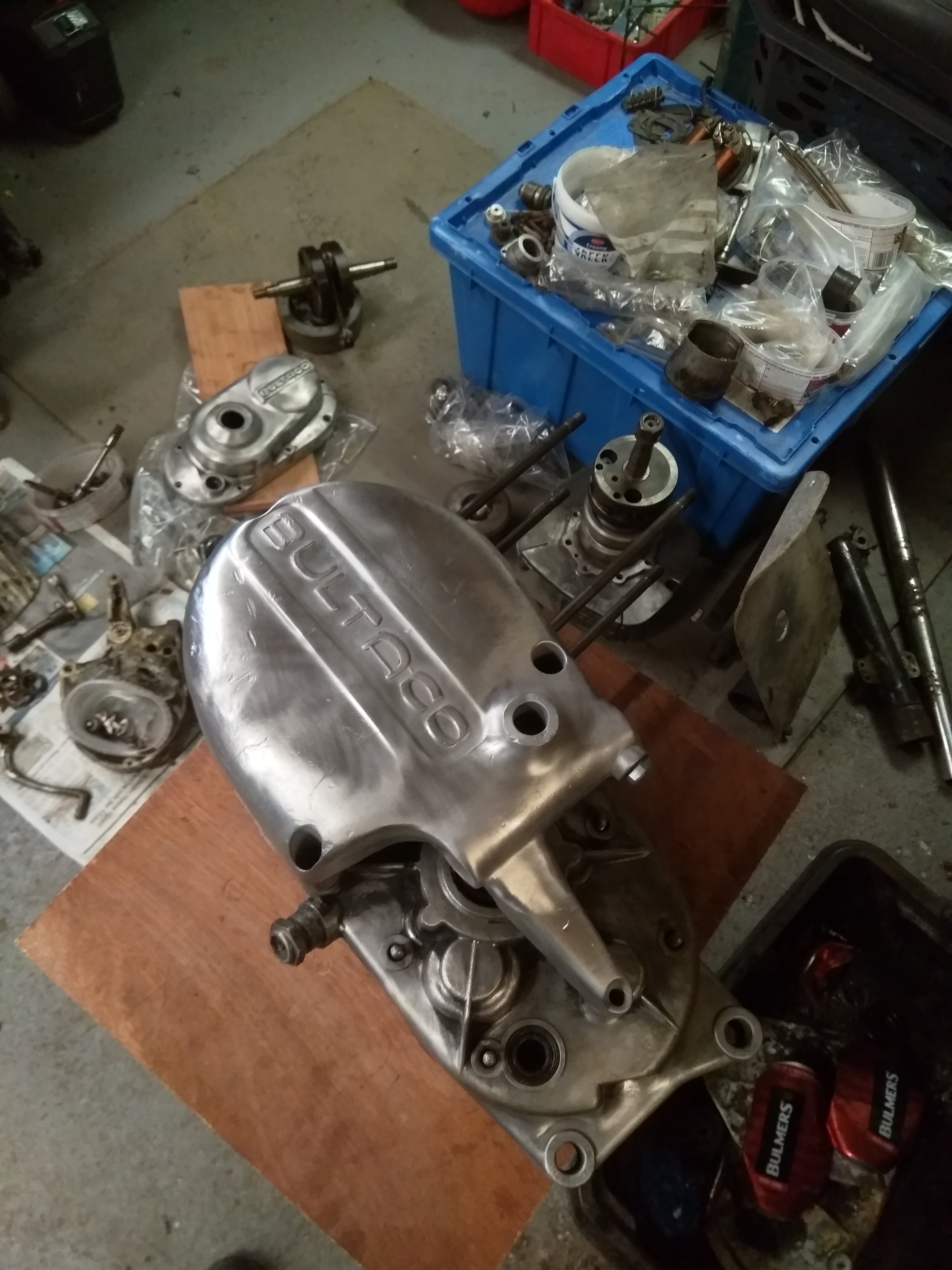

bill black Posted December 13, 2018 Report Share Posted December 13, 2018 Not so much a lump hammer but gentle persuasion alright , I was lucky I think , most of the bike came apart with not too much damage and I can salvage the swingarm bolt and bushes , it's all gone for powder coating and back next week shiny and blue all going well ...... Quote Link to comment Share on other sites More sharing options...
bill black Posted December 13, 2018 Report Share Posted December 13, 2018 1 Quote Link to comment Share on other sites More sharing options...
bill black Posted December 13, 2018 Report Share Posted December 13, 2018 Getting stuck into cleaning it all up ... Quote Link to comment Share on other sites More sharing options...
