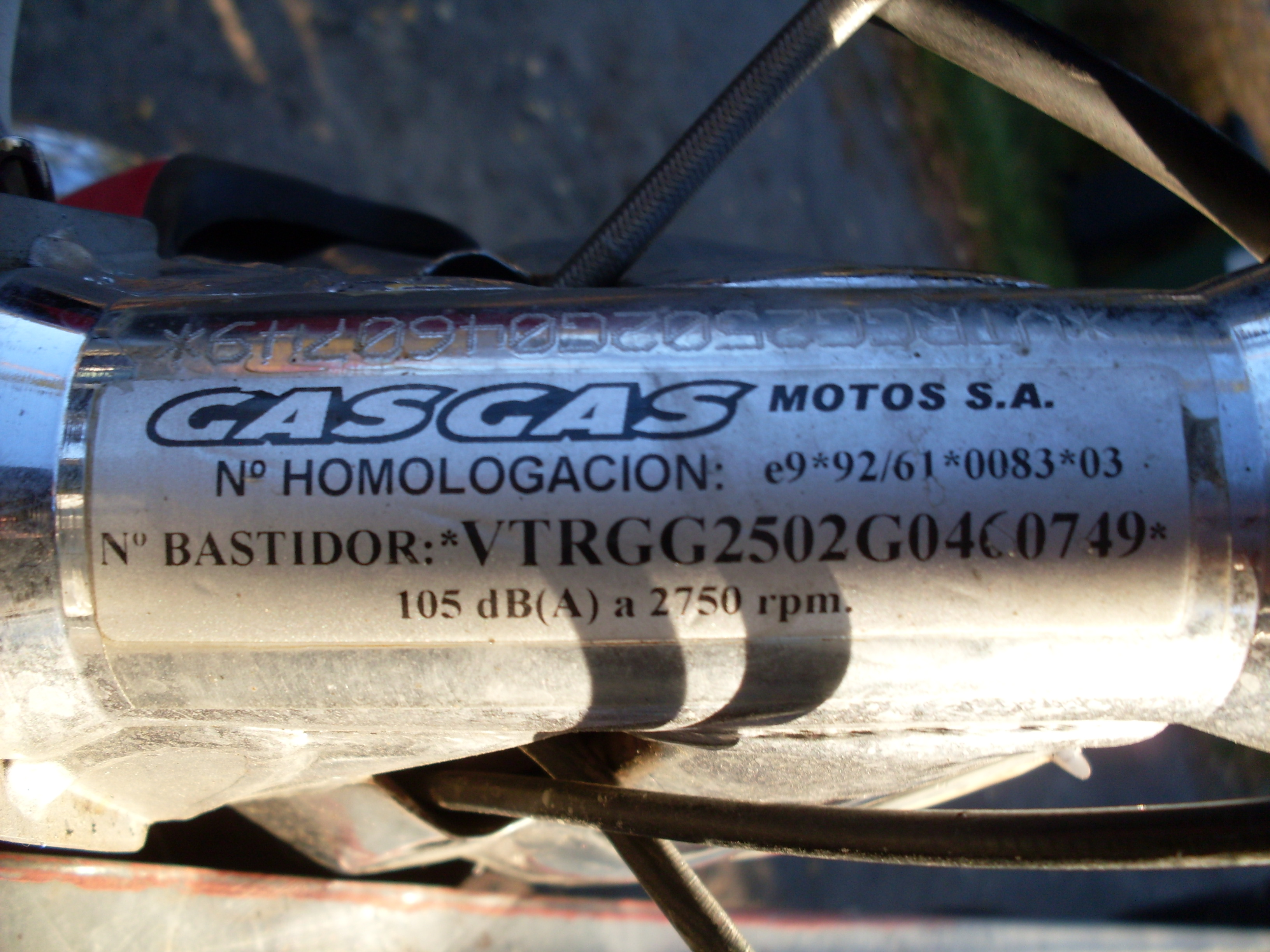

24.09.18. Rammenummer på 2006 GasGas TXT 250 Pro jeg kjøpte i dag. Pic 5.JPG
24.09.18. Rammenummer på 2006 GasGas TXT 250 Pro jeg kjøpte i dag. Pic 6.JPG

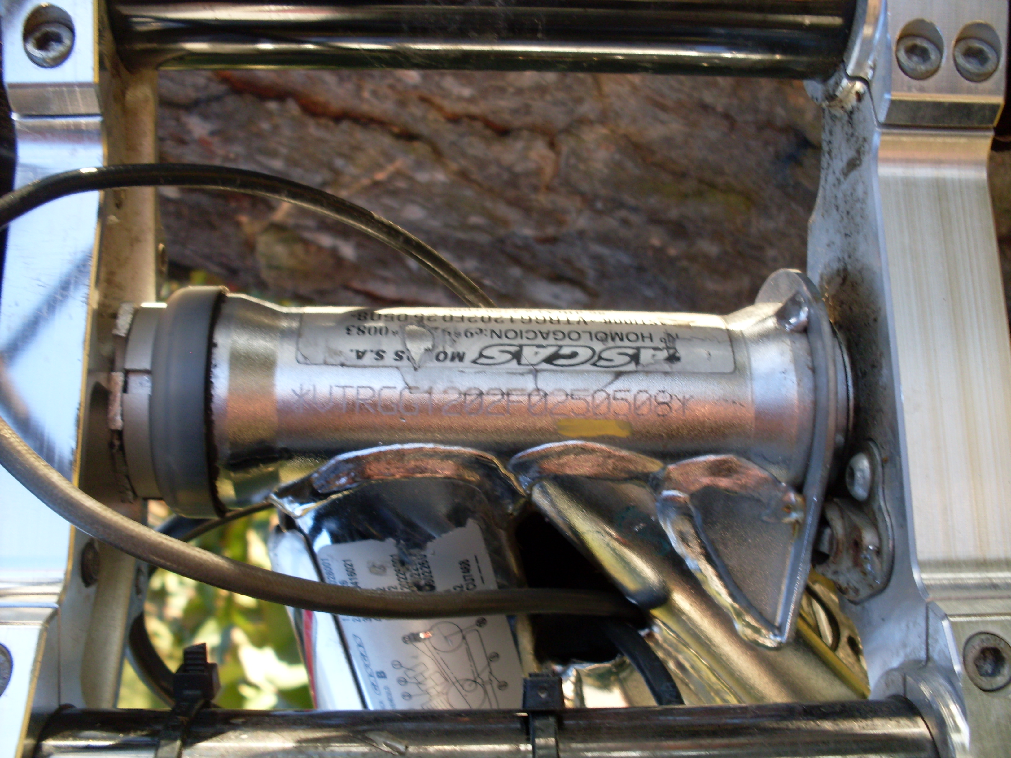

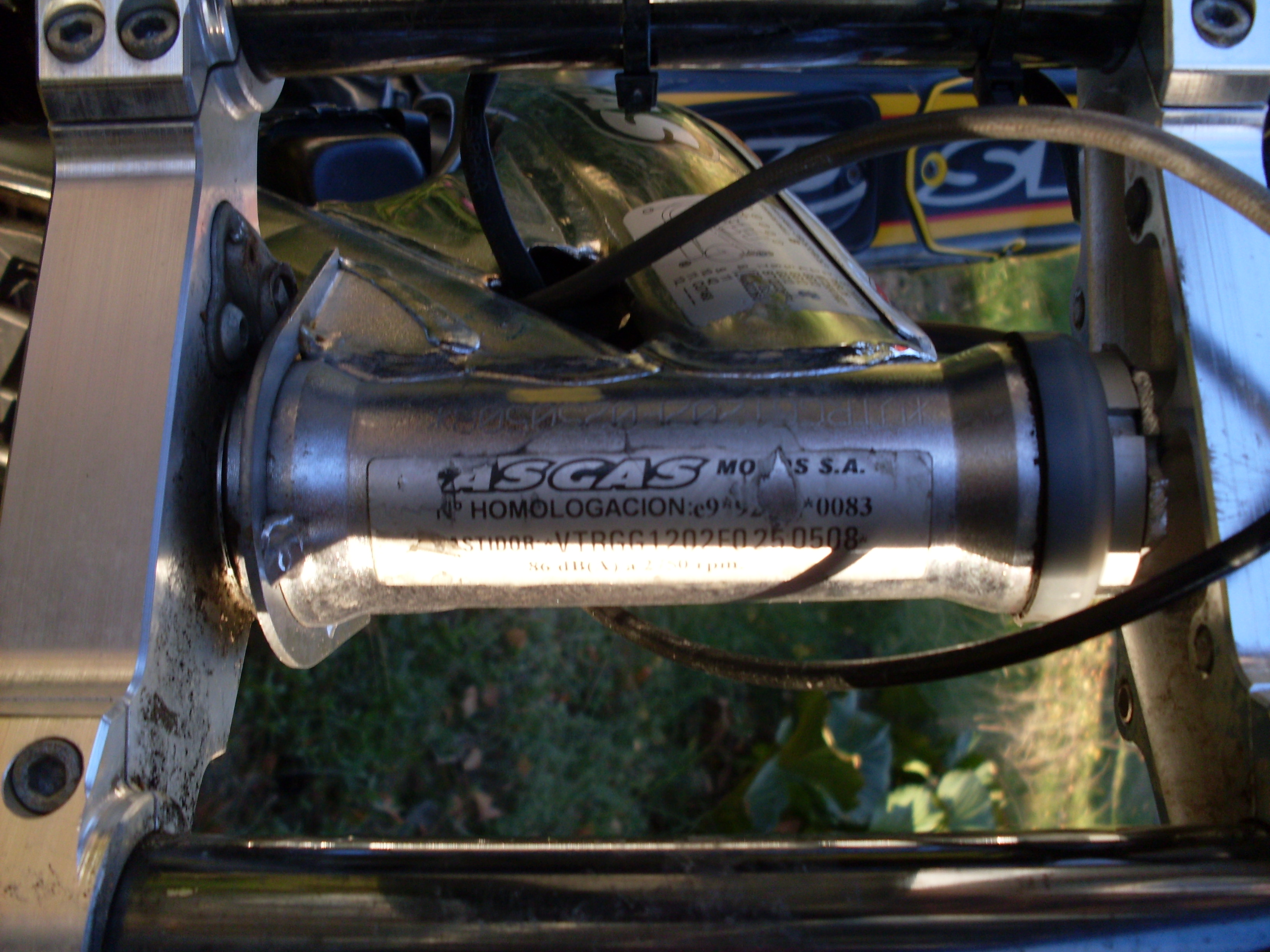

24.09.18. Rammenummer som synes bra på GasGas TXT 125 Pro jeg har kjøpt i dag. Pic 9.JPG

The chassie number on the 2006 Gas Gas TXT 250 Pro is: *VTRGG2502G04 6 0749* and i let the digit 6 have space before and after since that is the model year.
The chassie number on the 2006 Gas Gas TXT 125 Pro is: *VTRGG1202F02 5 0508* and i let the digit 5 have space before and after since that is the model year.

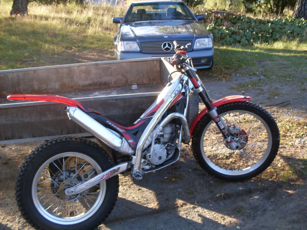

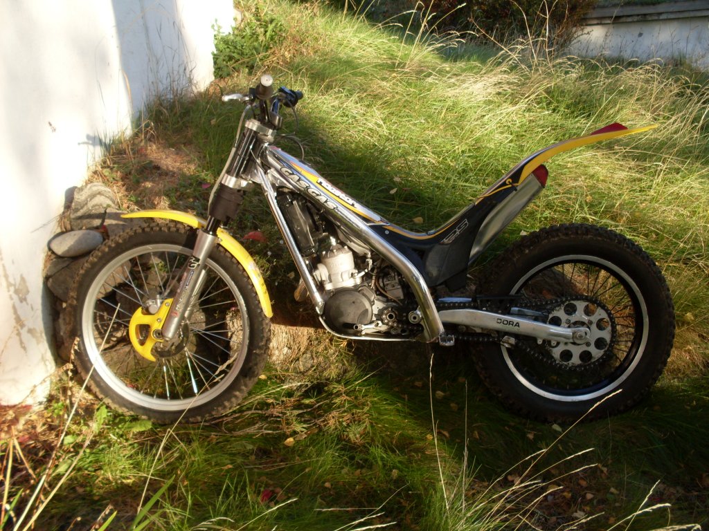

Here is a picture of both the red 2006 Gas Gas TXT 250 Pro and the yellow 2005 Gas Gas TXt 125 Pro
On the decals on the red TXT 250 Pro it says TXT Pro 06 and on the yellow TXT125 Pro the decals says Pro 05

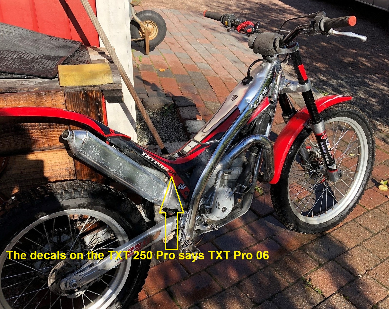

The first picture is of the red TXT 250 Pro and look the yellow arrow pointing to the to decals saying: TXT Pro 06
The second picture is of he yellow TXT 125 Pro and look at the red arrow pointing to the decals saying: Pro 05
I would think that indicates that the TXT 250 Pros is a 2006 and that the TXT 125 Pro is a 2005 model
